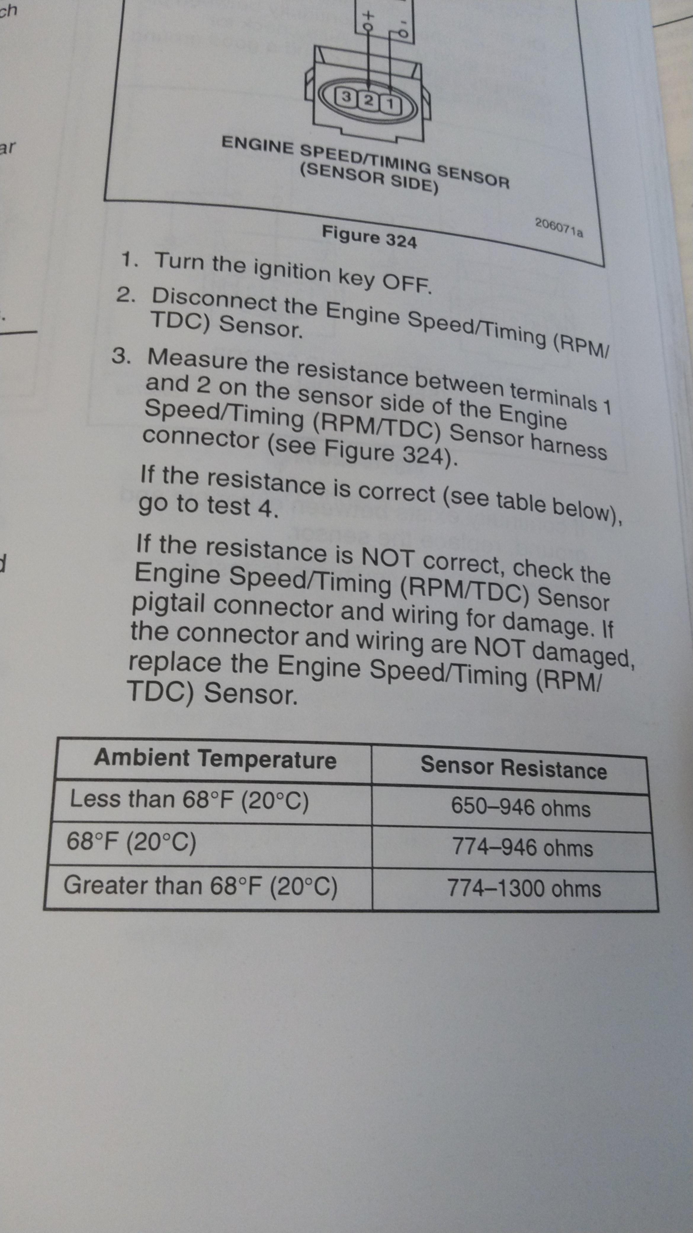

Just for kick's....  look at the cam sensor plug and socket (eng. position sensor) Do the same for the crank sensor (R.P.M./ T.D.C. sensor)  look for fraying of the wires where it goes into the plug. The R.P.M. sensor may have a 3 pin plug with only 2 wires.. you can also, un-plug one of them and try to start the engine, it will crank for a few seconds before starting, and will run rough when it starts.  then plug it back in and un-plug the other sensor, and crank it up.  if it does not start, the sensor that Is plugged in is bad.  These engines can run on either one but uses both to balance it out.. Just one of my "off the wall" test's.. Let us know how it goes... jojo

Sorry about those numbers I gave you, I was in the book the other day for some sensor ohm readings and for some reason that number kept coming to mind. Not sure why….Anyway let us know what you find out and we can go from there. Hopefully it’s just a bad sensor. 🤞🏻
