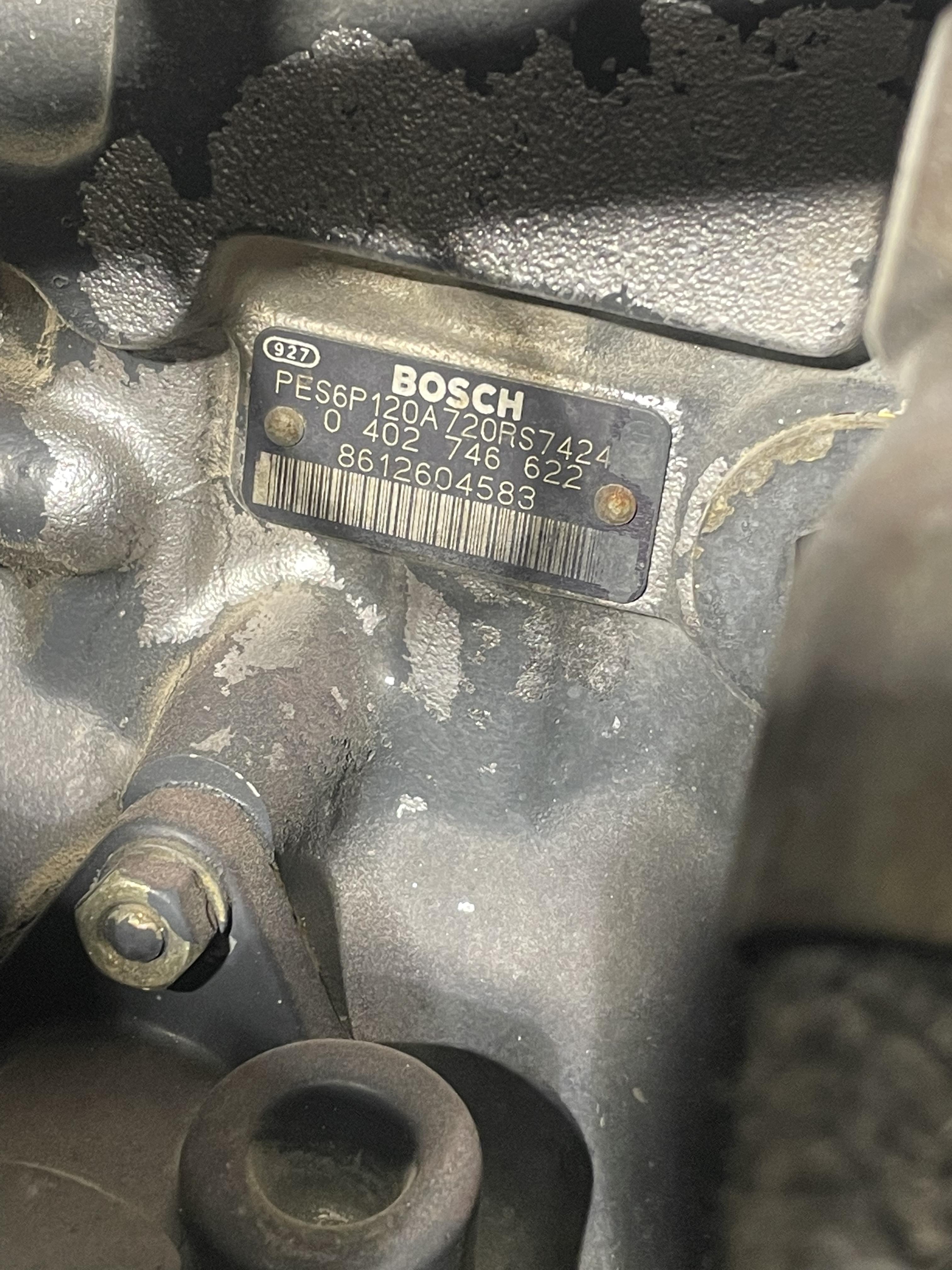

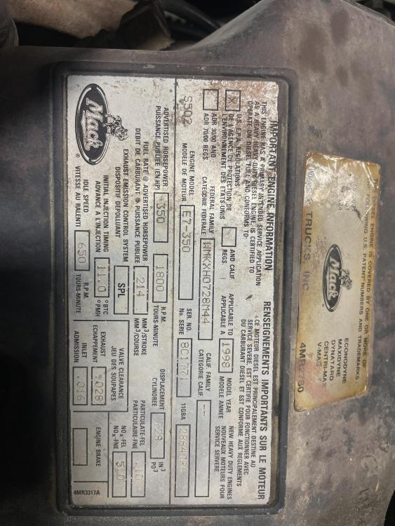

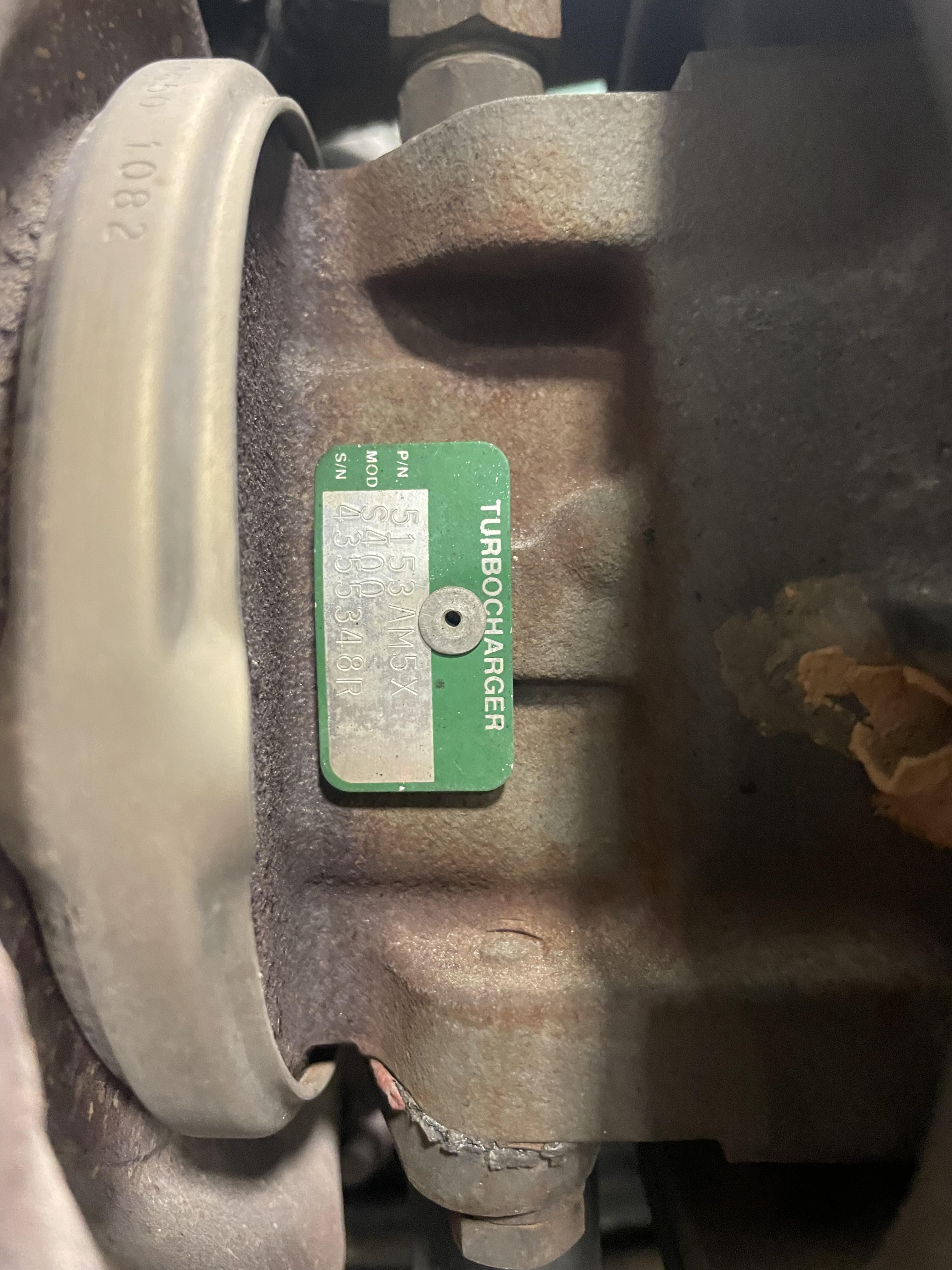

Got a new to me 98’ 688s with an e7 350. I noticed a slight turbo lag when I test drove it but once I finally hauled a load the lag was worse. It seems to take a few seconds to get under the turbo before it picks up. No smoke at all. I actually choked the motor out twice down shifting going up a hill.  The shift was made in plenty of time but the turbo delayed so long the motor kept going down. The second time I tried to drop 2 gears but it still didn’t pick up in time. If I keep the motor wound up it does decent. I own several trucks and drove them all, even a Mack 96’ 613 with an e7 427 and it doesn’t fall on its face like that at all. So, I was thinking maybe not getting enough fuel but I was also wanting to make sure it has the correct turbo on it. Does anyone know what turbo should be on this motor? I was thinking tomorrow I will also try to check the fuel pressure. Does anyone know what it should be?

You can call Mack and give them the last six and they should be able to tell you what came on the truck. Also You can tap into it there. One of the other guys might have a better spot. red is correct on the turbo, most guys put that on and pair it with a set of bigger injectors.

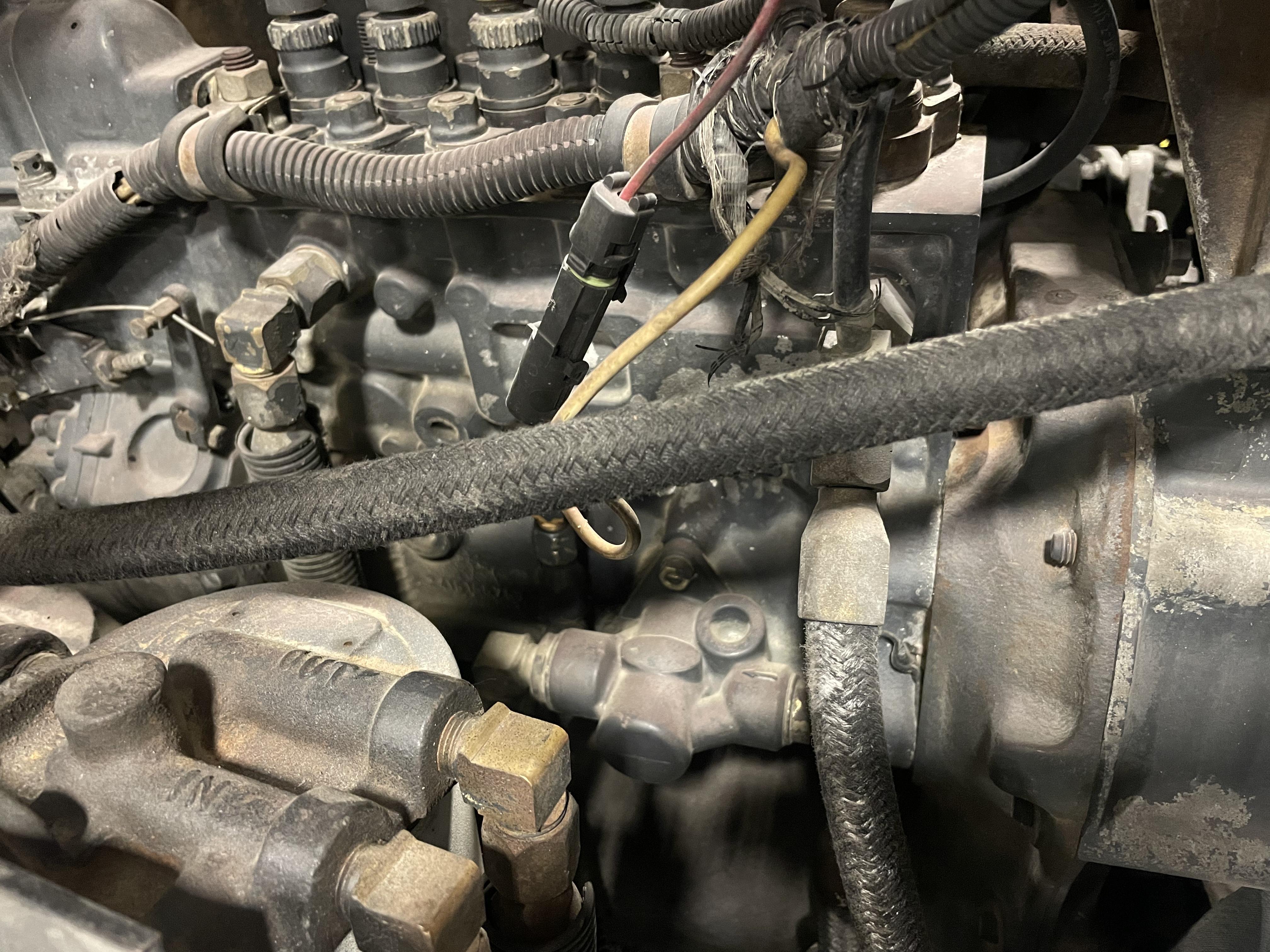

Oh shoot. I just noticed the stop lever on one of the other pics.
That engine is an E7 mechanical. Fuel pressure should be 23-39 psi.

Ok, thanks. Is the mechanical a good thing or bad? Trying to get teed into fuel system now but gotta go pick up a fitting. I talked to a guy at Rochester diesel earlier and he said that if someone put that s400 on without upgrading the injectors that it would be sick. I told him I was gonna check fuel pressure first and if it was ok I would call him back and order a set of injectors.

That is a very reliable engine. Don't expect the truck to be a rocket, but it is very good.
