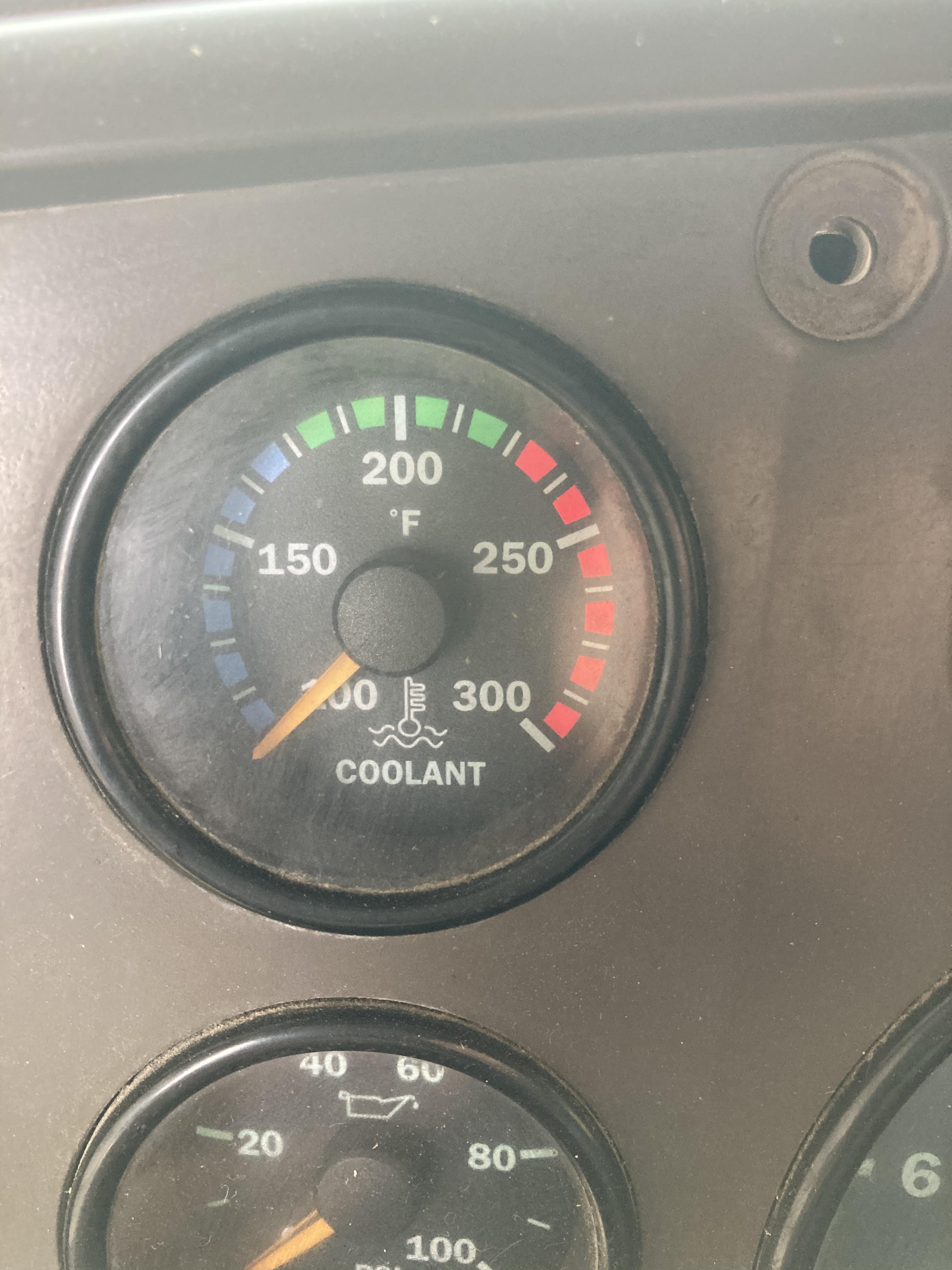

In general, if a cooling system is in good operating order(clean radiator, clean fins, good fan clutch etc), what kind of temperature differential should i be seeing from inlet to outlet with coolant around 200 (mid green area on my truck).
Should t/d be higher if coolant is hotter(say 215)?

if youre truck is 06 and older (Gray Motor) the small green zone on the gauge is 180-185.. and I think you are looking for 30+ degrees difference between inlet and out let temps on the radiator, going in should be 180ish, 150ish coming out..  jojo

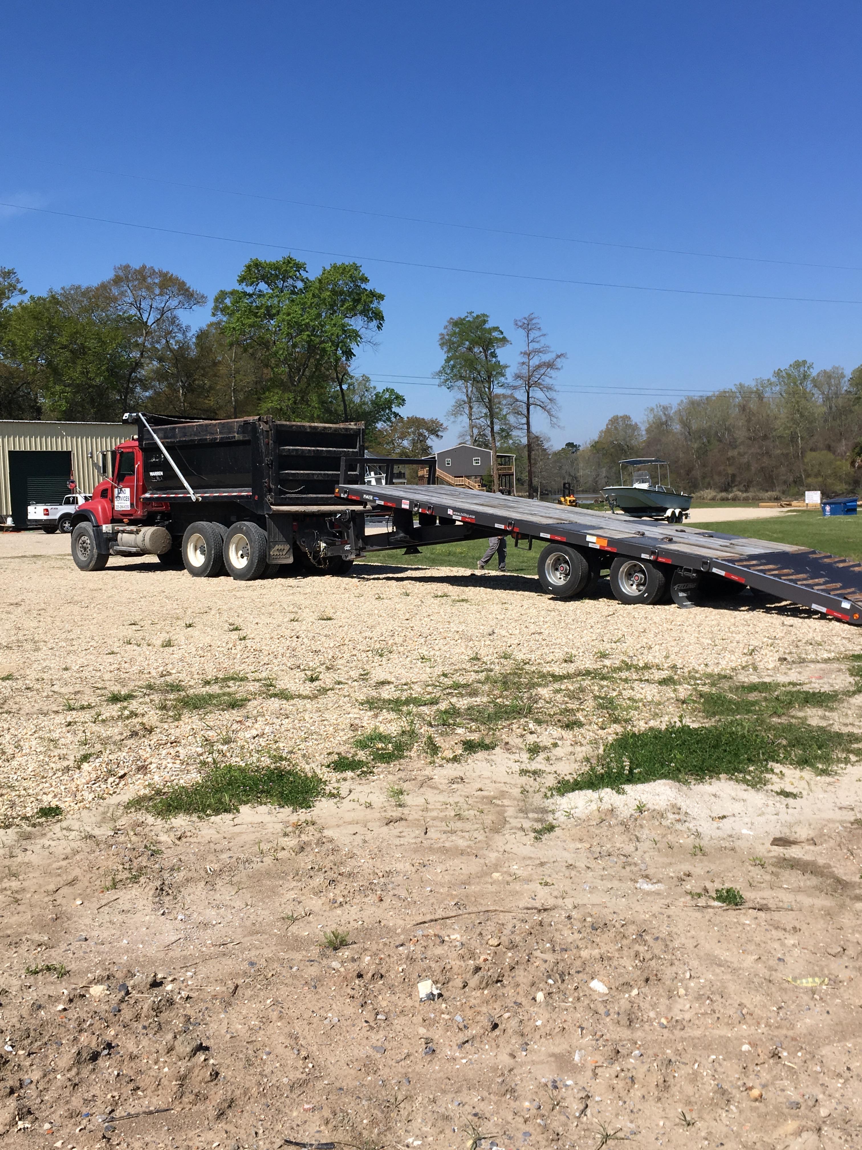

This is in a 2004 granite dump that tags a excavator (83000 gross when tagging) my gauge shows 200 as middle of green area, when in stop and go traffic in hot weather, she gets to 220ish(edge of red), but getting worse recently (red and alarm). Yesterday when troubleshooting, loaded around 50k, did two back to back acceleration runs and immediately stopped and checked d/t, only 10-12 degree differential between metal line going into radiator and bottom metal section going back to engine. One mechanic said need to be seeing 20+ d/t, but I thought i read 10 somewhere.

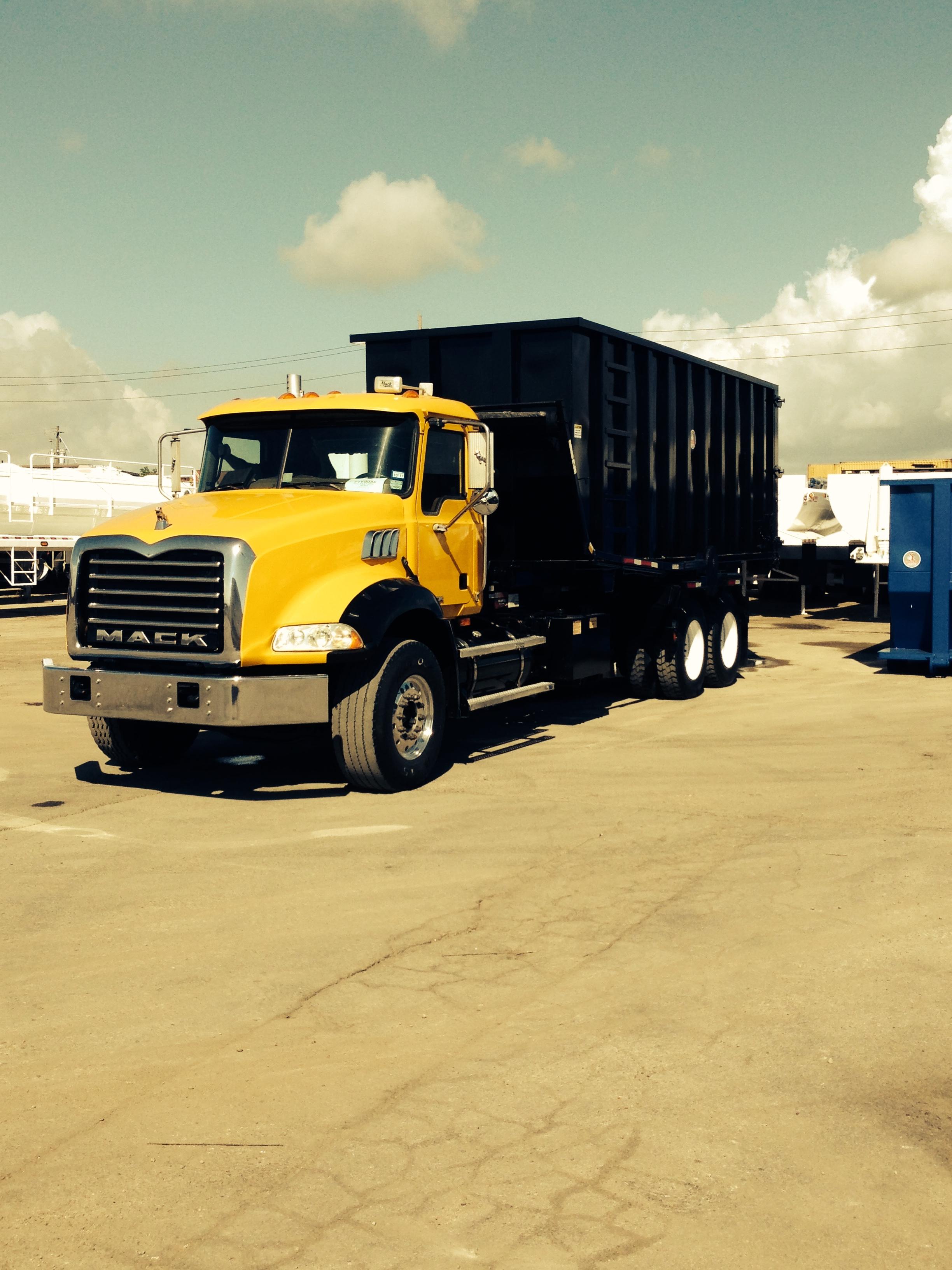

by the pic.  you are in FL.. anyway   keep it simple..  that truck is one of the last .... damn good Mack's... in my opinion.... Jojo
