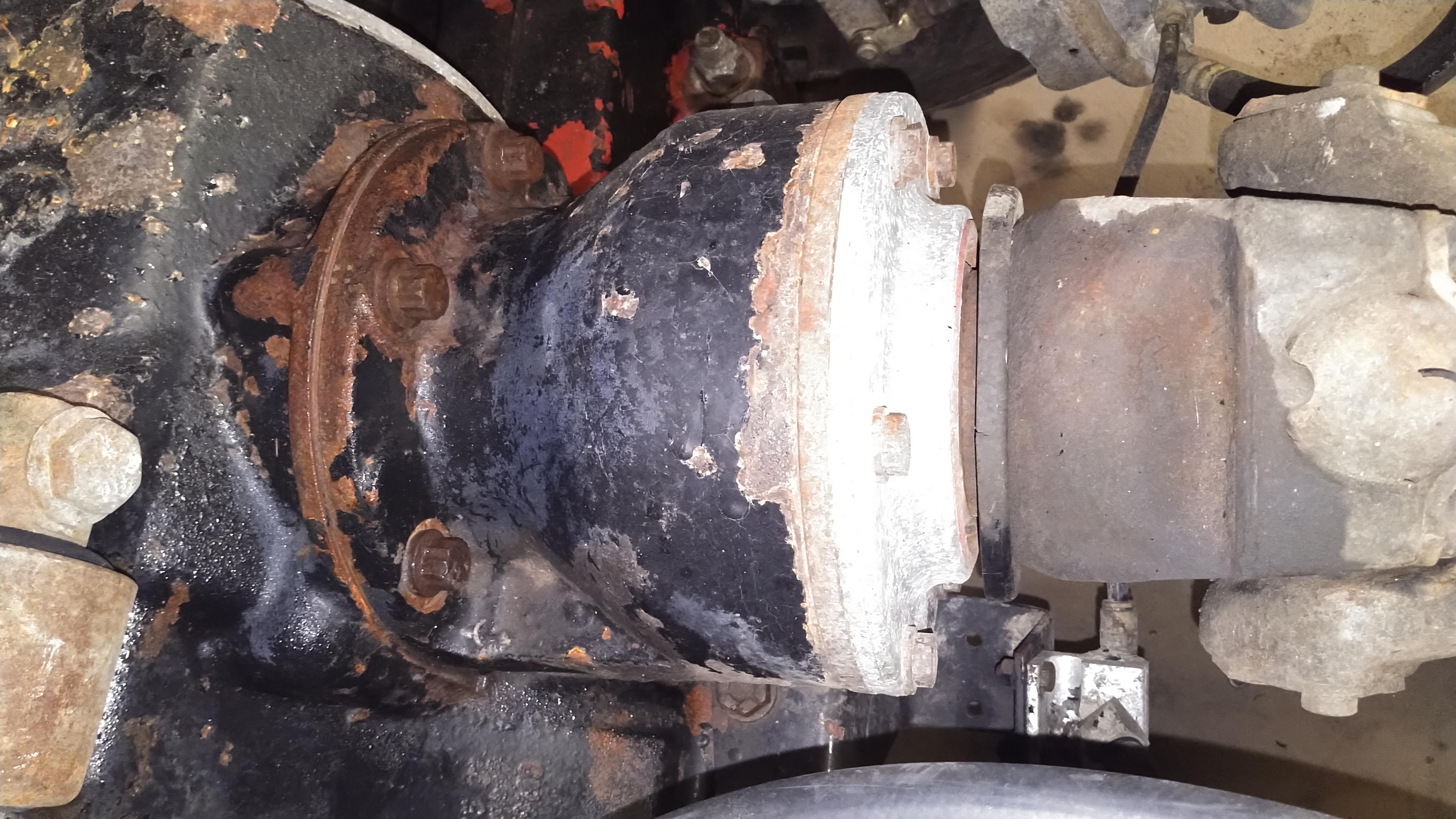

My understanding is no Mack bogie drive is fully open in the power divider area
The air operated type of doohickie you mention is to lock the power divider for slippery conditions
And yes 65 MPH with out knowing the details of the Allison is probably pretty close
Paul

The main question I had on peanuts is whether "full open" was an option, I have to test it again but I think I got it stuck in the yard with only one wheel spinning. I'd love to have full lockers, but people dont spec them enough for there to be any in used parts yards.

You know, now that I think about it, I THINK I jacked up one wheel on a tandem Mack once, put it in gear, and that one tire spun free without trying to move.  That truck did NOT have the air locker.  So...maybe?  Maybe there were full open models?  But, I cannot answer that part of the question with 100% confidence.  Interesting question, though.
