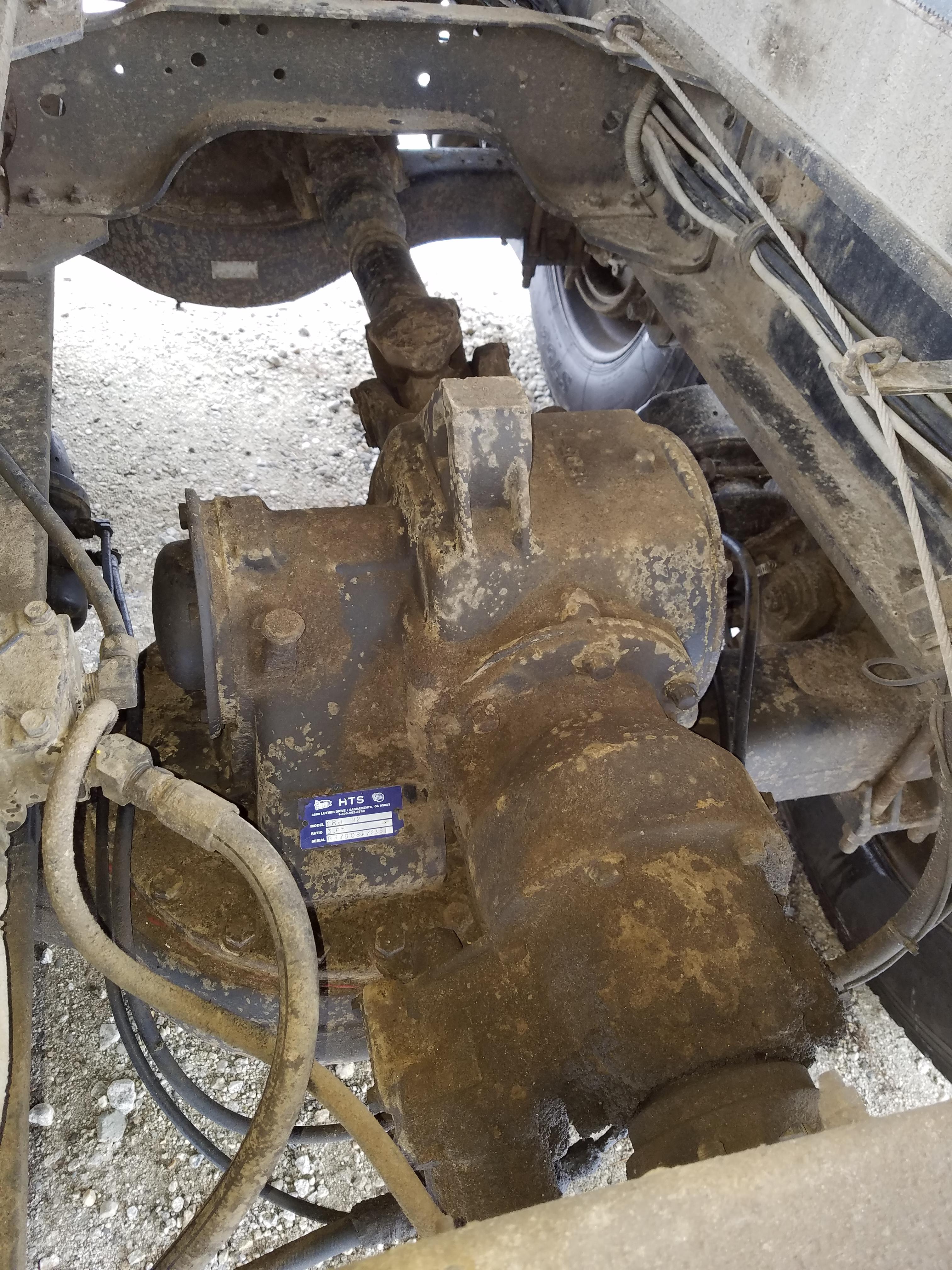

I started getting a noise out of the front differential.  I was told it was rebuilt not too long before I bought the truck.  I talked to the guy that owned it before me and he said there were two reservoirs above the check bolt on the sump(?)that I should have been checking. I  put around 20,000 miles on it in the last year and checked at the sump a couple times.  The oil level was where it should be.

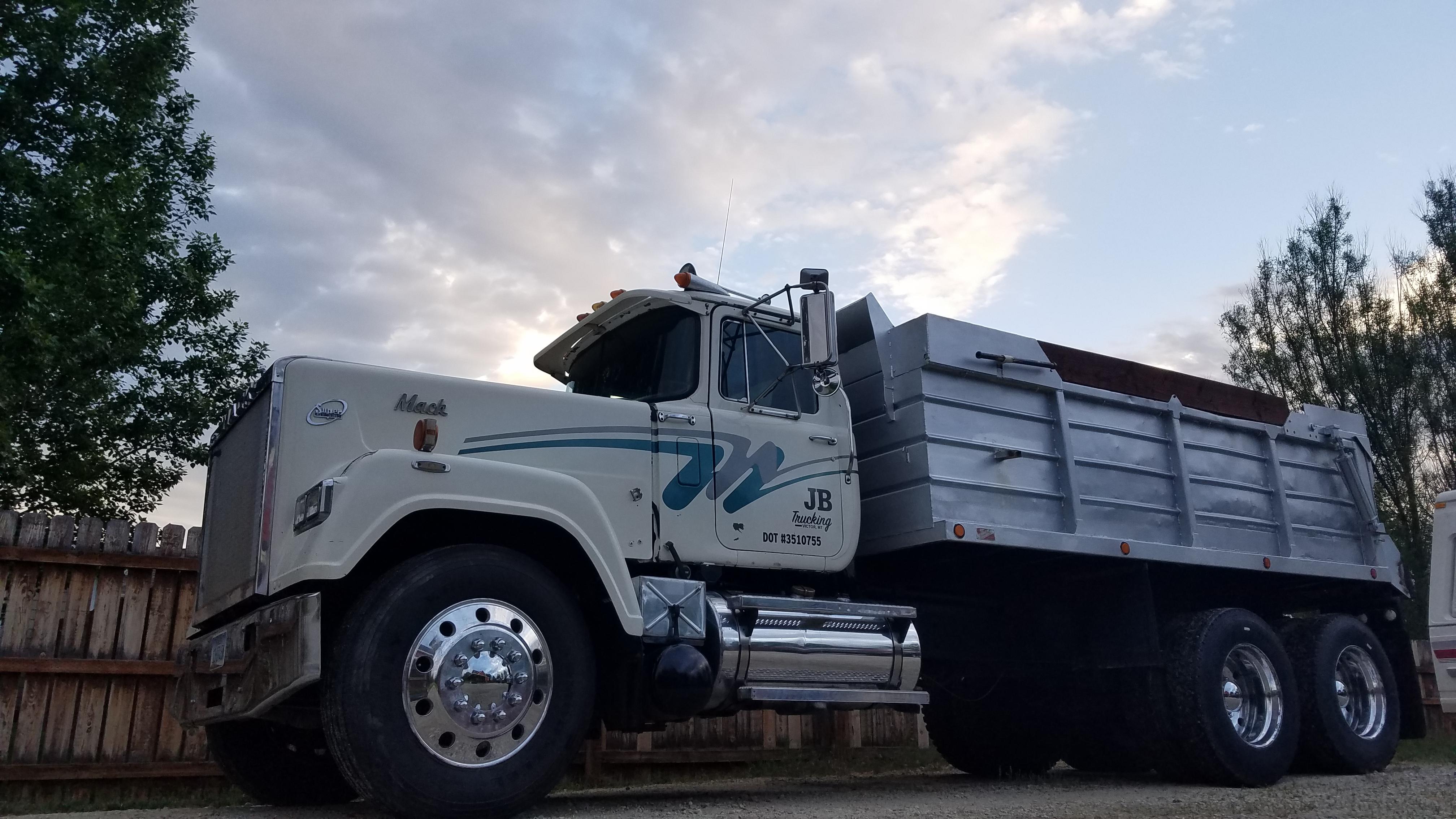

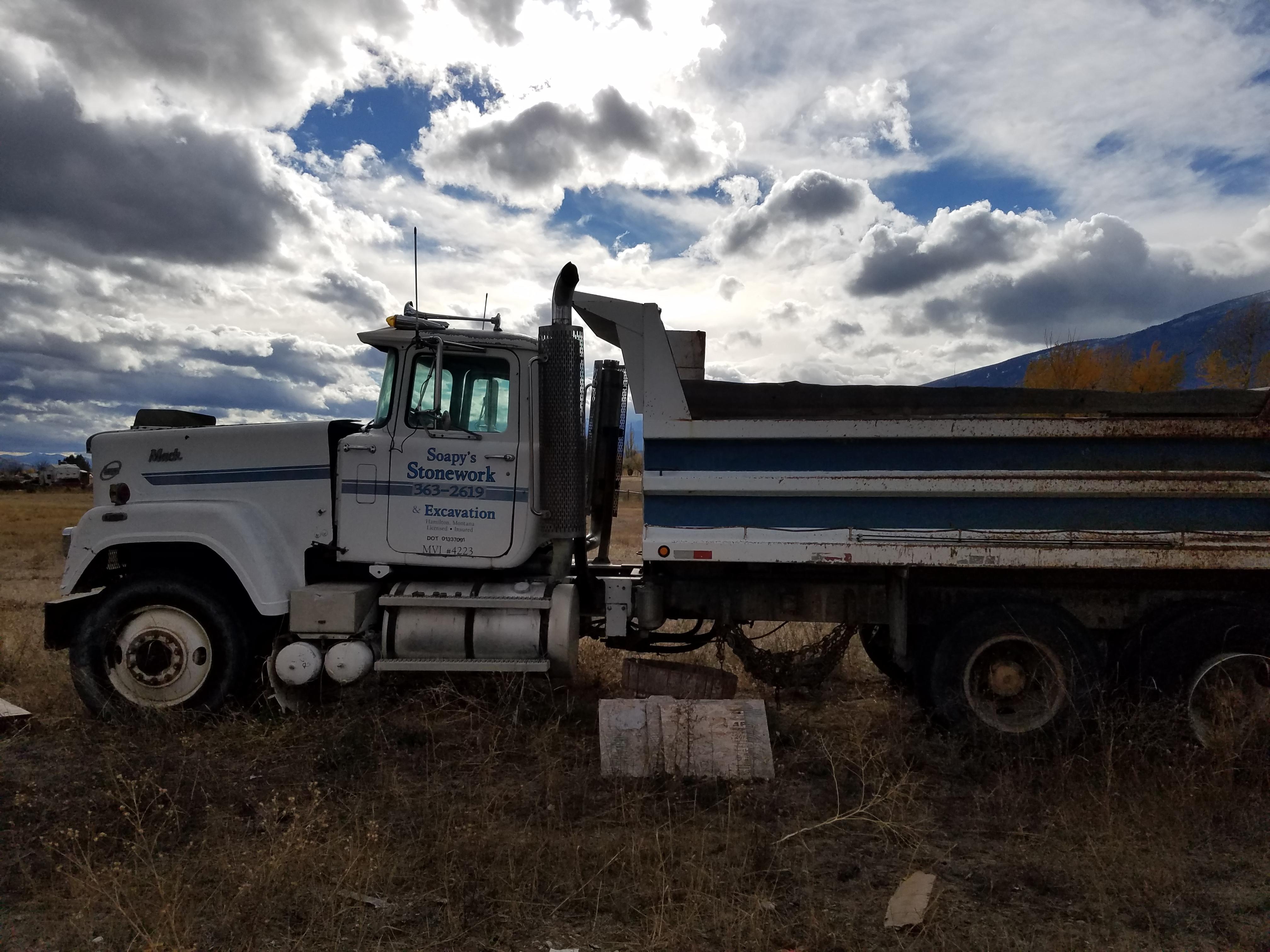

Thank you.  It's a 1987 RW613 with a E9 400 and a Mack 12 speed transmission.  I bought it last winter and started running it full time in June.  It would bury the speedometer, when it was working lol. It could pull a little harder but has enough get up to keep me smiling.  I'm sure there's a lot I could go over on the engine to improve it but right now I'm just trying to keep it earning.  I  found what I think is a 1984 RWL722 sitting in a field. Same motor.  They parked it because of a broken frame.20211028_151508.thumb.jpg.957730b0065b3a3e8737755e89dfc674.jpgIt came with the factory dual stacks and I'm in the process of putting the driver side one on my 87.

As with all things mechanical, parts can fail.  If you have a noise coming from the rear you could have a bearing failing. We had one go about 10 years ago.  Ate a few teeth off the ring gear so we dropped a pair of differentials that gave us about 10mph more speed. (Previous top speed was 48mph floored. You could slide into first gear from a stop with no clutch.)

I have seen noise caused by mismatched tires on a mack rears.I always said dont let the tires be more than a 3/4 inche tall from smallest to largest and the peanuts will last for ever.This noise in most cases will be found as a knock at slow speeds.
Also if you have clunks and you have steel bud wheels pull those wheels and look for broken rims!
