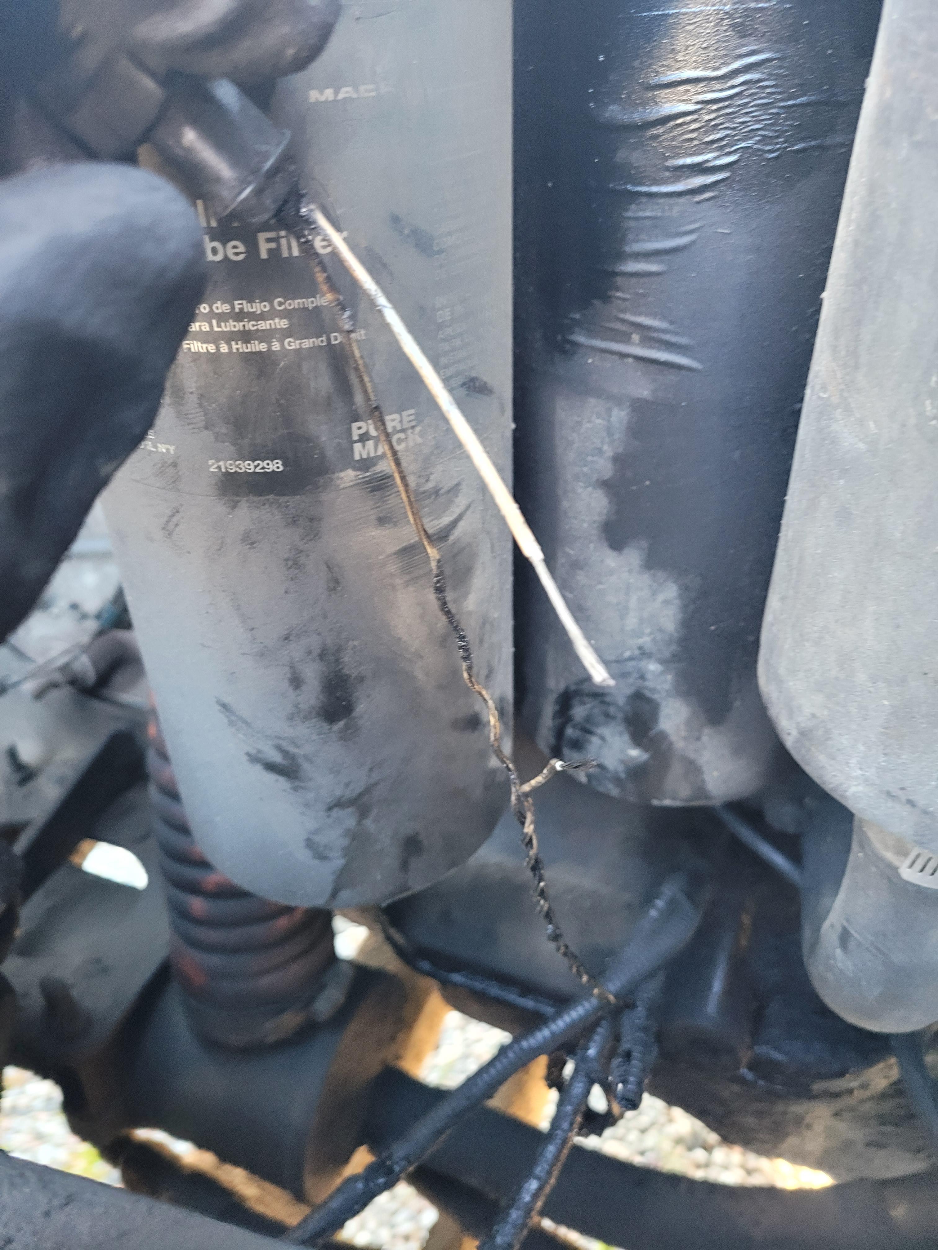

I had a ring gear slip on a 2000 CL713. I removed both cam and crank sensor and rotated the engine until the missing tooth lined up with the hole on the flywheel housing. Used a mirror to locate the cam and the 2 holes that are drilled in the cam gear. Timing was not set. I am not sure if its even possible on a RD or RB because of the rad being so close. hopefully its a broken wire. There is a clamp that secures the engine RPM sensor wiring above the starter. The wiring may have rubbed through there. Great info here fellas.
