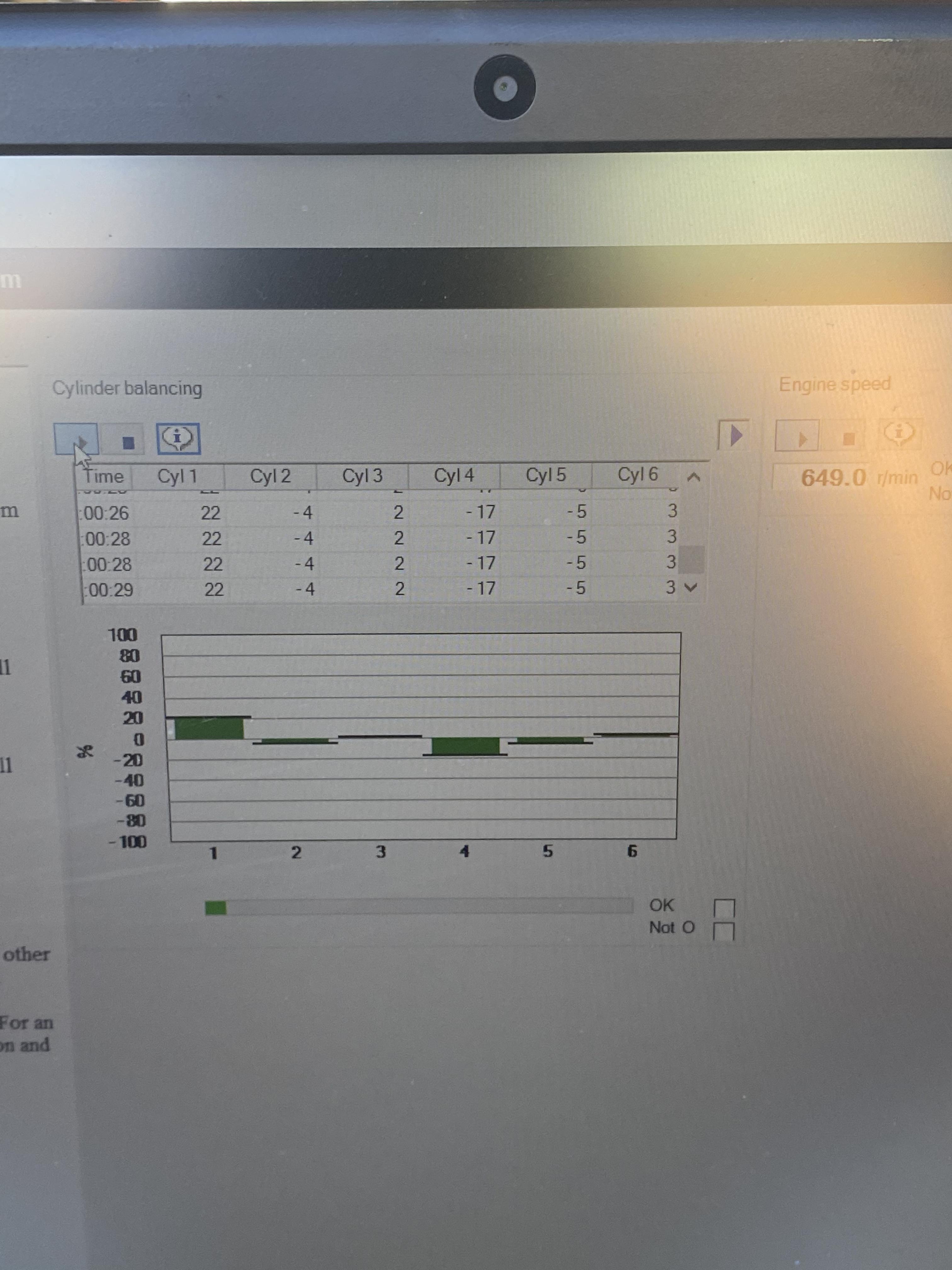

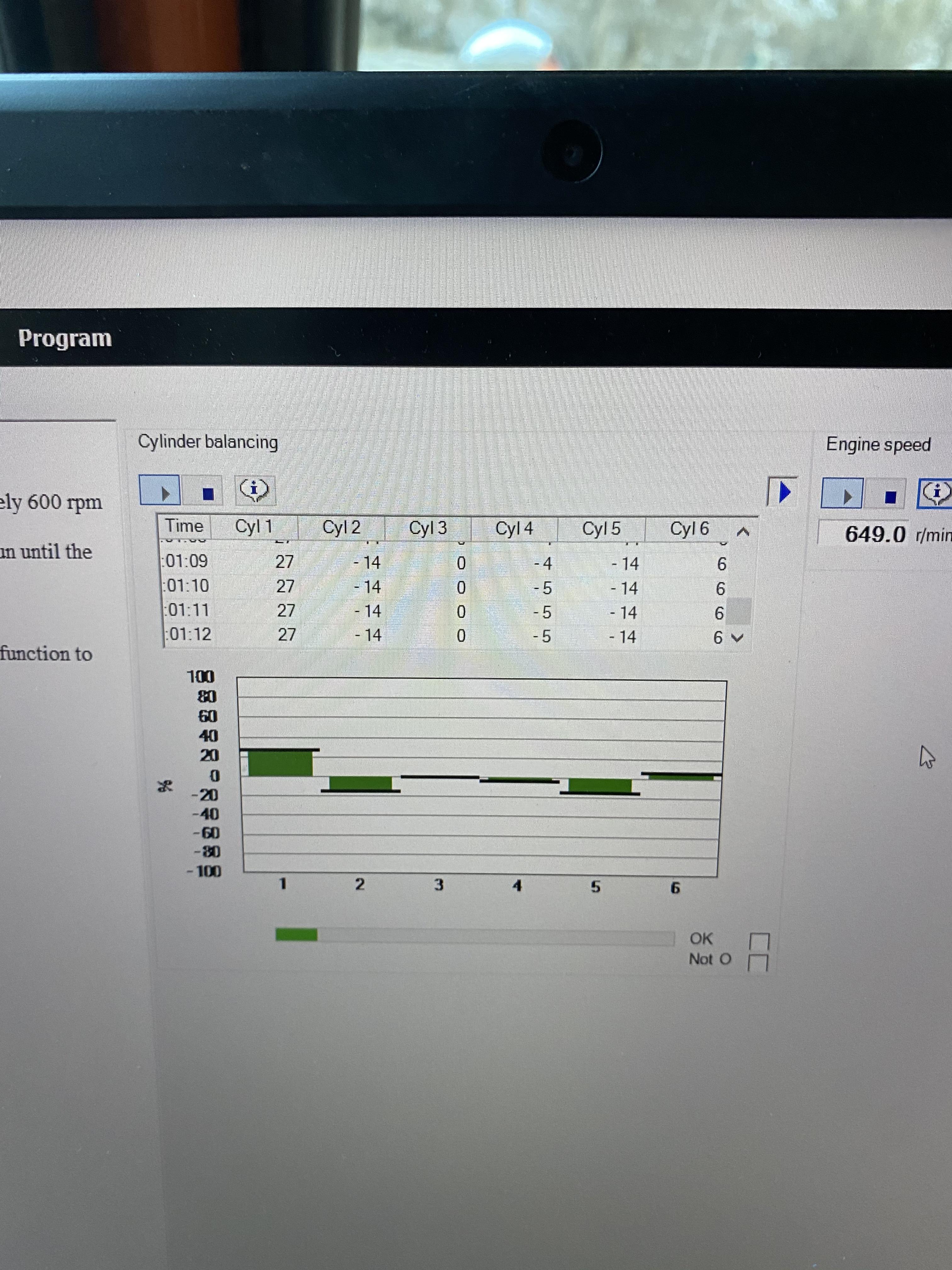

I wouldn’t consider it hard starts just no power I uploaded some pics of the injector rates from earlier today the truck is deleted when I first bought it it ran great the first few days auctually a little better then my isx 565 but shortly after it started running really sluggish in the mornings after a couple loads it would start to run better through out the day but still not what it should have been I know I’m not getting straight to the point just trying to give more details what I have been going through since I have owned it sometimes the trucks runs good builds boost through a few gears then it just falls on its face

that screen looks like Premium Tech Tool...   there are calibration tasks in the program, I dont know about deletes, but do you still have a DEF system? or is this an '09 before DEF?  to calibrate the VGT. you have to remove the accuator and run a calibration then install it to the turbo... (B.S.)  there is also a gauge to check/set the 1/4 gear into position..  jojo
