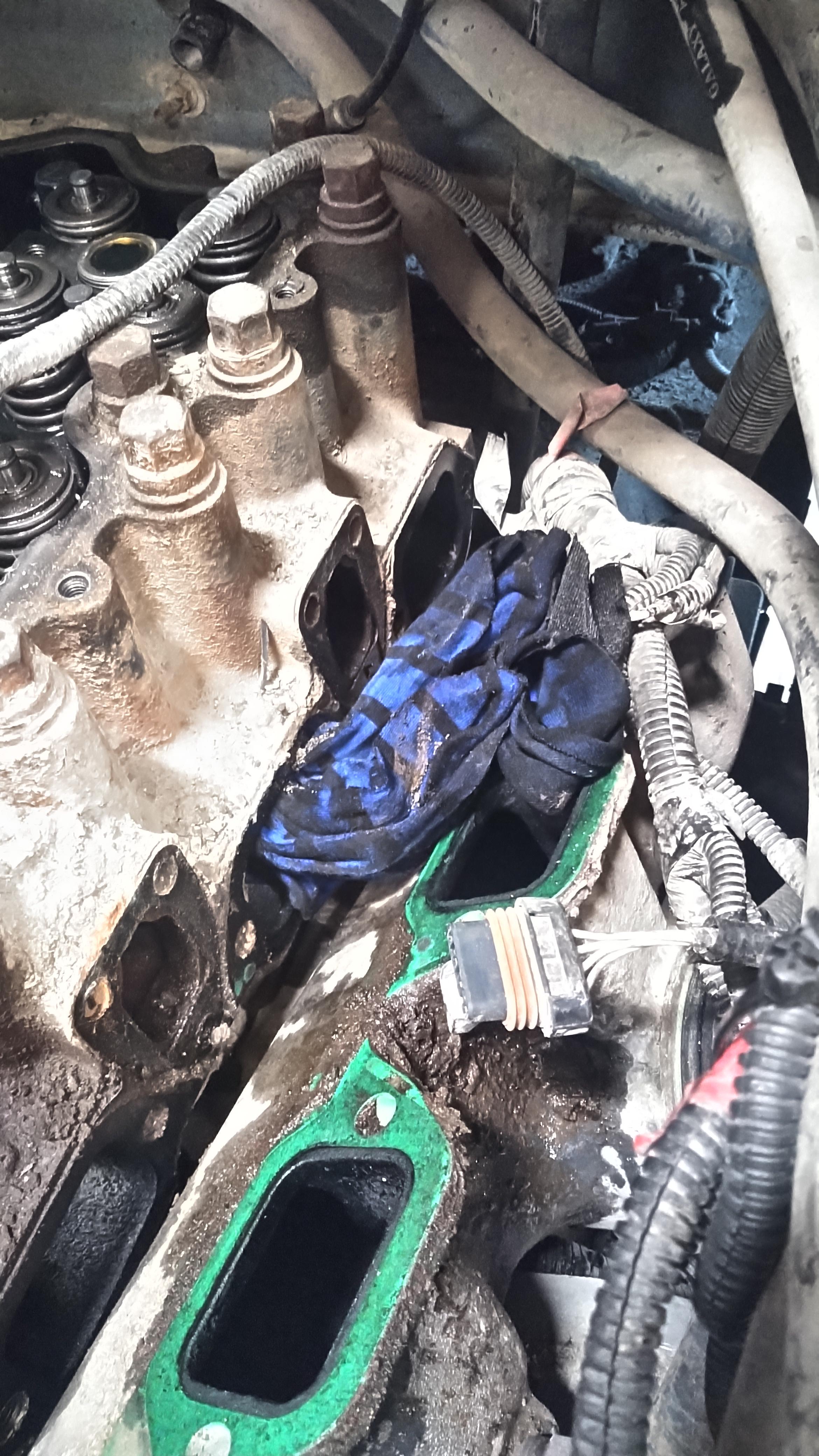

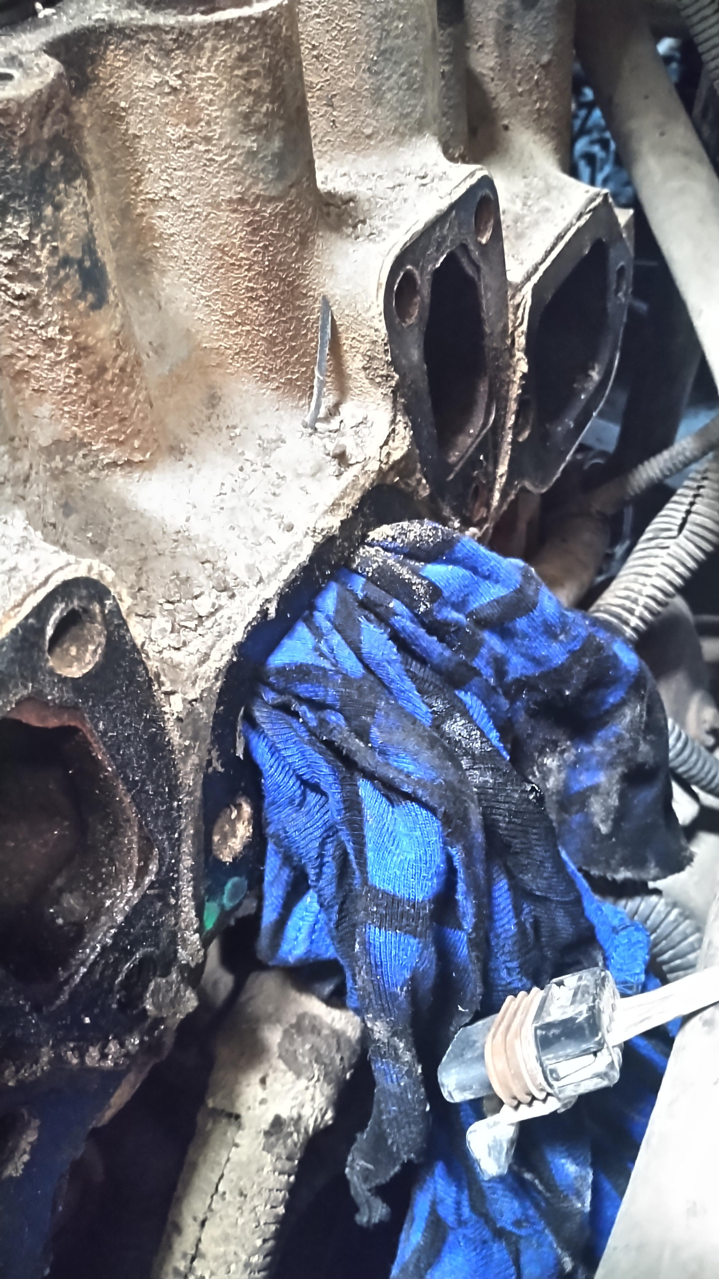

I chased an issue for weeks on an 05' Mack...  It started up but #5 was not doing good.. the owner told me to put all new EUP's and injectors and fuel lines..  Still ran bad and smoked us out..  Well after a bunch of cussing, I decided to pull the heads to have a look..  and here is what I found... of course I started on the exhaust side first..  jojo
