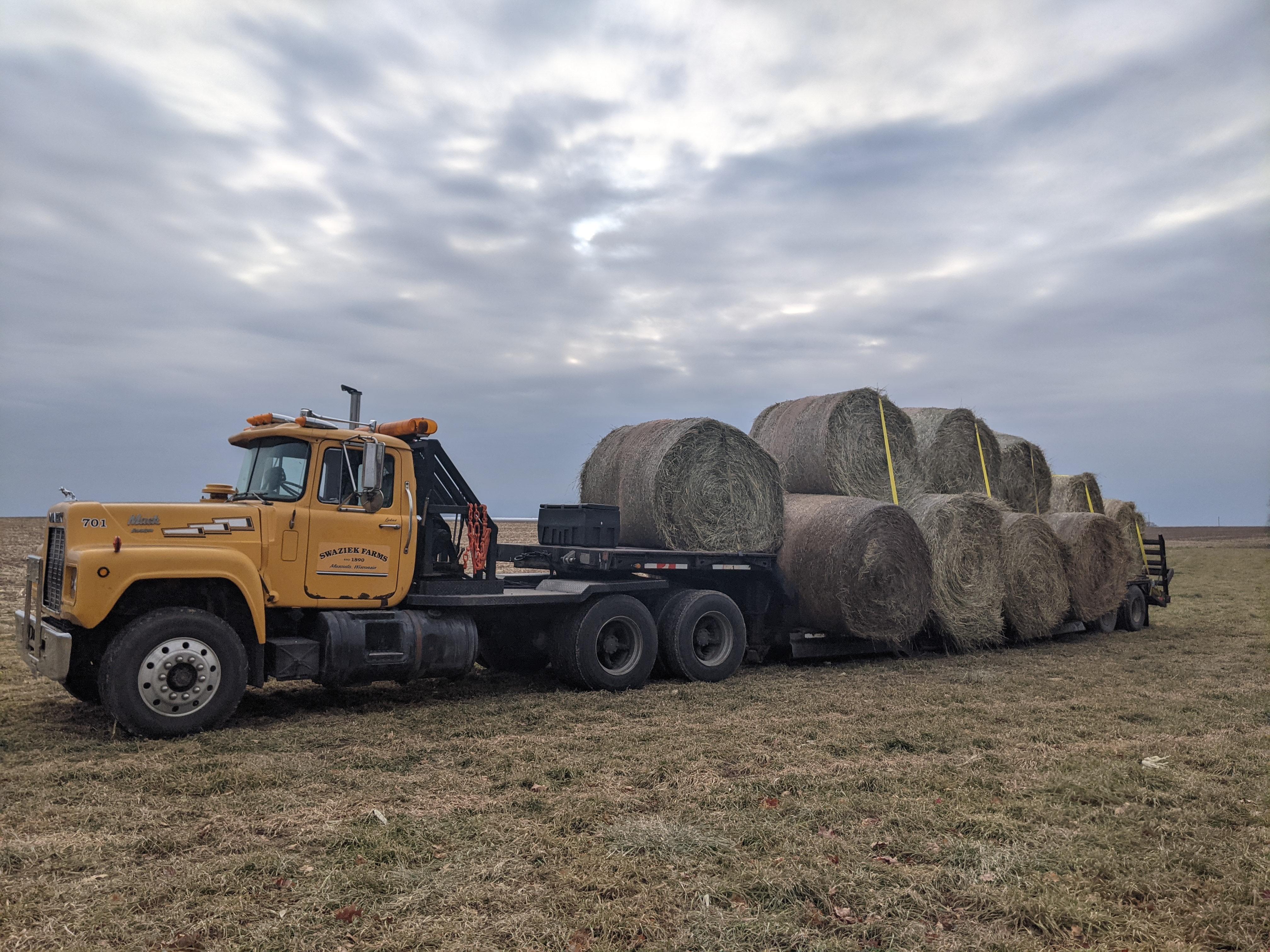

So I have an issue that's been going on as long as I've owned this truck, it's a e6 350 with a maxitorque 9 speed. Between 1200 and 1600 rpm I hear a distinct clatter but only under light load and the truck has to be in gear and rolling. When I rev it up in place at that RPM range It won't make the noise at all, and when I'm pulling a heavy load and get into it, it goes away also. Sounds a little too loud to be an injector knock. Oil pressure is around 30 at idle, 60psi at 1600, 90 at 2100 and oil is clean. Just put a headgaskets in it and cylinder walls look great, all still have crosshatching and no scoring. This noise almost sounds like it's coming from the rear of the engine or more like the bellhousing/clutch. Sounds like it's right under the cab when I'm driving. I'm not sure where to start.
