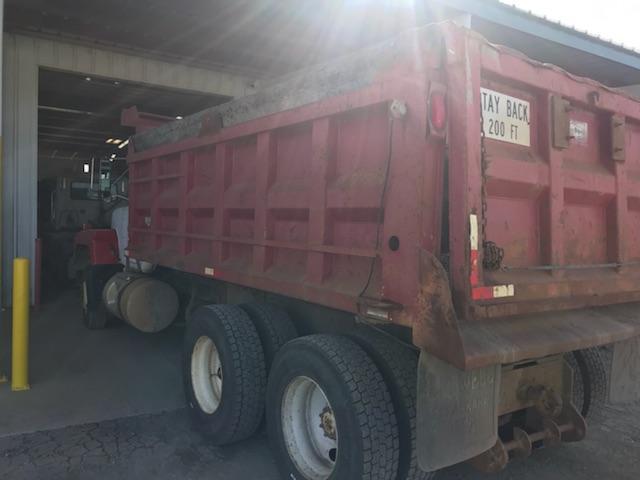

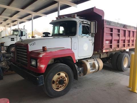

This truck is being advertised for sale on Facebook so I have no idea how to put the listing on here. Truck has decent dump bed, tri  axle with a e7300, Eaton 8ll transmission and Mack rears. Has 560,000 miles and he is asking 26,500.00. I’m thinking 24,000.00 cash if truck checks out. Does this seem like a fair price for this truck? Try and upload photos tomorrow where service is better

now I looked at the 2000 Rd688 today and it wasn’t a bad truck. New tires all the way around. Had two wheel seals leaking. A small leak from a bad oring on front tandem axel. (Thanks JoJo.) The air gate latch cylinder that opens and closes the tailgate latch was missing and there was a hole in the muffler that ran under cab before it went into stack. No leaks in the motor, transmission. No blowby that I could see. You could tell it has been greased and I was told it was a county truck and they were good about maintenance. They wanted 26,500.00 as is. This truck was traded in two days ago and the dealership just hasn’t had time to get it ready for sale. I wanted the two wheel seals, oring replaced on rearend, latch cylinder added and plumbed back in to airlines and muffler fixed. General manager wouldn’t do it and I walked. Salesman called and told me general manager wouldn’t budge and I better think long and hard about letting 1,000.00 in repairs stand in the way of getting truck. So I’m thinking. AC doesn’t work, trunion bushings have to be replaced. What you think?

It worked for me. Looks like a decent truck. Just looking at it quickly it doesn't look to be in as nice cosmetic or maintained shape as the 2000 you looked at earlier but that doesn't necessarily mean this one is a bad egg by any means. Some pics of the frame rails and chassis condition would be a good starting point. The Eaton transmission may be a transplant. An EM7 (Maxidyne) engine would have most likely come with a Maxitorque transmission. The Eatons were usually paired with an E7 350 or E7 400 engine.
