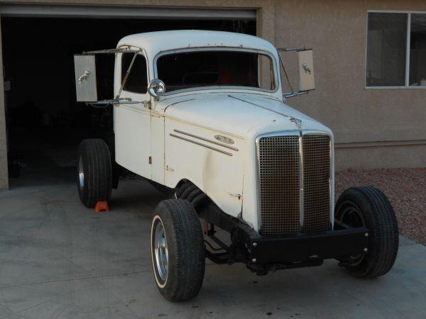

Need some help, guys. Doing a story on a Mack for Diesel World magazine. I'm trying to properly ID the truck and don't find any material on it. The owner only knows what he was told by the PO (the late Lowell Baker, who was a well known expert on the Jimmy 2-Strokes).
I was told it's a "1948 Mack A75". The serial plate calls it a "Model 75" and the serial reads 75S-2XXX (full # not disclosed as I don't have permission from owner to reveal- I may be able to do that later).  In looking here at the A-Series Registry, this truck has a similar look but the model number doesn't match.  The A-Series info I can reference lists models A-20 thru 50. The serial plates in the registry all have the "A"  in the model designation. I was told it was a converted from a fire truck and this may be the part that's throwing me off but I can't find a "Model 75" either. The engine has been swapped out and replace by a 4-71  (what other engine would Lowell put in ( : < ).
I just want to accurately represent the truck as best I can but I am not an expert on Mack and what research I have done so far isn't turning up definitive answers. I have attached a pic of the truck as it exists today.

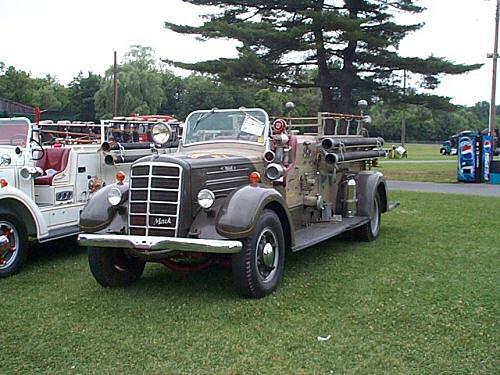

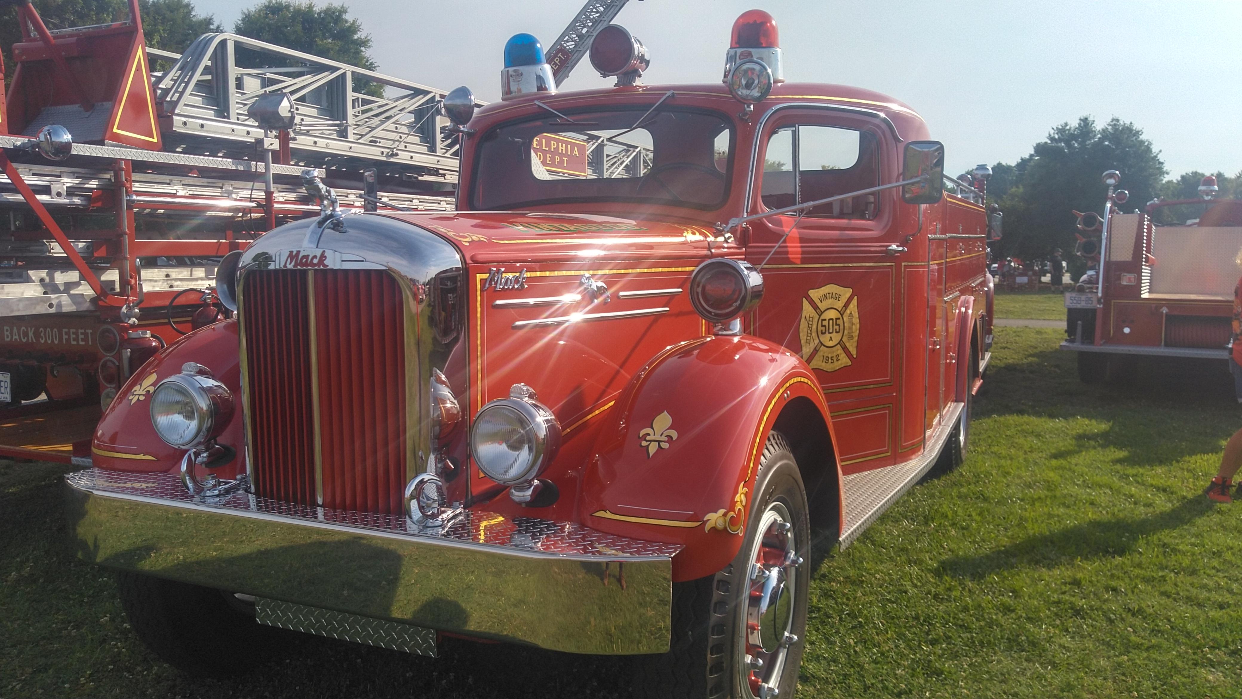

I dont have a lot of knowledge on them. I was just lucky enough to be asked to drive this one, so I read a little bit about it.. It still has the data plate on it, but I dont have a picture...  However..... GADave has a picture of the data plate..  jojo

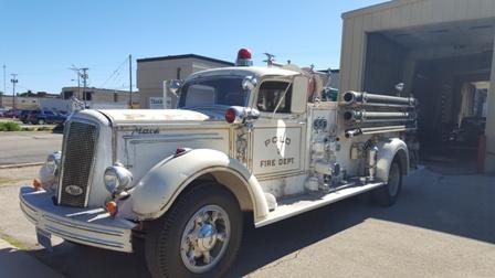

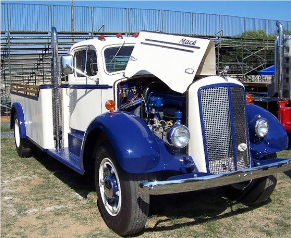

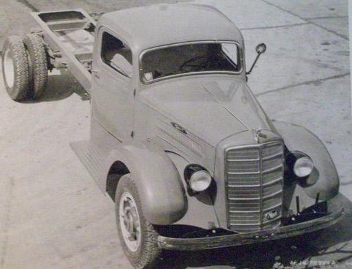

The truck you are looking the info on originally was a Type-75 firetruck which were built in late 30's and through 40's I belive. Could pull more accurate data from a subject-specific book if you need. Basically it was a E-model Mack cab and chassis. I'm not sure on the particular E model (they differed by multiple types regarding to weight ratings) but the most probably it used EH chassis. My guess the reason the model was not a E-something but Type-75 was the trucks were made by Mack as complete firetrucks already. So the model was established basing on the pump capacity as Mack did for firetrucks and not the way commercial chassis were named. Some amounts of those Type-75's were produced during the WW2 and supplied to USAF and also went overseas by Lend-Lease if I'm not wrong.
If you look at the pics below the overall appearance of a EH-model and that Type-75 is about almost the same. But there's one (at least) special part which may point you that a truck was a firetruck when it left the factory - slightly different design of the grill. Commercial trucks had horizontal bars in it and firetrucks had plane net with just a framing around. Seems like many firetrucks were saved but lost their fire bodies at some point.
Vlad

Vlad, isnt the name on the side of the truck i posted, what you are saying about Mack Built firetrucks... It's a 505-A... A 505 pumper on an 'A' model chassis?  (1952)  jojo

I point out once more that the trucks which don't have horizontal bars on the grill were the most probably firetrucks originally. Or just the grill was swapped. But many firetrucks also had special front bumper you can see on some conversions.
My guess is your truth is there.
