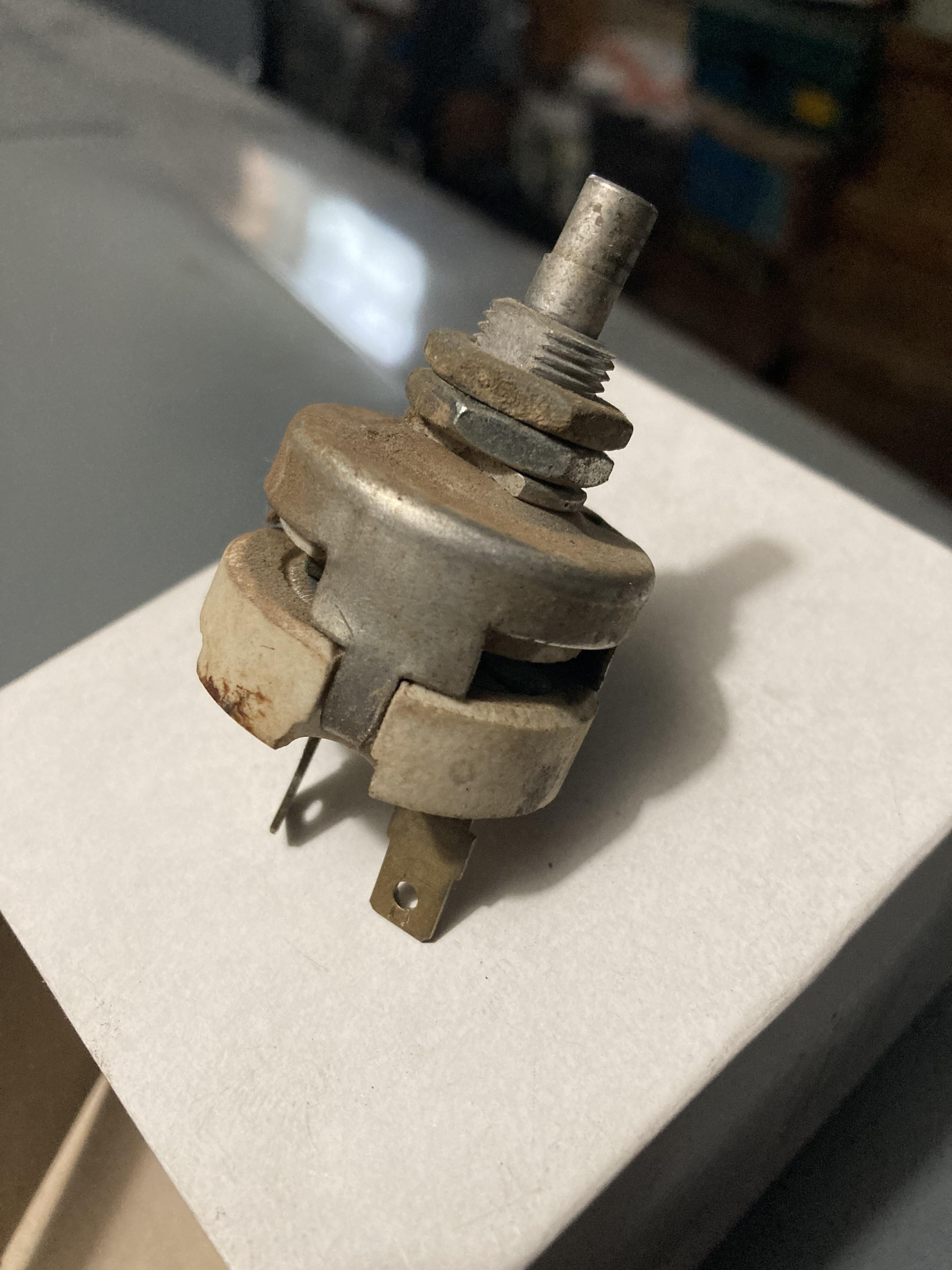

Finally got around to fixing my dash lights. They are all wired through the dimmer rheostat. If your dash lights stop working it’s most likely your dimmer unit. Very easy fix. Below is a picture of the Mack (Volvo) part number you will need.70F44658-72B1-4819-8A46-B6B5DB172069.thumb.jpeg.c20f888239d77aa6a107a55db51e729e.jpeg21F9F753-F9FE-4839-9173-280AC0BAE93E.thumb.jpeg.f3c953d91e20559adada802ebd724cac.jpeg
