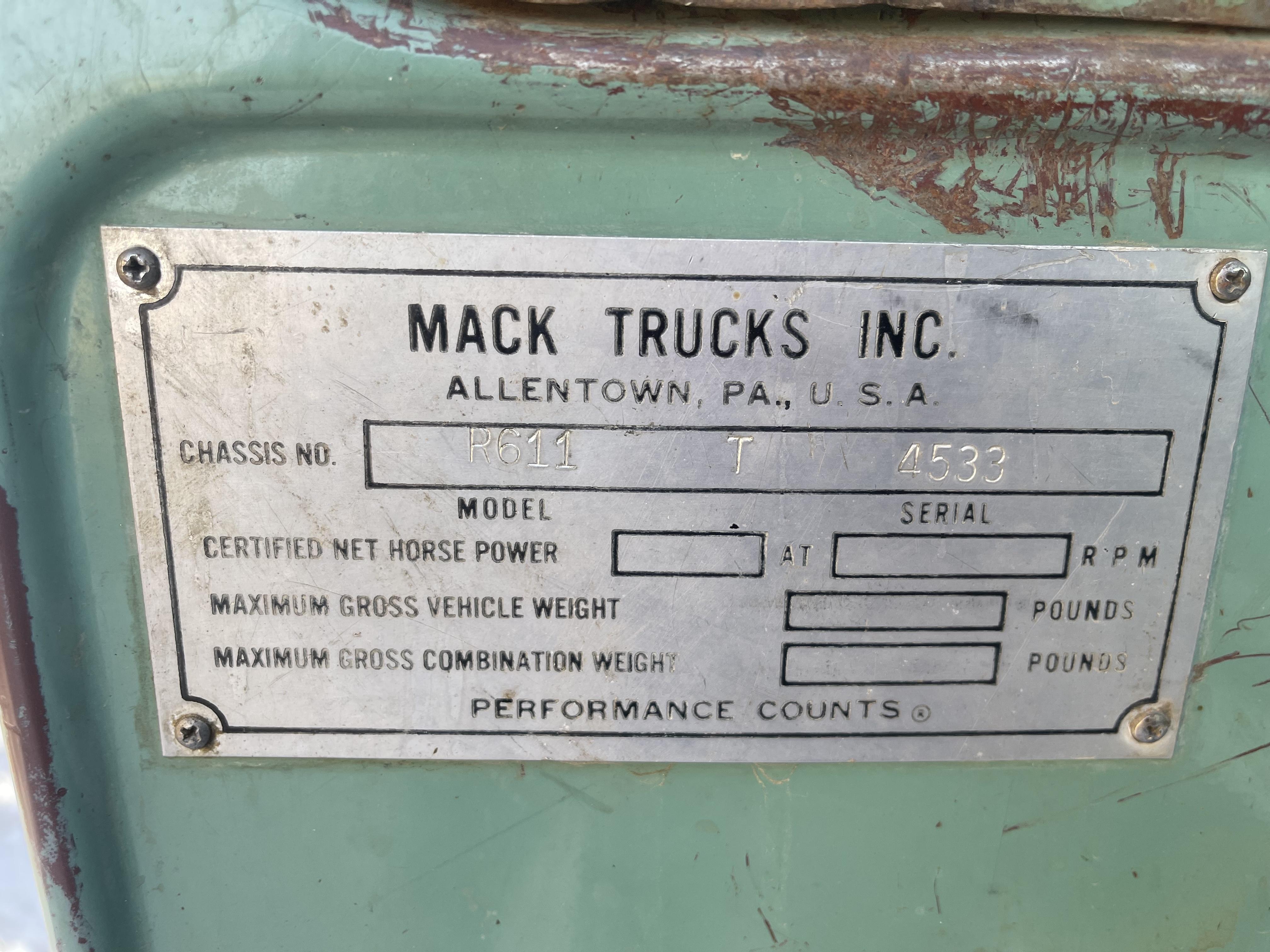

I looked on the frame but it probably wasn’t sufficient enough so I’ll have to check again. As for the door tag this is what it has on it.
https://www.bigmacktrucks.com/topic/69263-vin-question/#findComment-489874
Thats perfect !
your registration and paperwork should say  R611T4533.  Thats all.
R611 I think ?  250 hp mack engine.  Hopefully someone corrects if I'm wrong.
T is for tractor designation
and your truck was the 3533 r611 built .
Hopefully someone smarter than me can fine tune the numbers , lol
Keith

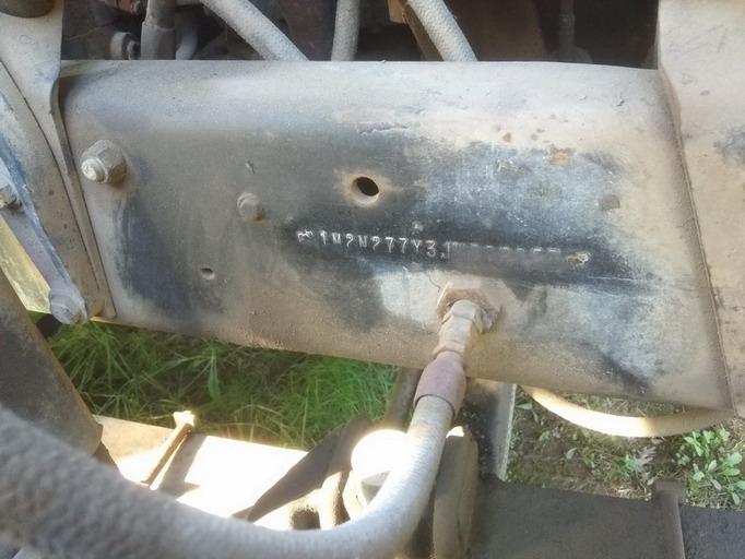

All is Keith said. 17 digit international standard VIN became about 1980 (I think different countries put it in service at different times and some haven't done that at all). All US made Macks have VIN starting from 1M... since 1 means US and M means... yes, it means Mack nothing else. Canada stamped 2M... Pre-1980 chassis numbers represened model and serial number starting from 1001 for each model.
The most trucks of the era had a chassis number stamped into the frame rail. Different models used different locations. R and RD had marking at the right rail behind the wheel. I saw two locations, further to the front as on the picture and further back to the rear spring hanger. Some trucks don't have the stamping though. I kept my attention to the matter and figured it could take place when a complete rail swap was done. On the other hand I saw relatively many Macks with no stamping so seemed like the factory was "forgetting" to mark chassis from time to time. Doubtful suggestion but I don't have anything better. in fact I have no idea on how many trucks on avarage were treated for a set of new OEM rails to be swapped during the lifetime.

Its there (unless the truck had new frame rails put under it at some point). You just need to get a little wire wheel on a cordless drill and clean off the frame. My 1960 B81 and my 1967 R model have the model/serial number that matches the door tag stamped into the frame rail in the front passenger side where everyone is showing. My 1994 RD690 is in the same location but as Vlad said its an actual VIN number not the model/serial number like you will see
