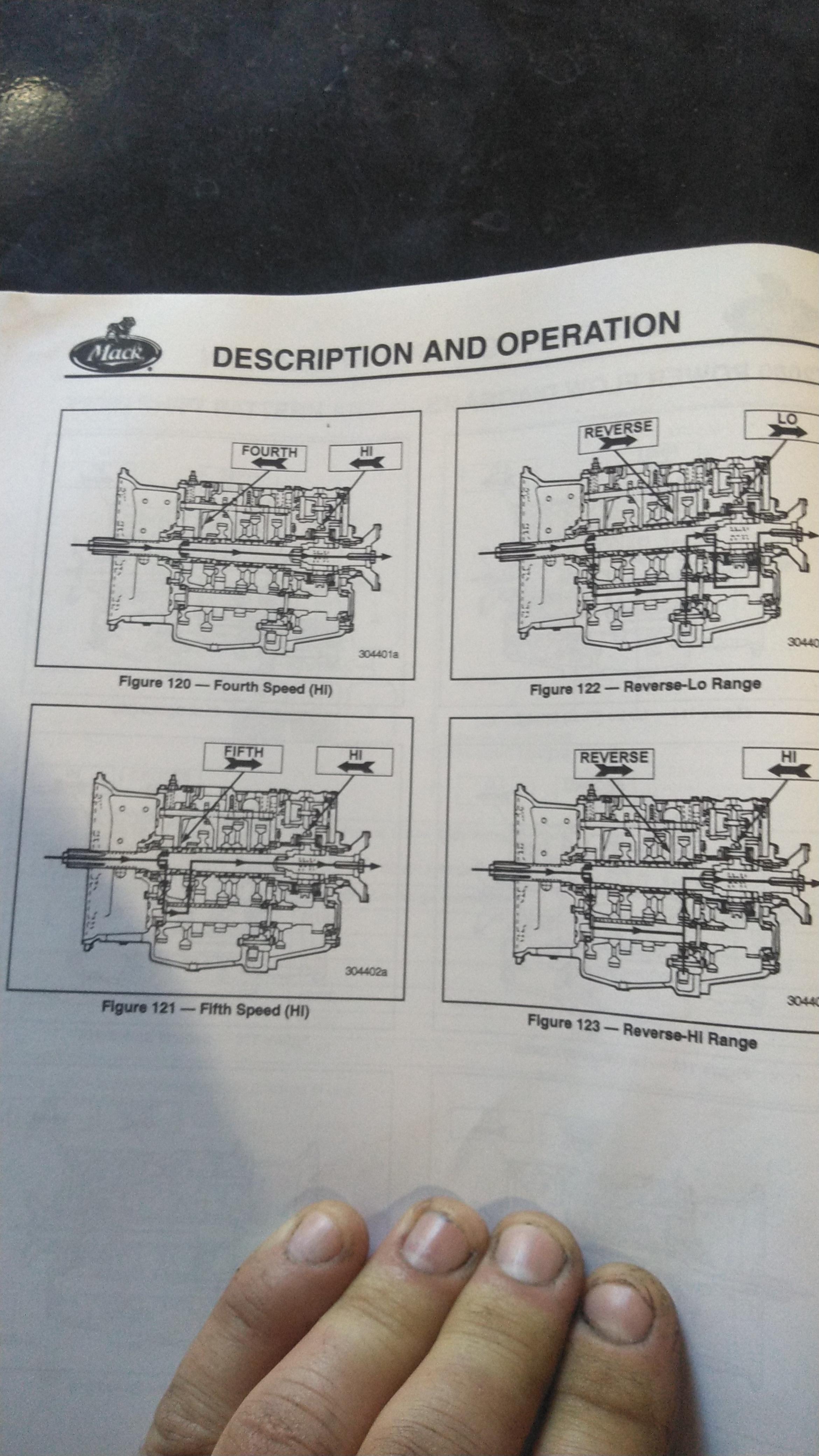

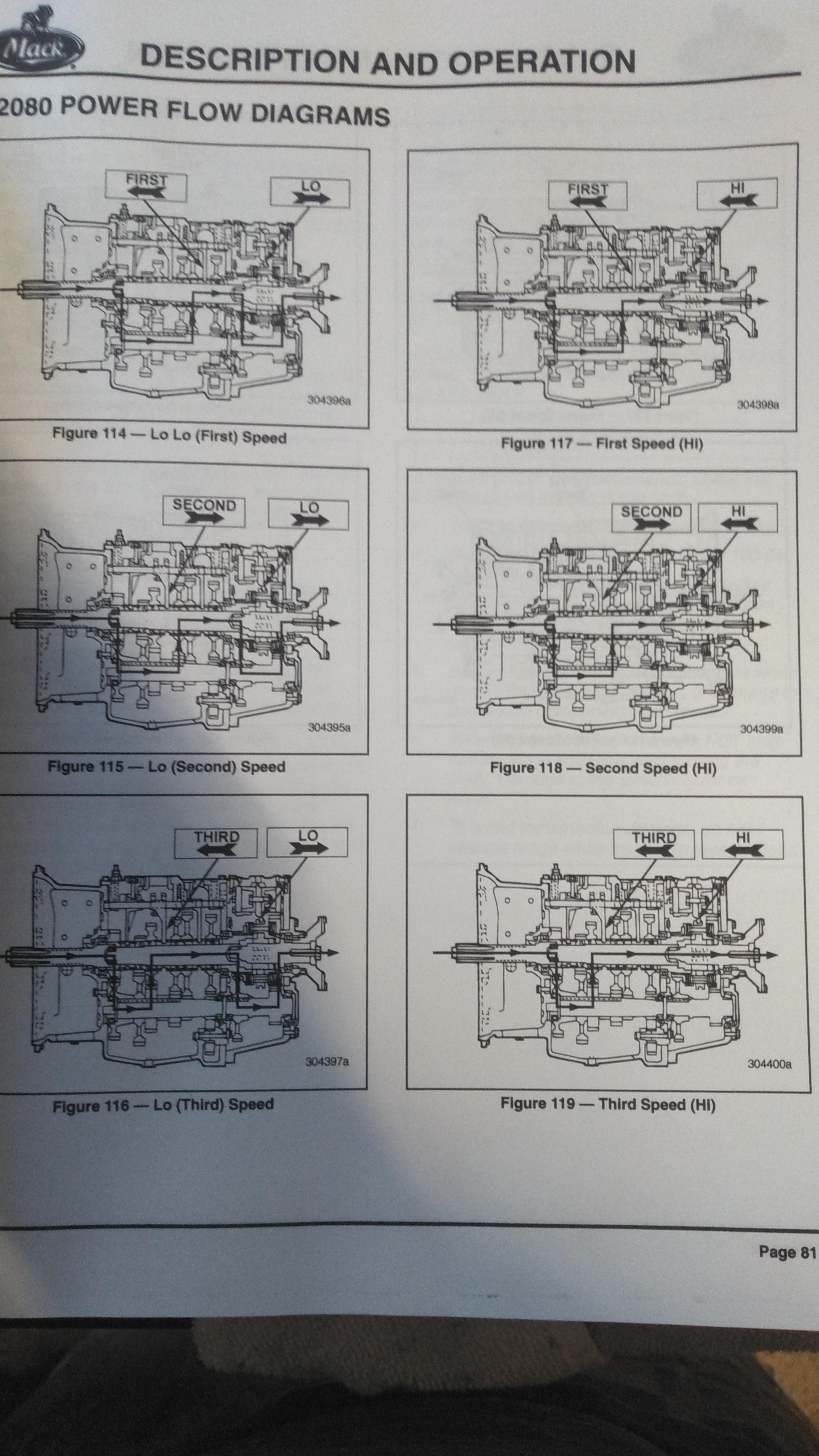

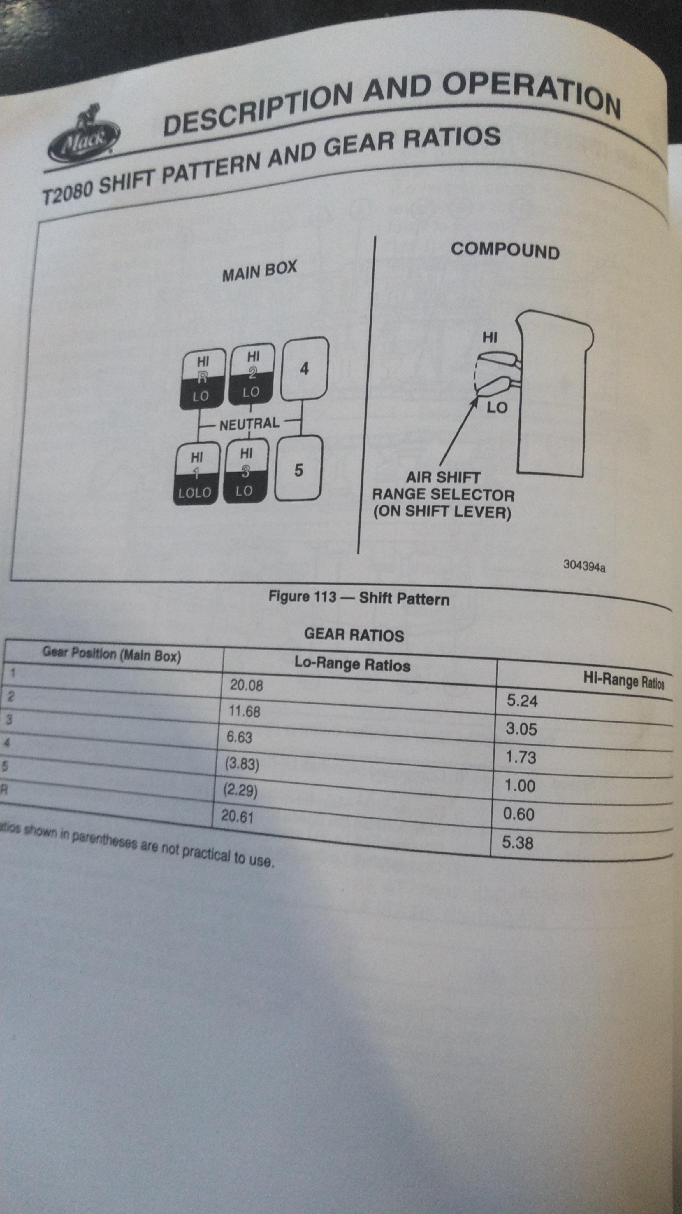

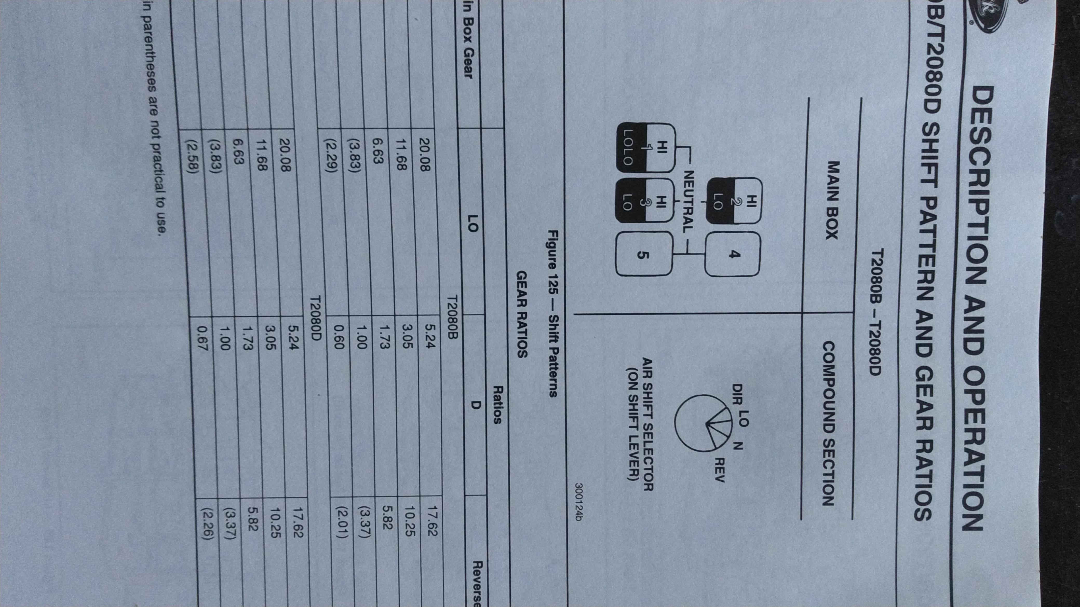

Hello Vlad,  I just went to my library.  The 2080B looks to have a synchro in the back box. I posted the shift pattern and the pic with my finger, is me pointing to the synchro. I posted pics of the 2080 just to show the difference. the picture with all the books is also in my library. I have 3 sets of 200 series books, and 2 sets of 300 series books, as well as Mack rears, drive shaft and many others...  I will post any info that I can to help you in the future.  jojo

Wow! Many thanks for the quick answer and immediately scanned images!
From the diagrams you posted both T2080 and T2080B have synchros. The unit of my desire is a long compound housing with outside shift cylinder. So it's definitely a "B". There was a tag in the cab of that truck which also said that. And there was a stick off the transmission with spinning trigger. Funny thing I already purchased that cab and the stick was laying inside of it. So the only thing I need to add is the tranny:) The truck was a 1998 DM concrete mixer which worked mostly in the city. So my hope is the drivers seldom shifted the ranges and the milage was not exremely high either. I may take the top cover off for the inspection but you can't see condition of the synchro teeth without taking it off and apart. On the other hand the cost of the tranny turns out as a half of a new PAI synchro set if count together with the mating gears. Or nearly twice more than its scrap value. So seems worth making a try.

That's what I would suggest using logic, the same as you did. But looking the pages of the manual you posted the T2080 short compound box also shows the synchro installed.
