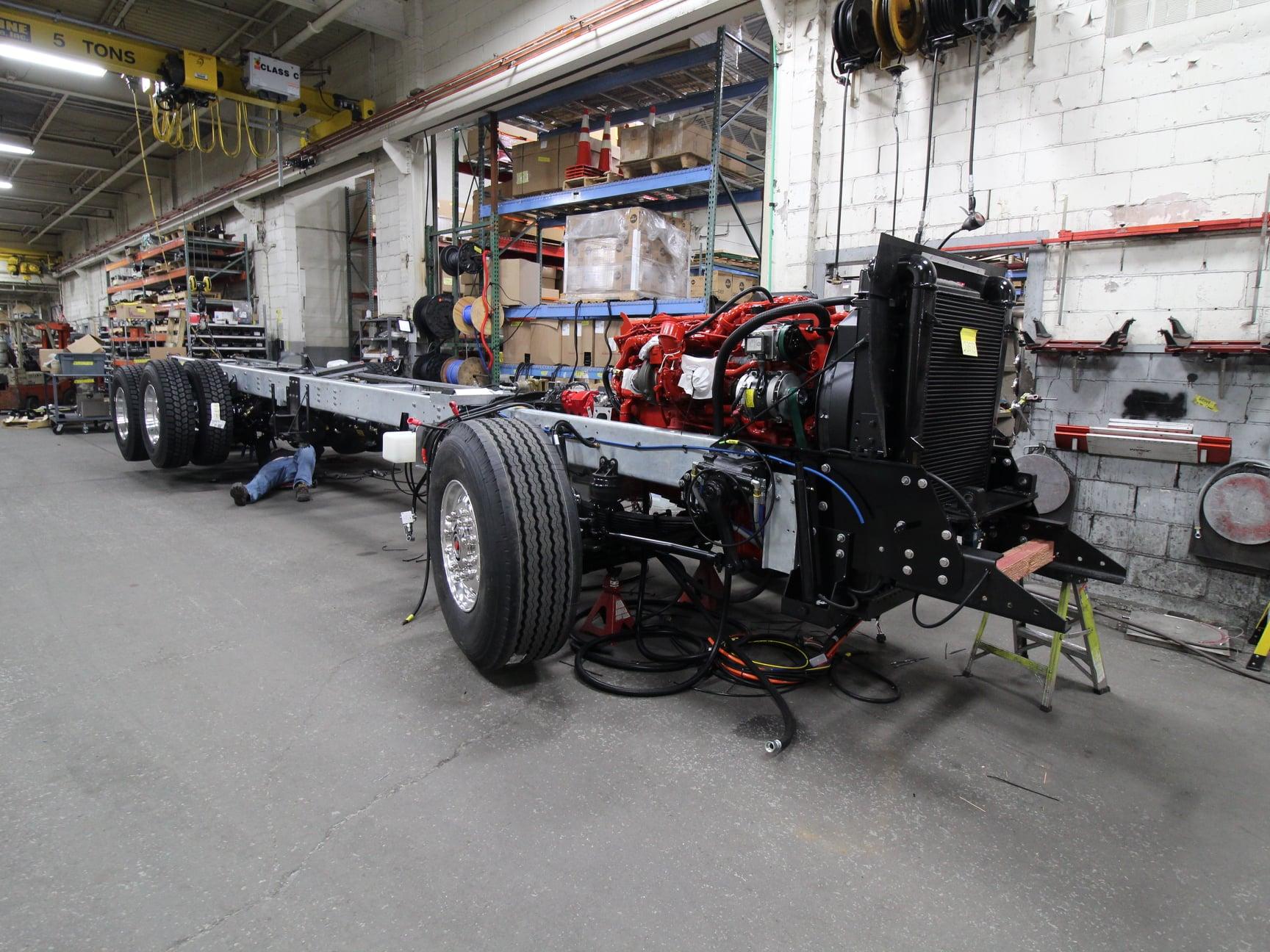

So a while back I posted pics of the beginning of our new firetruck, being built by HME/Ahrens Fox out in Grand Rapids, Michigan. Yes- Hendrickson who still builds crane and heavy application chassis but their main bread and butter these days is firetrucks. I meant to post pix of it as it went through construction but forgot to keep up I mean got really busy with work and family obligations. So here are a few selections for your approval. I mean, it would be nice if you approved but just in case you don't approve I will not lose sleep because I approve.
First up is the chassis. The frame, all crossmembers and the torque box and outriggers for the aerial ladder are all galvanized. The engine is a Cummins X15 set at 600 with a Jake. (We spec'd a 565 but the offered a 600 at no cost so who were we to say no?) Transmission is an Allison Worldseries (I think an AVS4000) 6 speed. Rear suspension is a Raydan air-bag assist walking beam and Meritor axles and disc brakes all the way around.

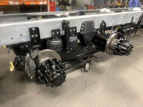

Here is the rear suspension- the Raydan air bag walking beam and the disc brakes.

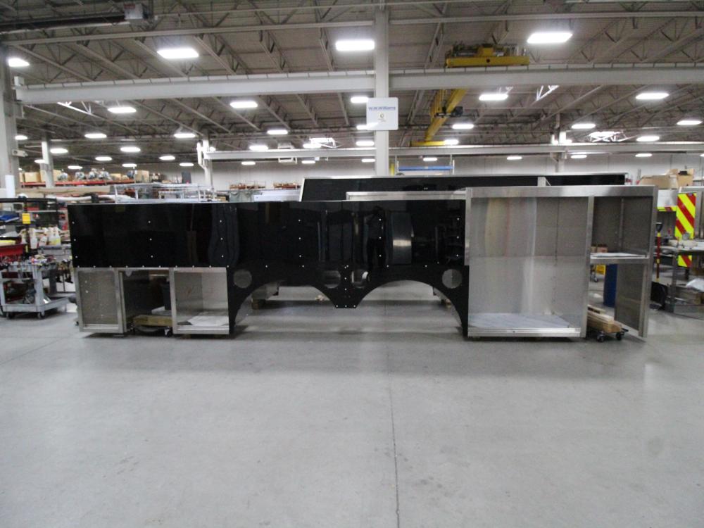

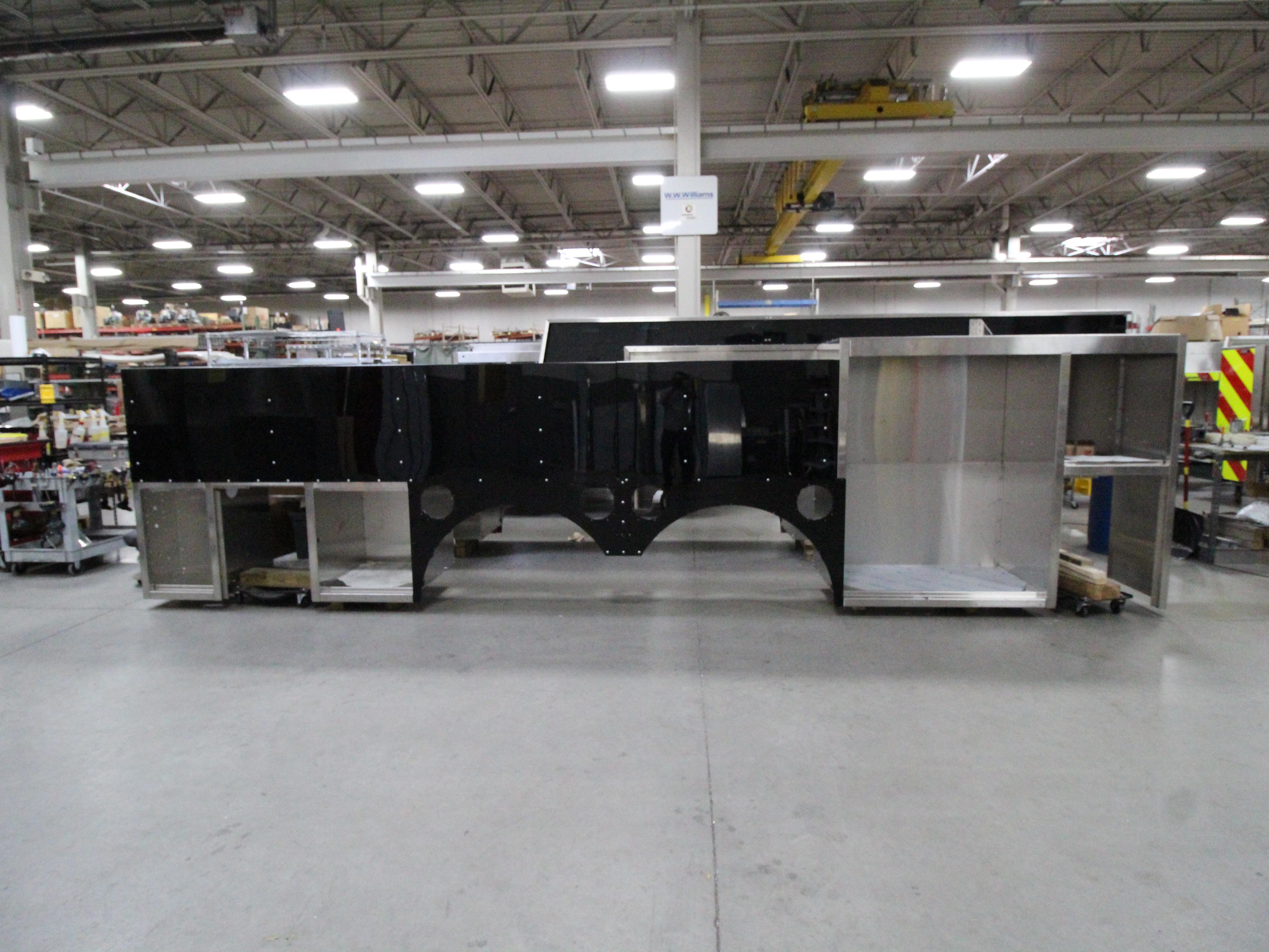

The body is bolted, modular stainless steel. Here is the right side.
ALL the pictures are fine.. can't post anymore "likes" so my approval is there. the use of disc brakes on such a large unit better in todays world ?? another example of changing technology  i'm guessing. did brakes on daughters car  couldn't believe the tiny little brake pads.
disc breaks do not suffer fade like drums do, and do not require constant adjusting either..
since fire trucks do a lot of braking, i would imagine they would be better than drums for firetruck service.
the tradeoff is the disc do  not last as long as drum brakes
interesting.
when ordering the two new trucks, we wanted to try disc brakes and dealer told us to stick with drum brakes because the disc did not hold up to heavy construction use.
i understand they hold better or work better cant really say its all in the foot pressure,,,if you ask me.. you have to be carefull washing your truck what i dont like you squirt water in the big holes in the bud rims and you get black brake soot running down the rim,real pain in the ass...bob
5 hours ago, tjc transport said:
interesting.
We do a mix of work, and have been specing disc brakes since 2015 on all of our new equipment.
Well Jessica told me that a wheel end repair including a hub, rotor, pads, misc costs, and labor an be over $2000.00 / wheel end..   Been there fixed that.... While a 3600 drum and a set of 4707 QP shoe's is under $300.00...  Jojo
