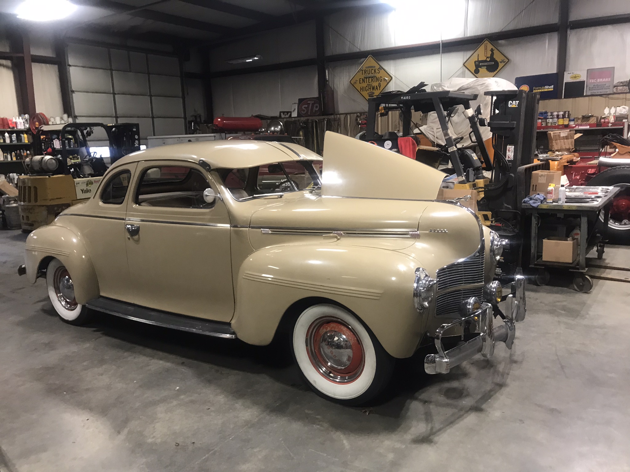

Back to car  I forgot the last car I bought before I moved out of  New England was a 48 Plymouth  2 door coupe one owner low mileage I think it was a delux too long ago paid 800 for it and sold it to a co worker at nissens fir same price I really liked the Way it drove smooth and quiet Bob

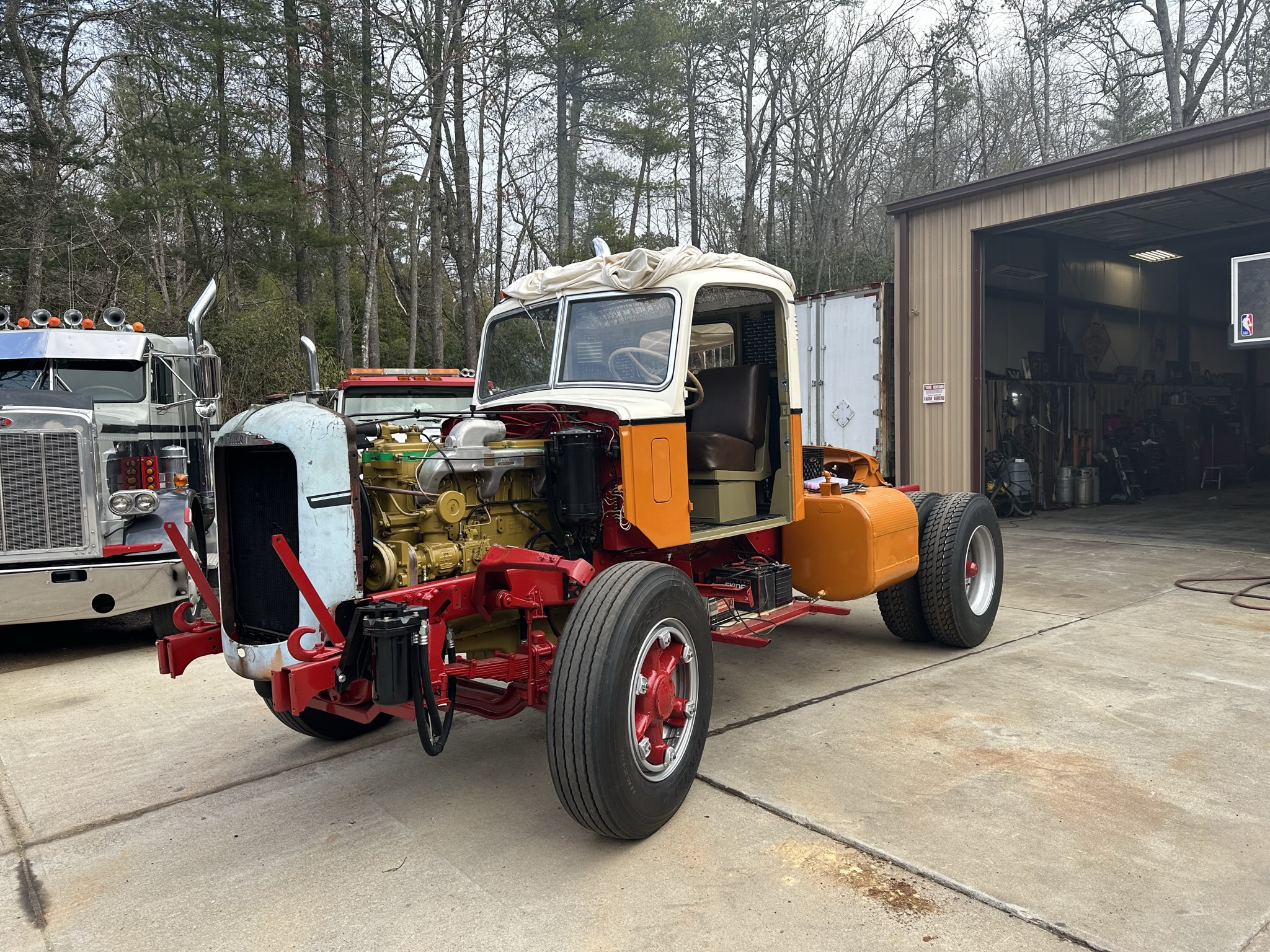

Moving a rig under its own power for the first time is very exciting moment. Also thanks for posting many progress pics, they definitely give motivation.

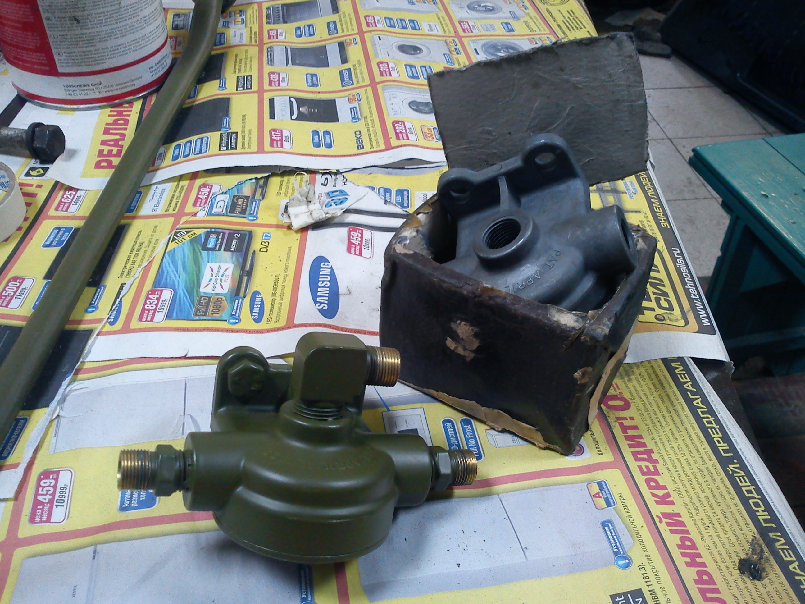

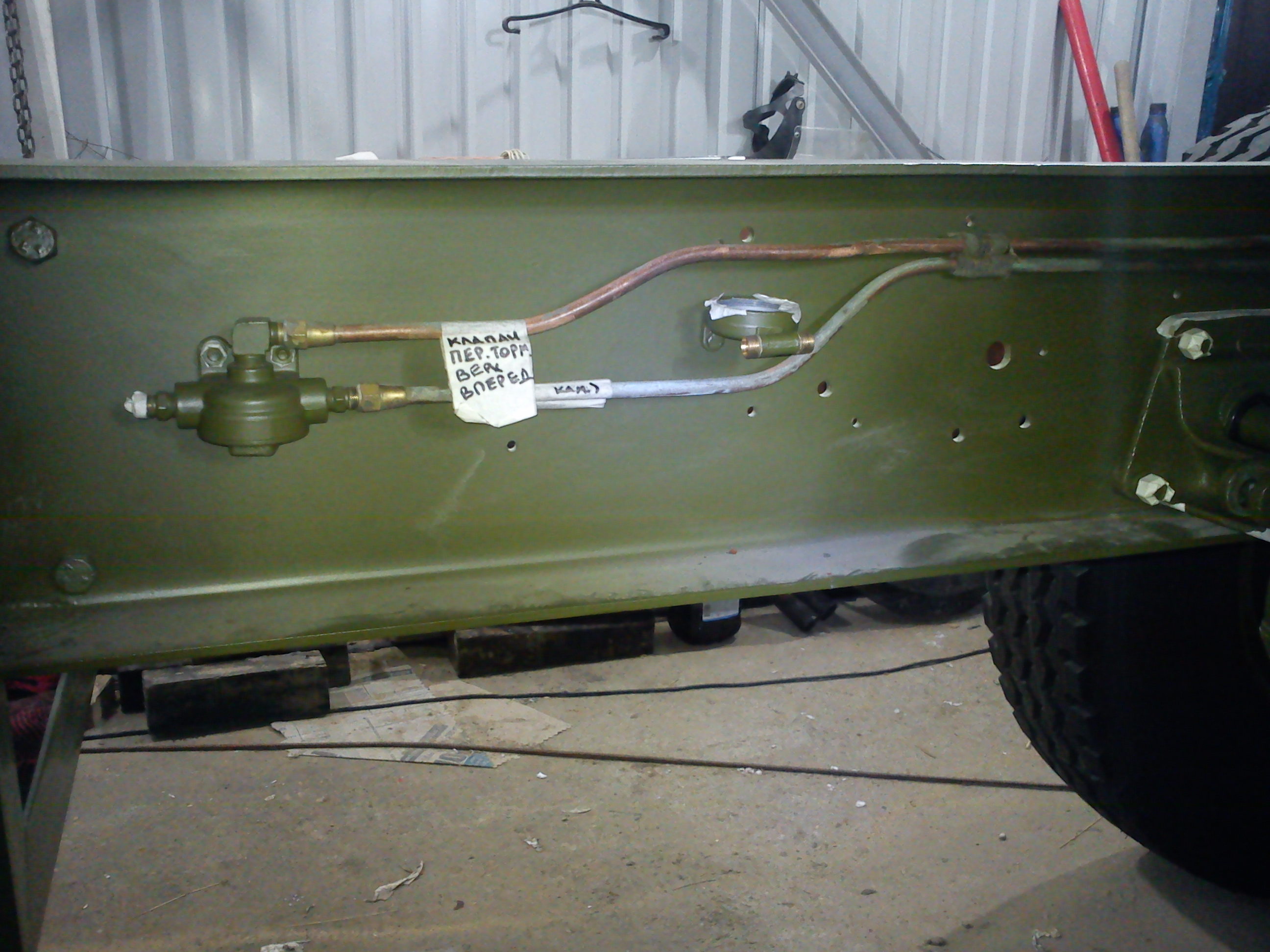

For any reason the pictures are how front brake quick release valve may look on a L-model. Mine has its schematic pretty simple. The top line comes from the theadle valve and two at the sides (they're actually at the bottom in the housing below a diaphragm) go straight to the front cans. My truck doesn't have a trolley valve and limiting one though.
Yes it was exiting for both of us! Yes the oil filter is easy to service, the 750 on the left at the firewall isn’t bad either, I remember setting on the fender and changing it.  Mine has that same QR valve on the frame for steer brakes, thanks for the pictures
