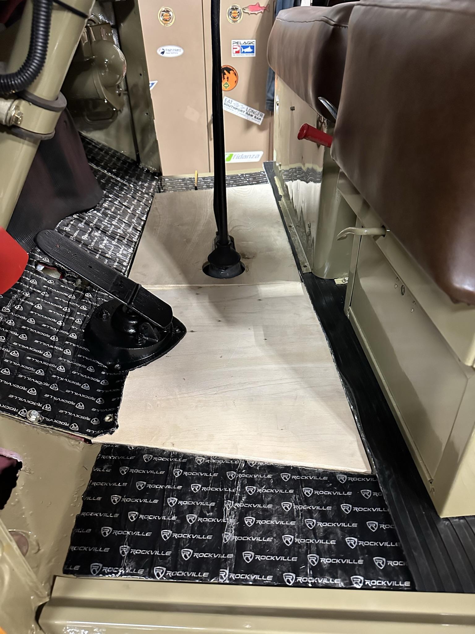

Yeah you see several different floors in them, I’m sure you’re correct on years of u joint grease and trans oil soaking it up like a lamp wick. I have no clue what wood Mack used, looks like plywood, that’s what I’m using to replace it (1/2 inch) .
Wow my sister just got back from there. I was on vacation she didn’t want to go back to New England  ha ha she’s planning on moving there after retirement…still too cold around here as well. Cool Scout I  I had a 67 way back in the 70s. Thanks for sharing. Everything you post is just as exciting as mrsmack paul haha keep them coming… Bob
Oh, by the way, knowing absolutely nothing about wooden floor boards I would’ve guessed three-quarter inch plywood and  yes  quiet it down it will probably be more soundproof than  my DM is once you got everything all set up.. Bob
did you ever consider 5/8- or 3/4 double laminated plywood used inside refer trailers? Baskin robbins trailers had the double laminate side walls. alot of moisture there along with weekly pressure washing. never a problem. i'm sure expensive ;;; even taking a cut out rubber mat glued to top side of laminated for non slip floor . i used a cut piece made to fit inside of my day cab for my "motel lay overs " . clean, fit between seats  and stood behind seats when not in use. sister-in-law made a cover for the "mattress"(2- 2in foam ) . like everything today the so called pressure treated plywood isn't that great.
Hopefully I can get back to my floor in a week or so,, my old wood is 1/2 inch, I picked up a 2 foot x 4 foot piece of 1/2 plywood, I’m going to cut it out and try it,  I think it will lay flush, then I can put sound deader on the bottom, I might be able to use 5/8 , the foot valve base bolts to it so it needs to be close to original. I’ll experiment with the 1/2 and see how it goes, ready to get the inside done and move on to the rest of the body work.
