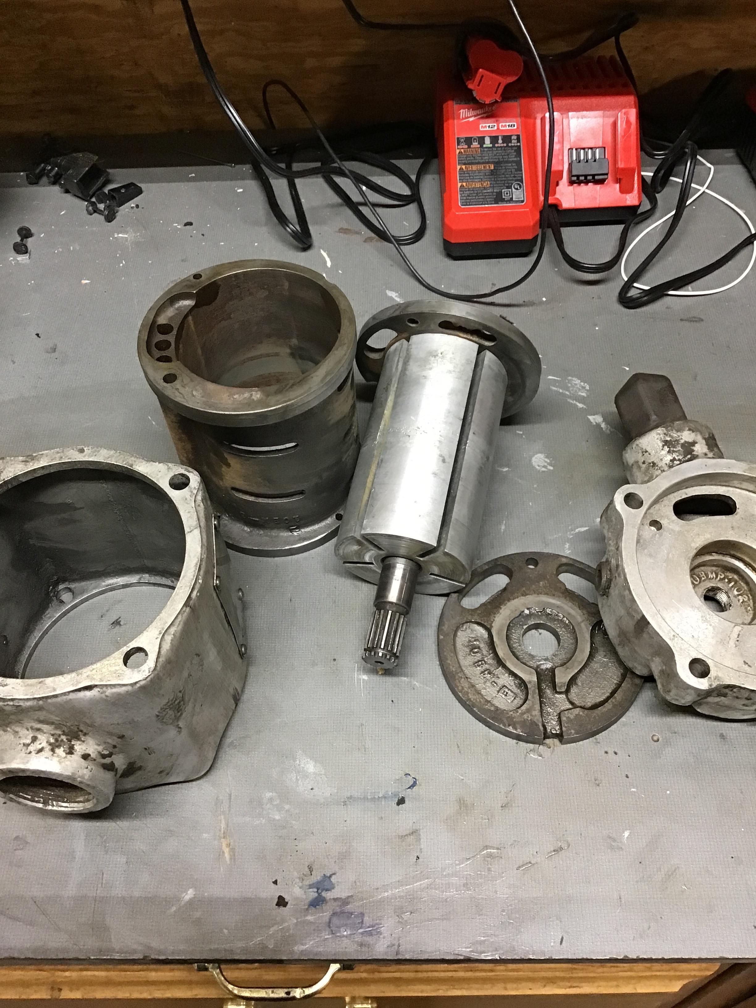

The vanes are probably stuck, just pull it apart and soak in diesel
They need a huge volume of air to force the fins out and spin them
Or at least on the ones I work on
Air goes thru the rotor part and blows the vanes out against the stator to seal them and then the rotor forced by the air as it is sealed up pretty good
Rebuild kits are readily available in Australia as nearly every Mack sold out here was air start up into the 90's
It is very rare to see a electric start Mack built up until the late 90's
Paul

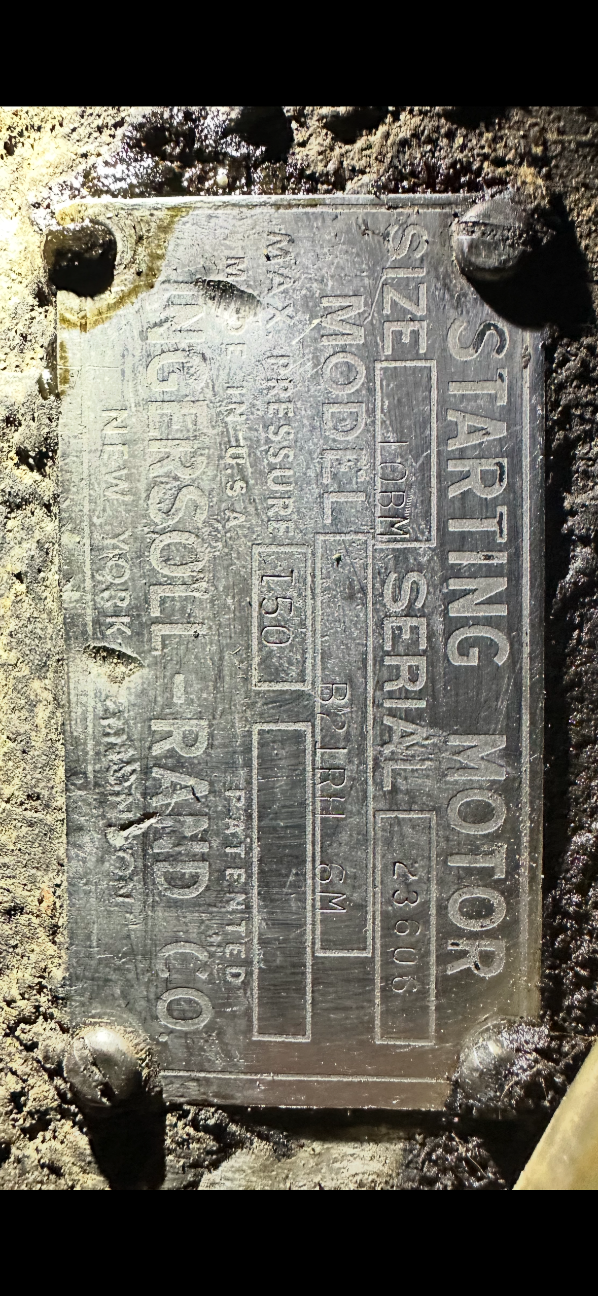

Might try ASC in Texas, they had all my I-R stuff I needed.
That is an old model and parts may be thin to non-existent.
It would be replaced by a 150 of some sort.
If you take it apart, mark the parts esp case sections so you put back the same way around.
Simple devices.

It was a rainy morning, so I thought I’d take it apart, actually all I need is the end gaskets , and I can make those, the vanes have scratches but not terribly bad,,, I’ll contact ASC and see if any thing is available,, if not I’ll clean it up and put it back together ( I did mark all the sections in the direction they came apart) . Thanks for the suggestions .
