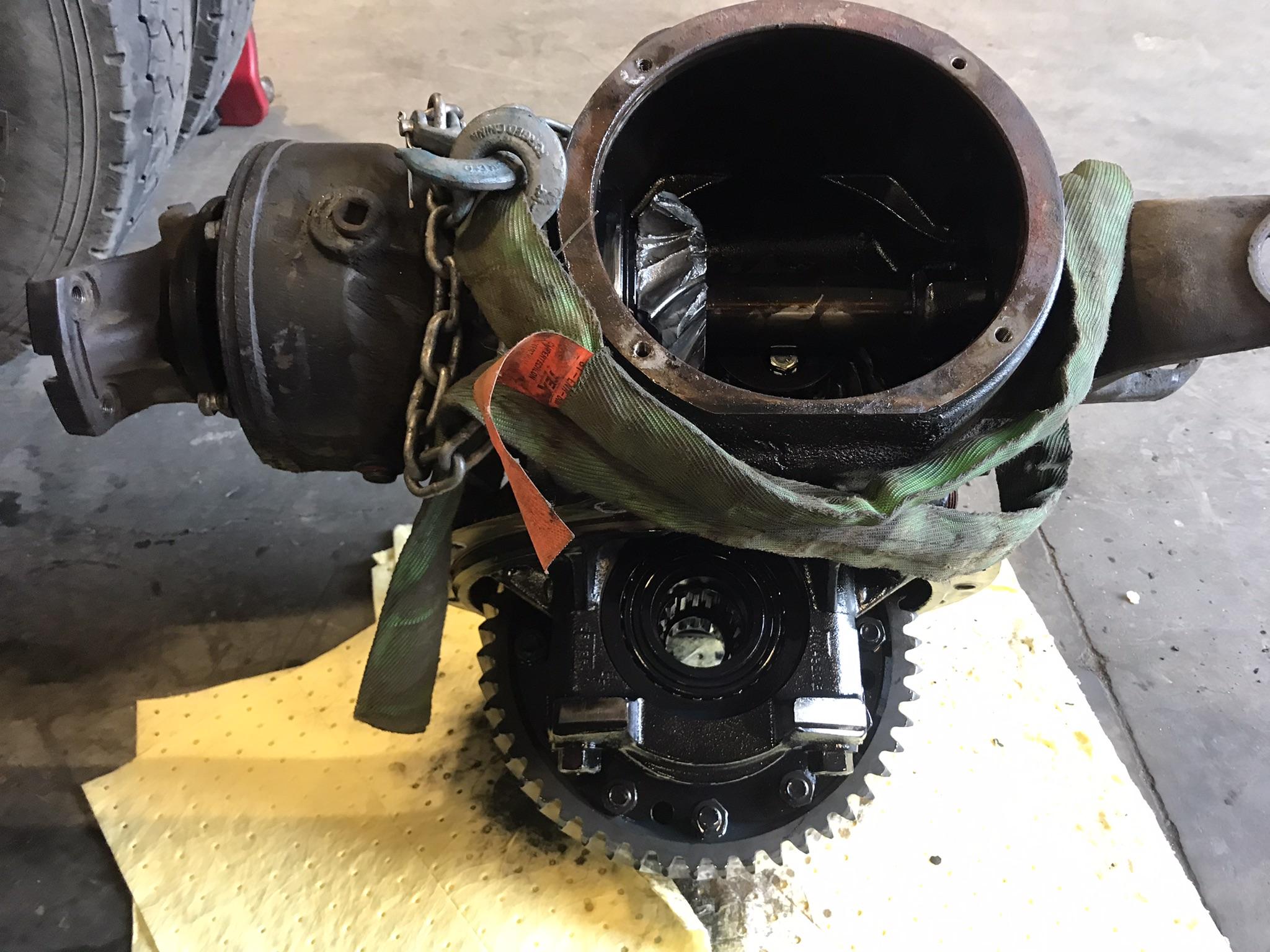

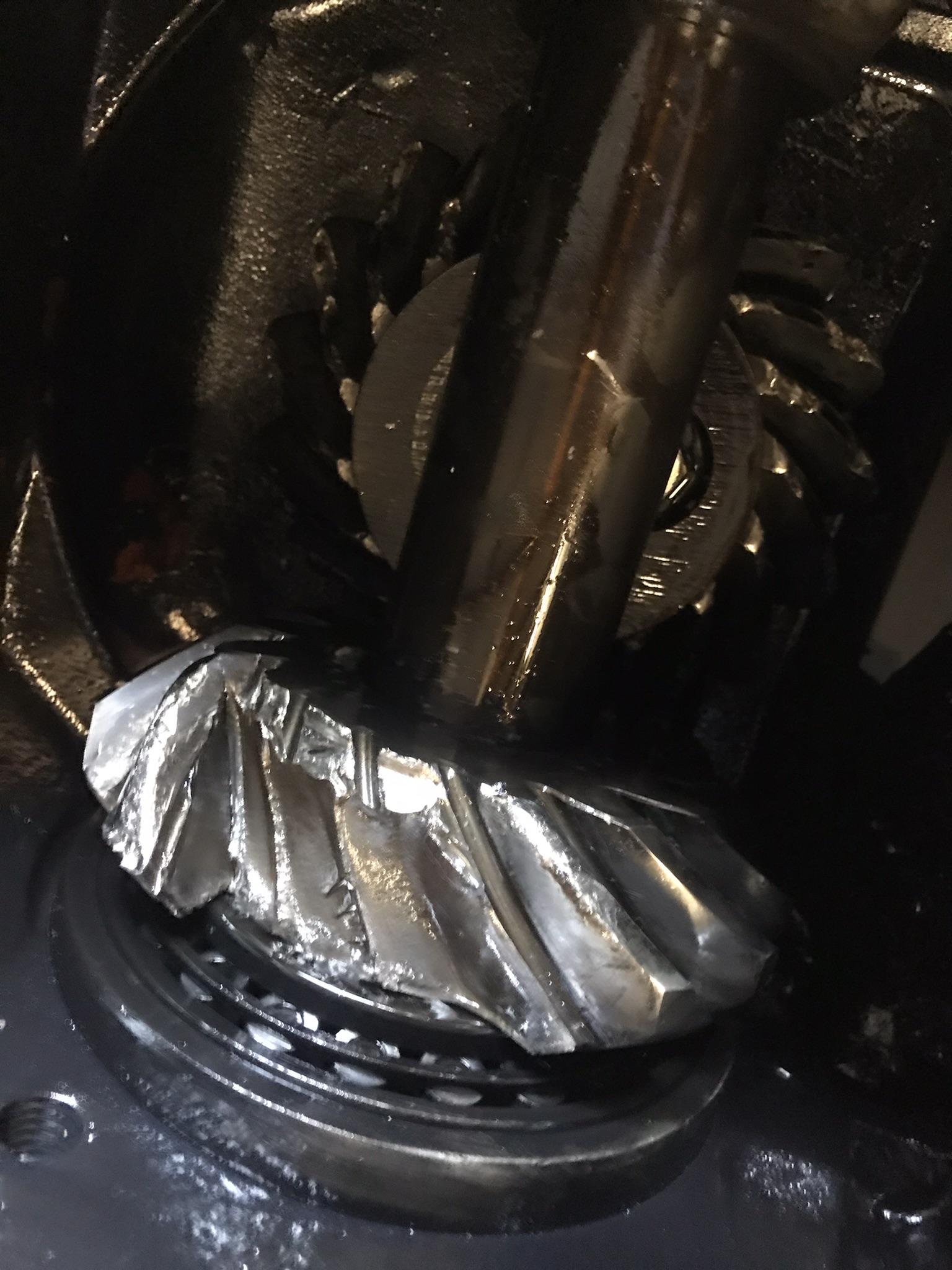

i still remember the loud bang when the press (60 ton) takes out the ring gear shaft . one of my mentors at waterbury mack ; ole man (said with respect ) Dixon  ran the machine shop. he told me when pressing that gear stand on side of press and work the handle'' and i did! the  good old days

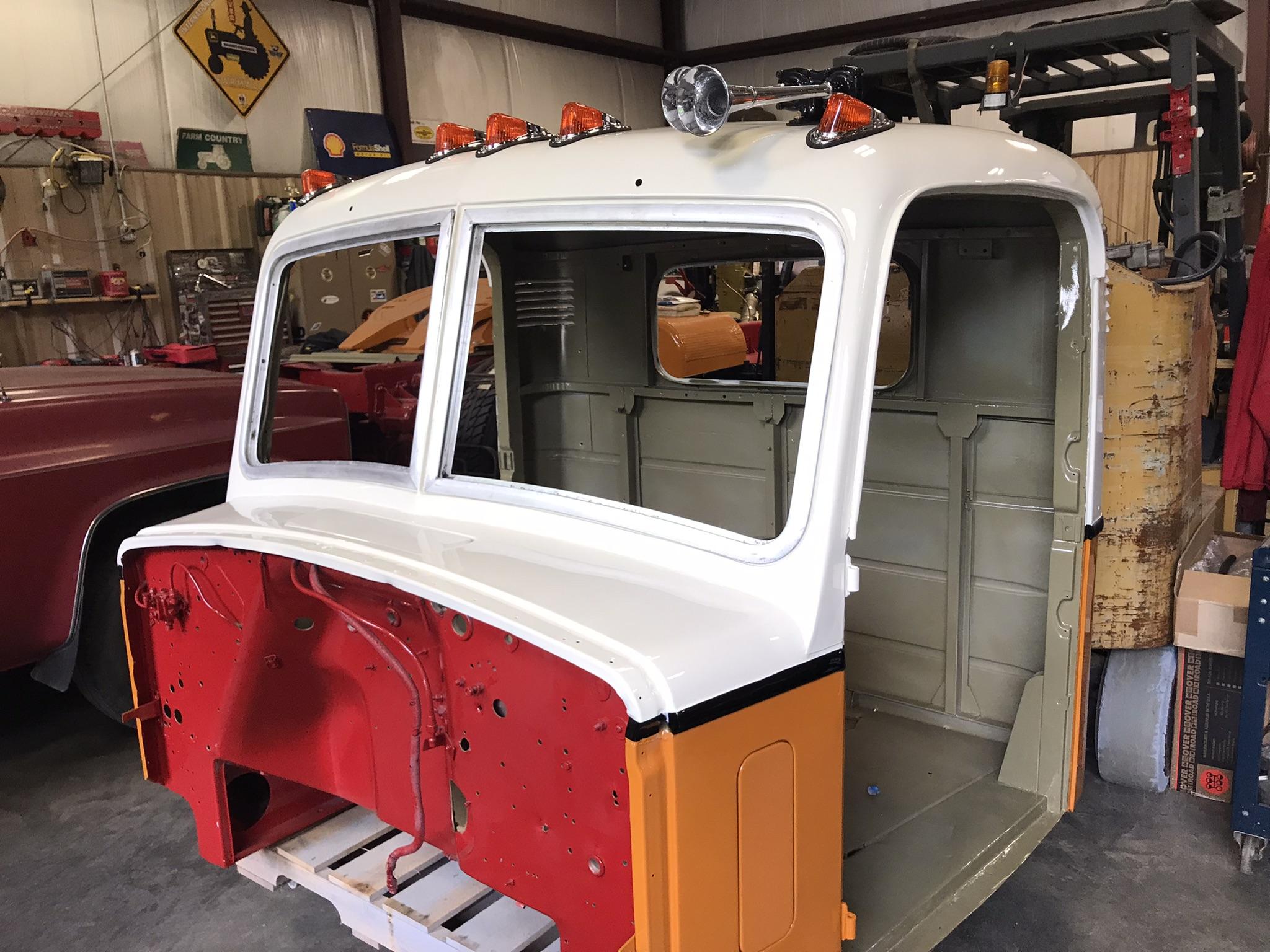

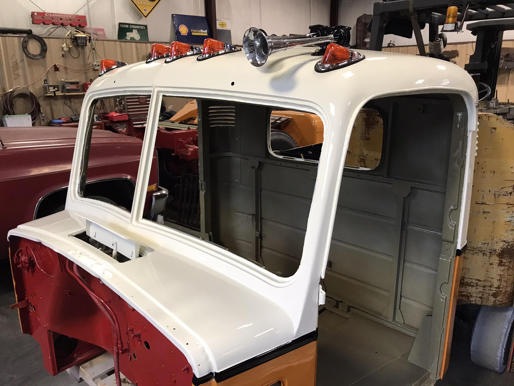

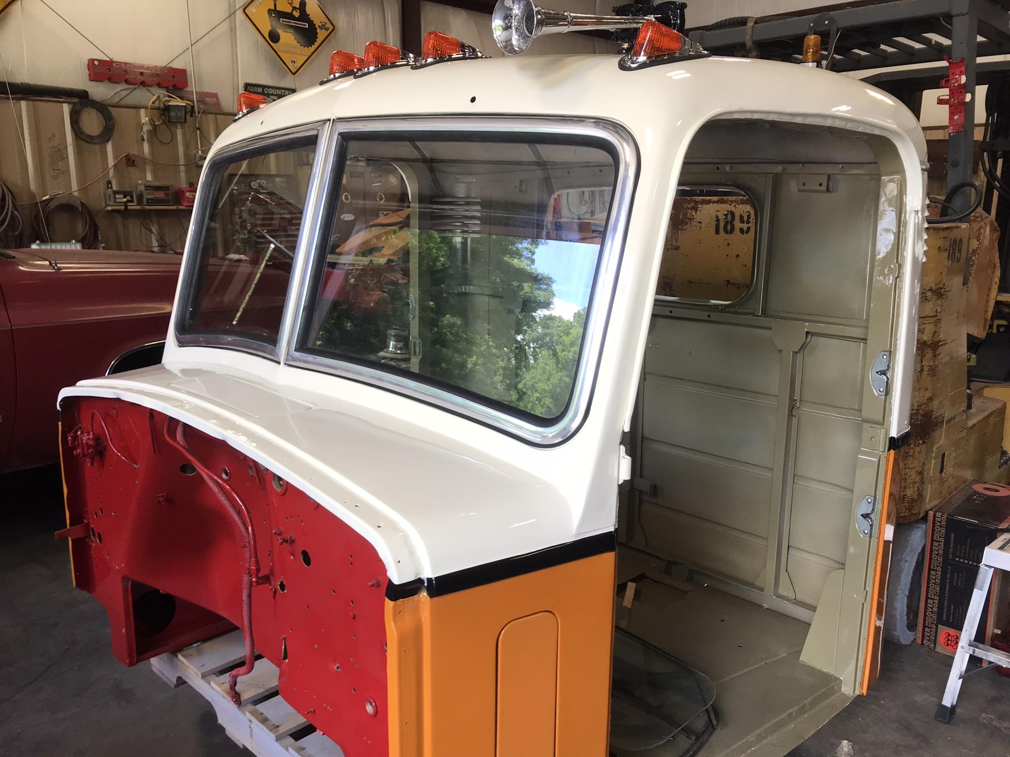

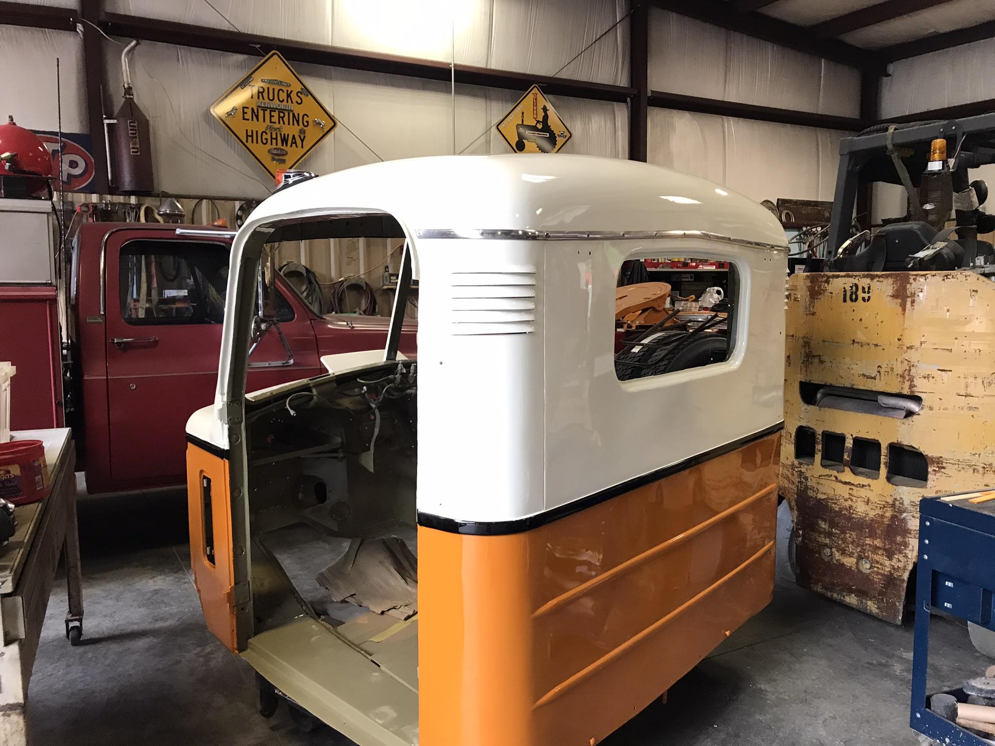

I got a couple hours in on it this afternoon, I’m going to try to clean & polish my windshield frames next, I have all new rubber for it , I took them out about 1996 so I have forgot how they go back,,, I maybe asking for help !
A candy!
On 6/16/2022 at 5:54 PM, mattb73lt said:
Nice touch with the strip. Mine was aluminum, but heavily corroded. Replaced it with a steel one I got off the roof donor.
Hell I didn’t even notice the strips that is a real nice touch I was too busy gawking at the peaches and cream… bob

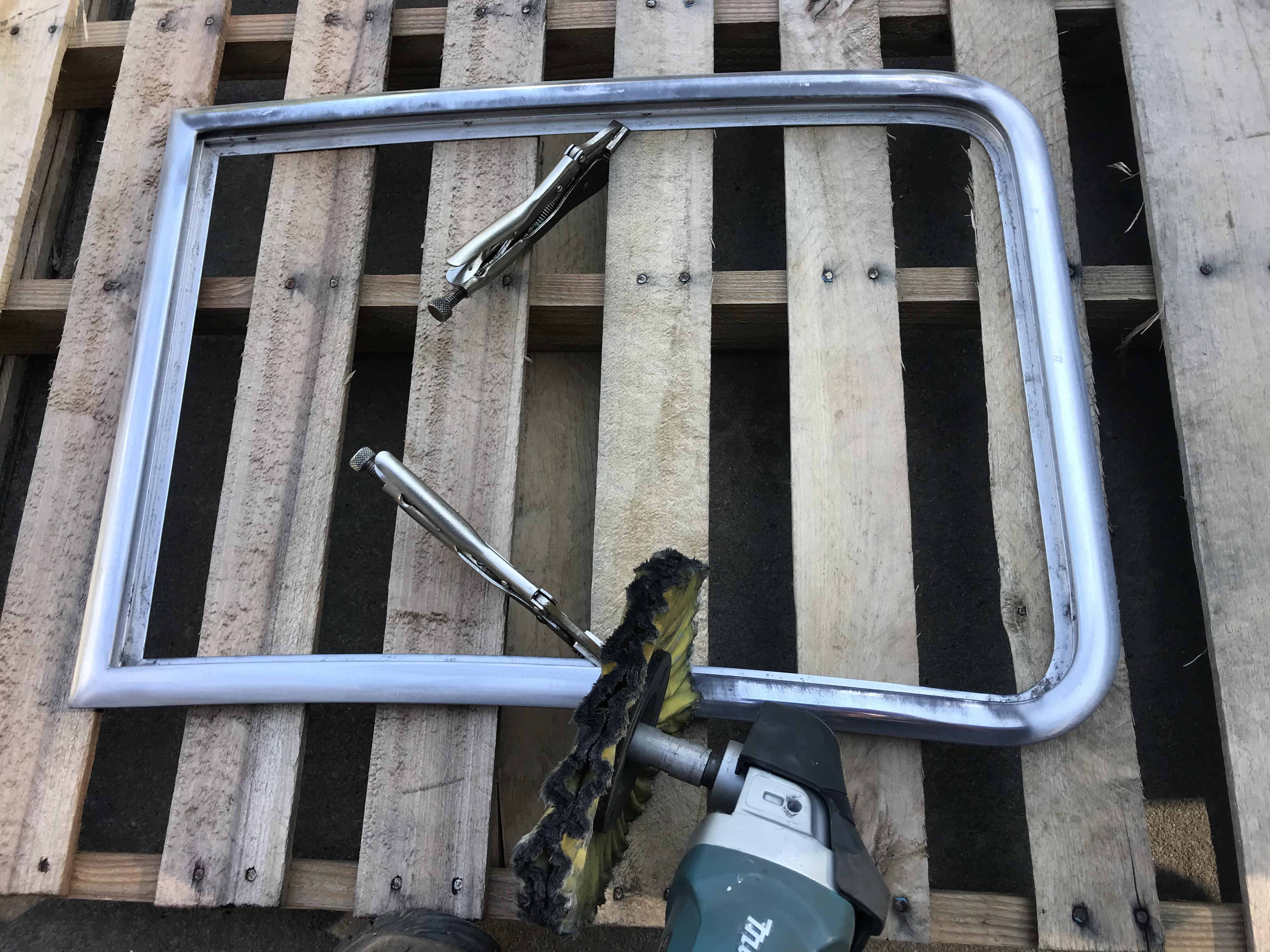

Well if any of you fellas have a fancy idea to clean up stainless steel let me know I bought some nice straight grille moldings a few years back for my DM and one of them is tarnished and I really don’t know what to do with it bob
A buffing wheel and jeweler’s rouge can usually bring it back. There’s a whole series of wheels and compounds that work with stainless. Look at the Eastwood site and you’ll find what you need.
Stainless is a tough and forgiving metal. I’ve blended out some pretty deep scratches on some pieces I’ve fixed.
On my exposed hardware I replace a lot with bolts from Totally Stainless. I’ll file off the head markings then buff them out on a wheel. They’ll look like chrome and never tarnish.
Right on man thanks for the information I did not have a clue to what to do with it full set of really Clean moldings as I imagine one of them is tarnished other than that they’re almost mint they should look brand new once I get the tarnish off thanks again …. Maybe one of these days I can get started on the damn thing before I croak I’m still waiting on parts to get started on it I can’t wait to at least drive it into the garage and see what it looks like in there ha ha.. Bob
There's 3 kinds of Rouge green,brown,and white also 3 buffing wheels green,yellow,and white. That's what I use. Also if the stainless is heavy with rust I use WD40 and steel wool and it turns out pretty good.
