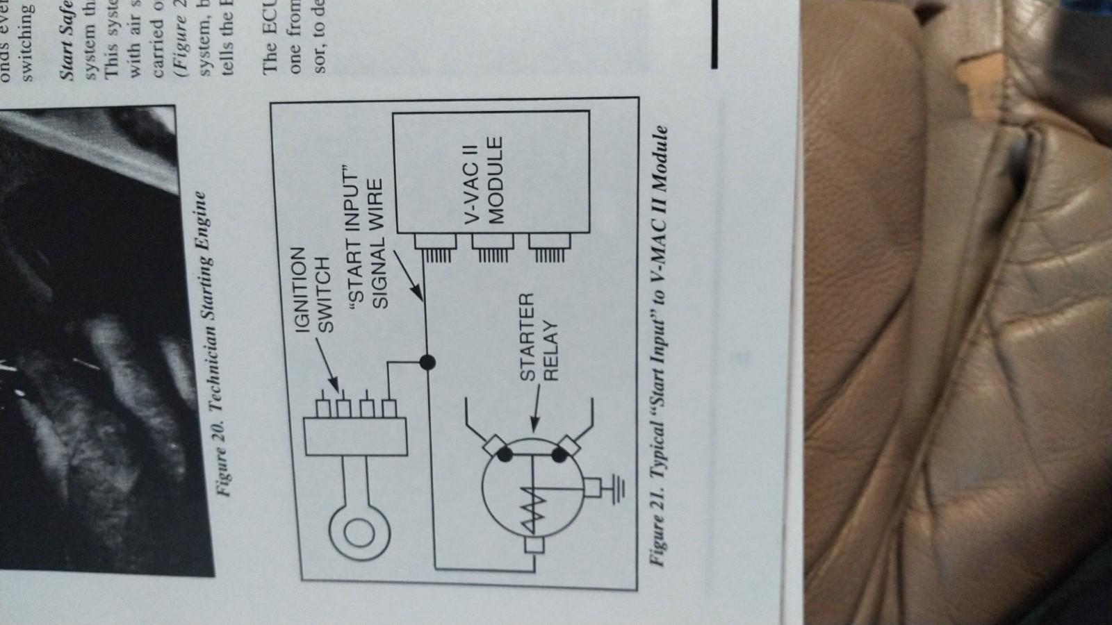

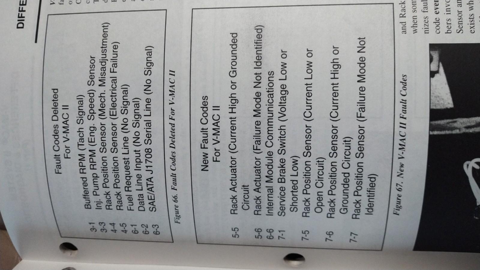

Sorry about the rotated pics... I don't know what I did there..  when you get the blink code out of the truck, post it and I will send you the flow chart for the repair..  jojo
You are a dedicated soul bro!
Thank you "F"  I have collected many books, from Mack schools and E-Bay, and so on..  They mean a lot to me and, If I can help someone keep there 'Dog' of it's leash, I will... :) Jojo
