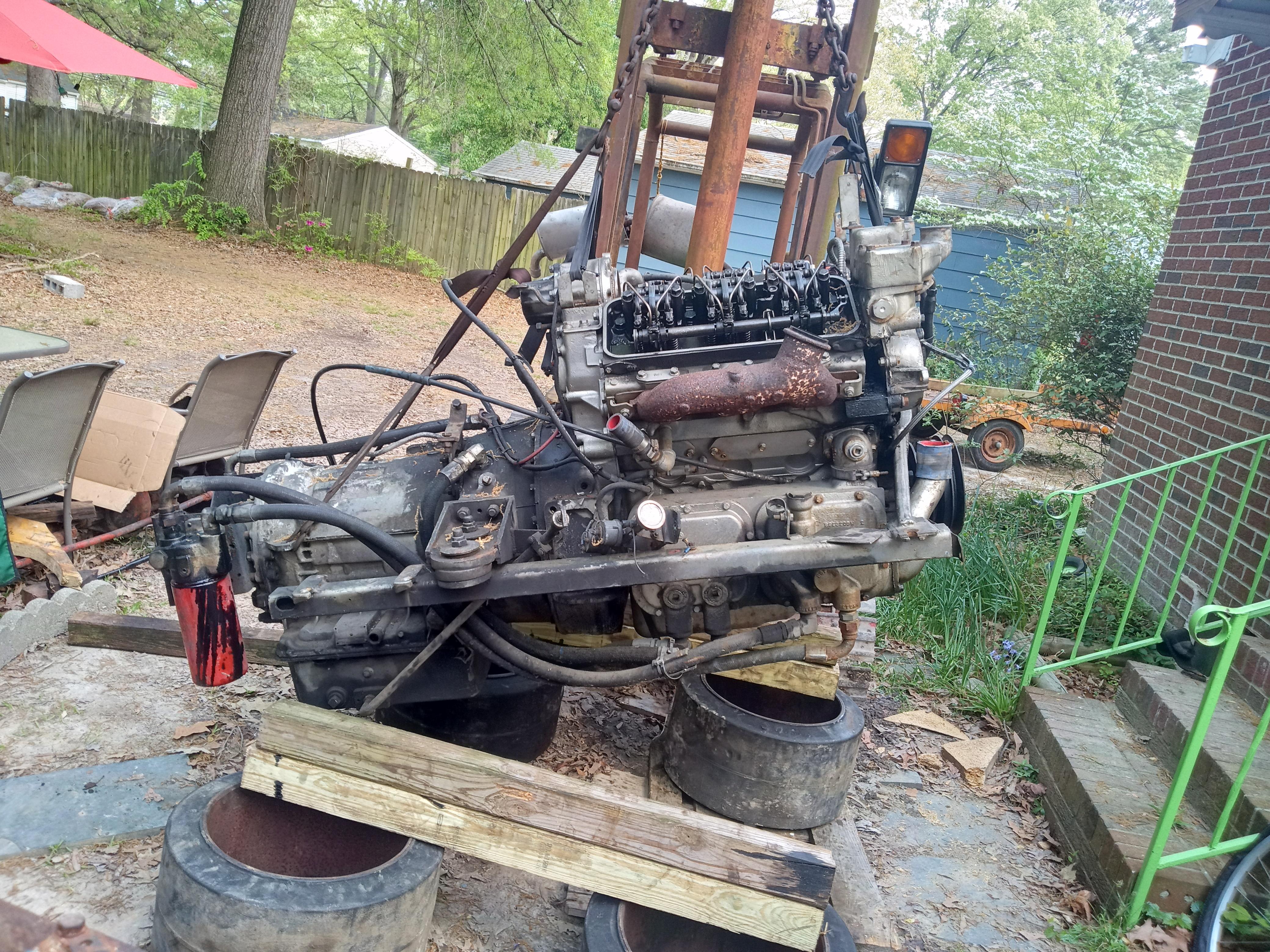

I'll answer part of this once I get this apart🤩
Got it started today! I'll post 6v71 and 6v92 cranks soon.

 well 71, v71 and v92 are all different as far as the motors i have.
inline 71's manual mentions different size "flywheel housings"(SAE 1 and SAE 2) but i didnt see any mention of different crank flang sizes or cuts.
also states the inline 71's crank has one hole offset 😠

ok i was incorrect on 671 and 6v71 cranks not matching. They do match!!!
  On 4/22/2022 at 10:44 AM, 1965 said:
Flywheel housing bolts are different. 92’s got 2 extra 5/8 bolts on the sides. Flywheels will bolt up on both, I believe, been long time.
Expand
i was thinking samething so i checked again and it did fit but too small of ring. its from a 671 with SAE2 flywheel housing and my 6v71 is SAE 1
