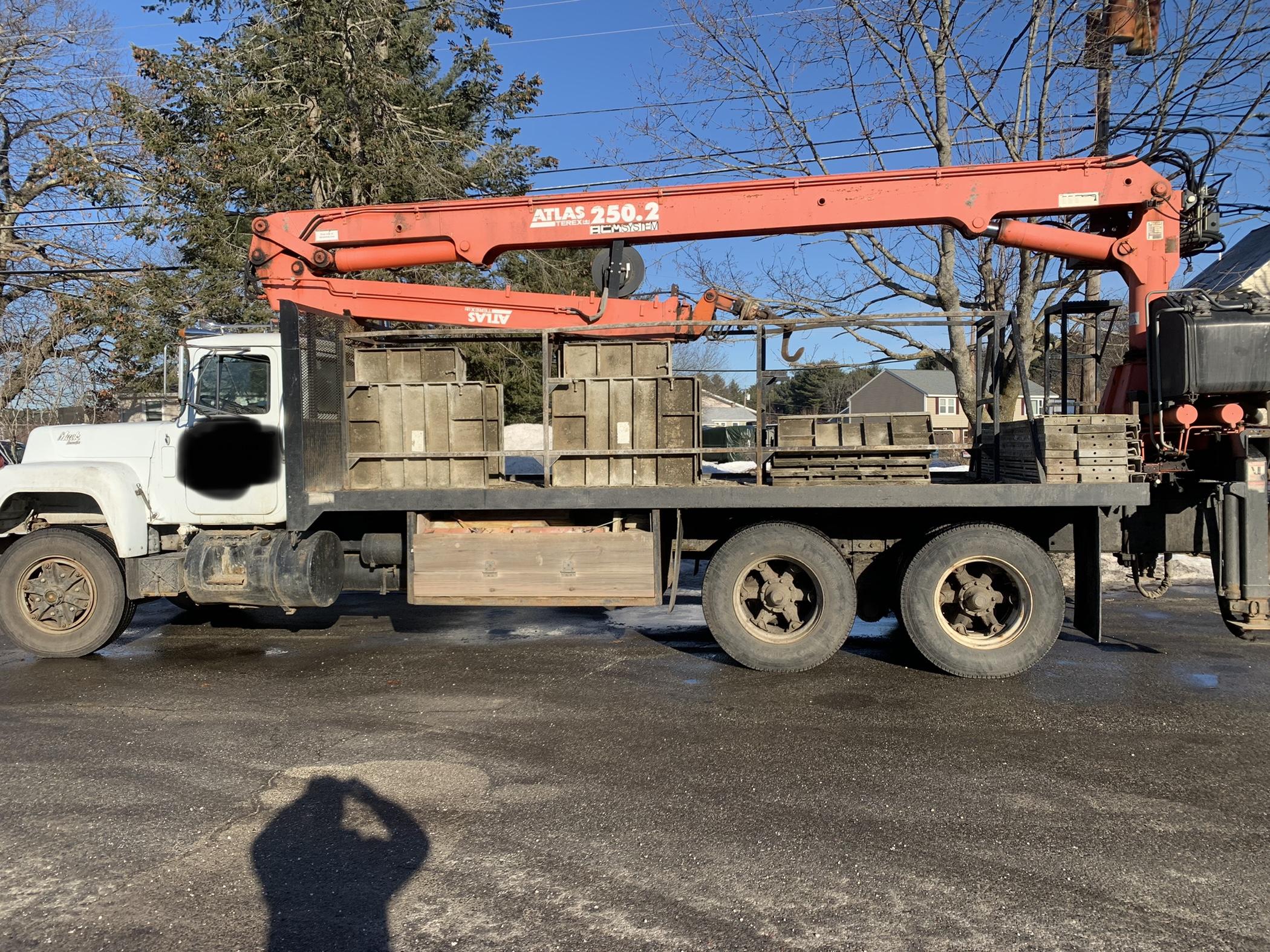

looking to replace an 86 Rd straight truck that carries  58k lbs and found an 07 CV713 with the 370ami…
are these reliable motors?(this one has 200k miles, 9500 hours) I’ve read some people having varying issues over the years…egr..?
probably only drive about 5-6k miles a year.
any advice appreciated

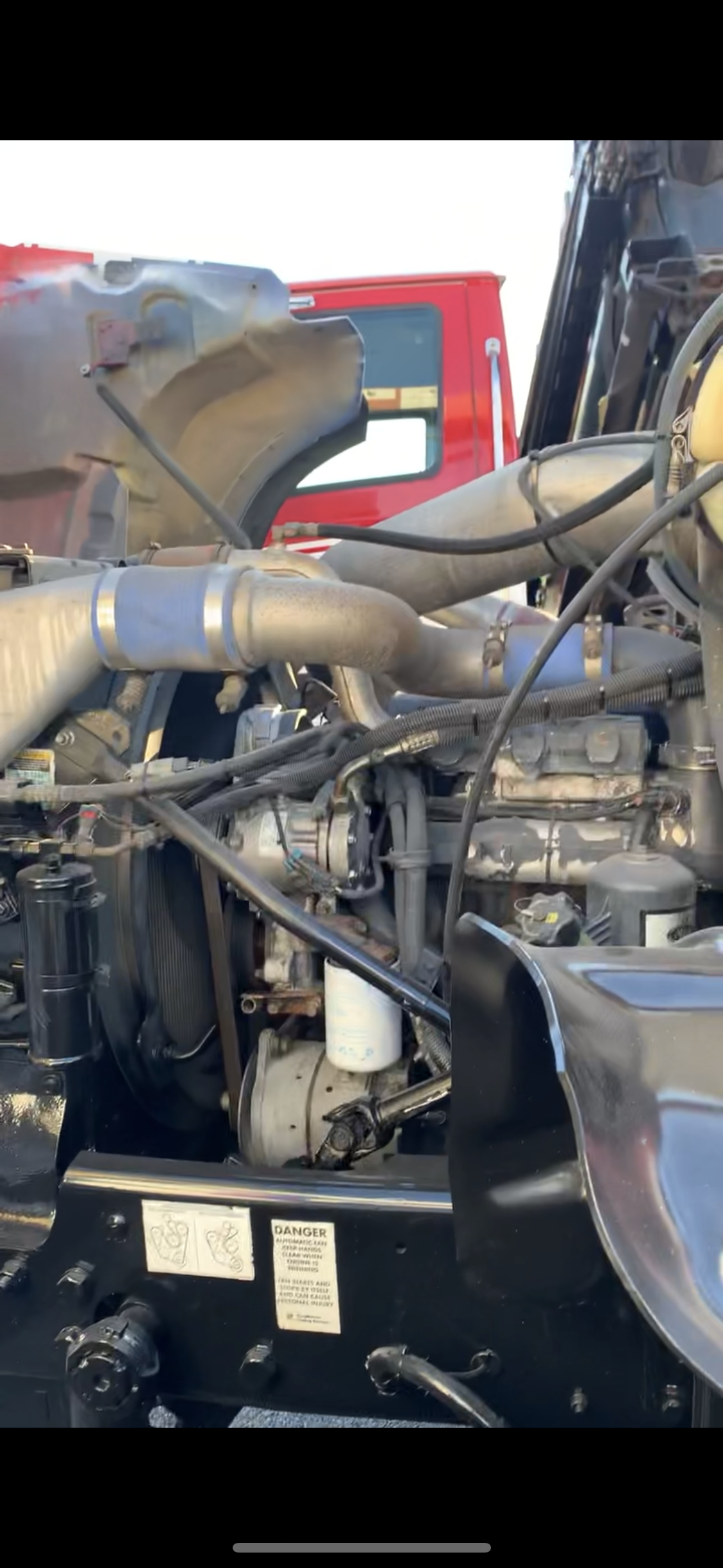

The Granite truck is a good one, It replaced the RD.  The ASET I is way better thatn the 'C' series..  Do you know how to tell the difference by looking at the engine?  Good luck, jojo

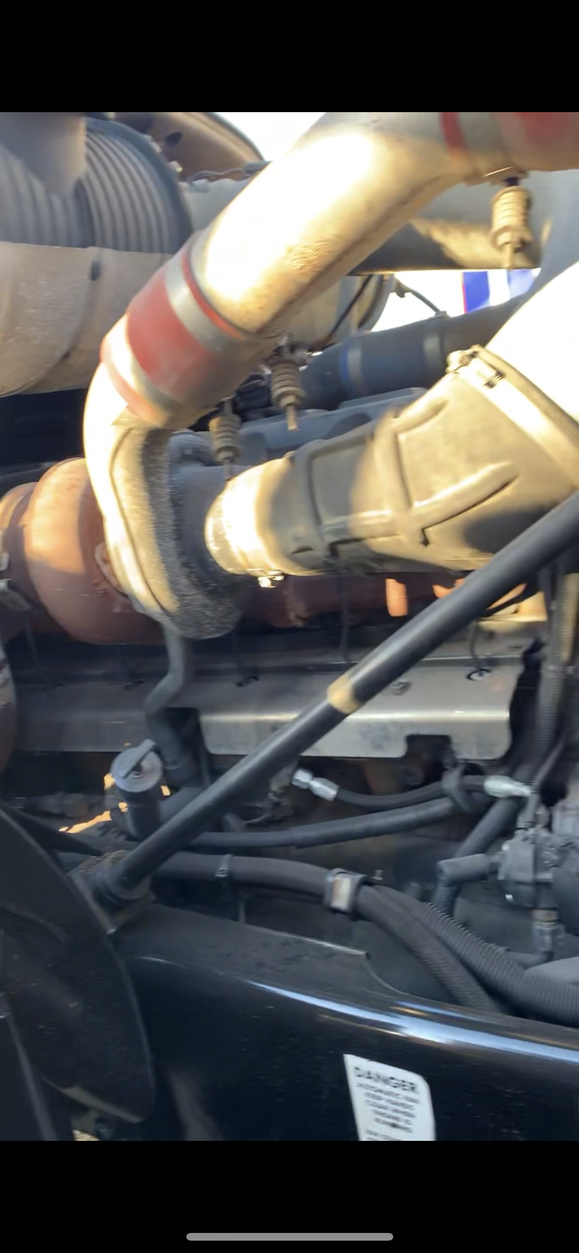

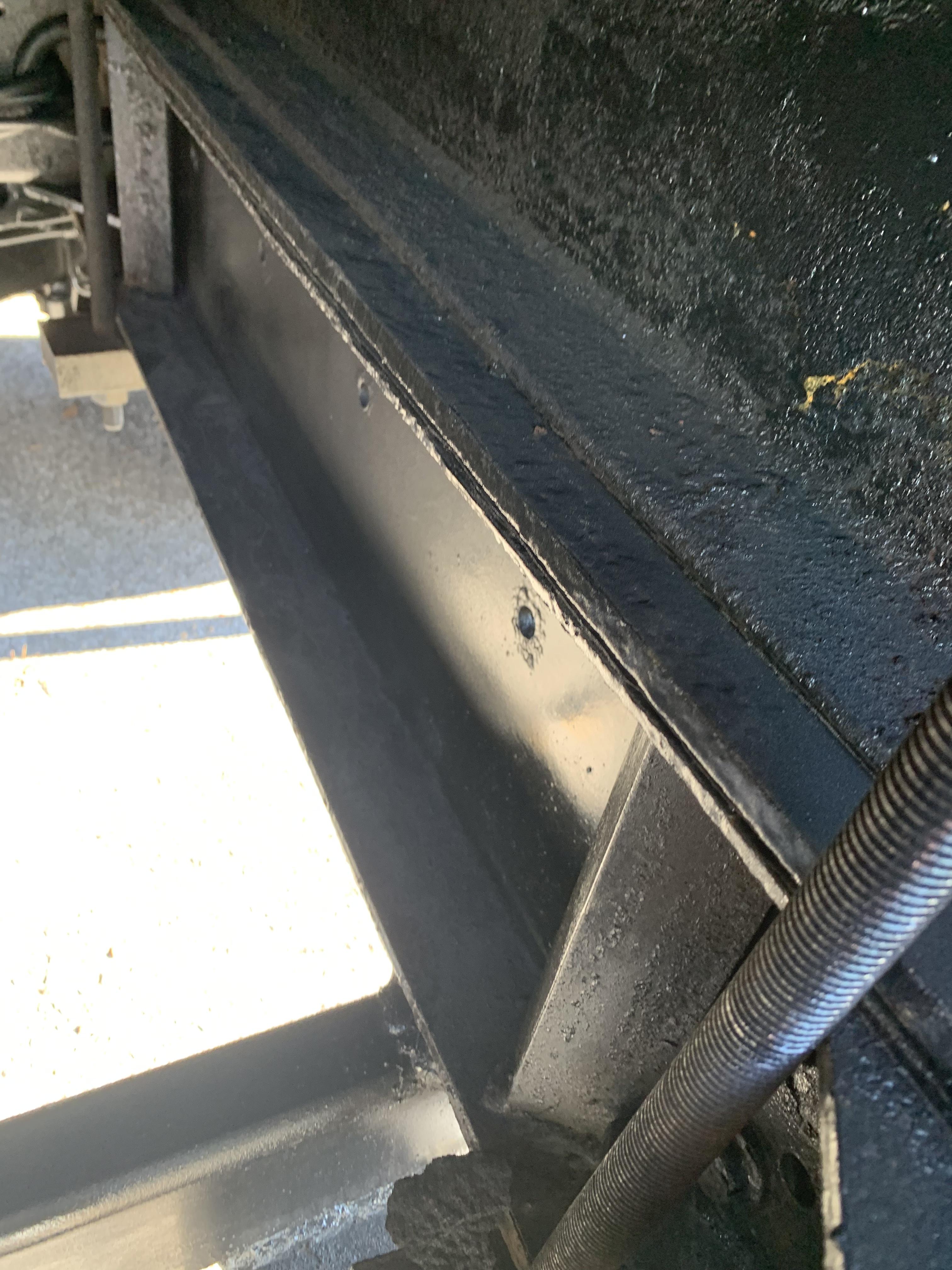

2 hours ago, Firefox898 said:
I’ll have to ask him to send me pics of the motor..but it looks pretty clean, my main fear/ptsd is frame rust..
There’s no rust in that frame,you can tell by the picture of the end of the frame,perfectly clean,that whole truck looks immaculate..
  • 0
The liner is a little spread in the one picture, but nothing serious. That truck does look pretty clean and looks to have been used right and taken care of. Even with the shortcomings of an AMI ??  for the miles you're talking about putting on it and the general condition from the pictures ?  Looks like it should definitely be on the short list of trucks to replace the older one

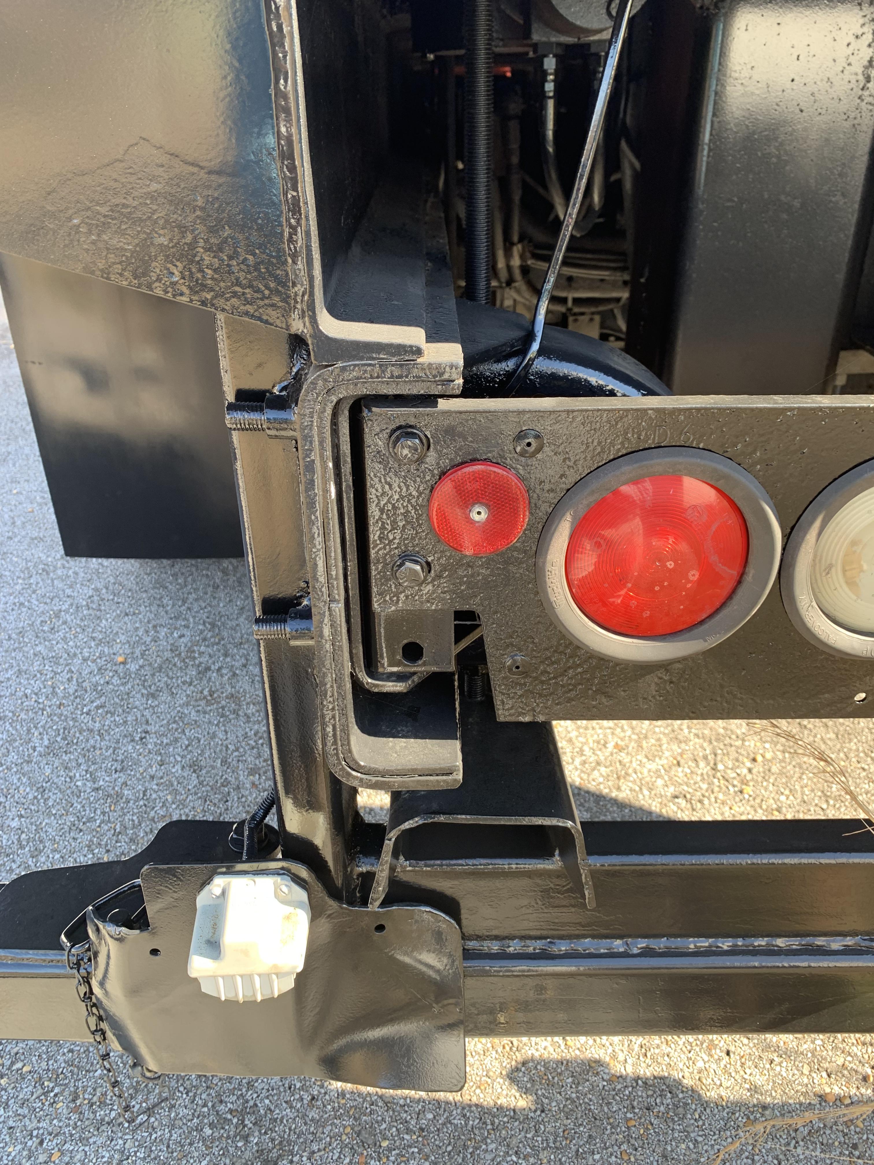

7 minutes ago, Mark T said:
Somebody did a pretty nice job cleaning that up and painting the frame. Personally, I see a few things that tell me it wasn't a basket case before the detail job.  That's a pretty nice used truck I'd say.
That part of the frame looks to be factory with the stickers. Centrimax still has a Mack sticker on it. Def don’t see trucks like that here in PA. Only when they are new and it doesn’t last long…
  • 0
They're taped off before painting.  Somebody went way out to do a nice job on it. It's none the less a really clean used truck .  It does certainly seem to be in pretty good shape, let alone for the age of it. Nice Granite.
