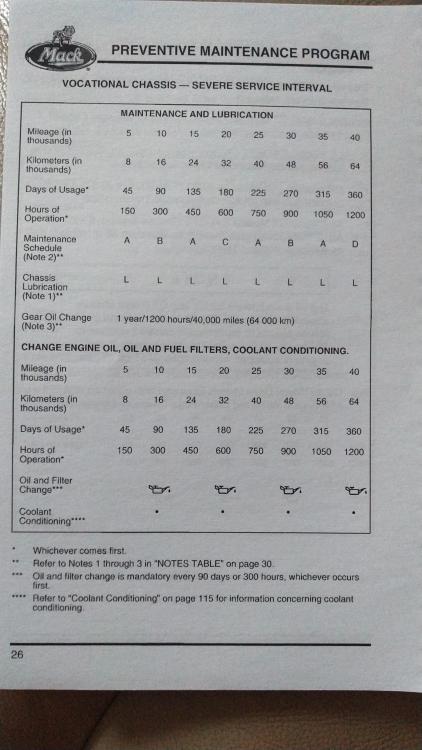

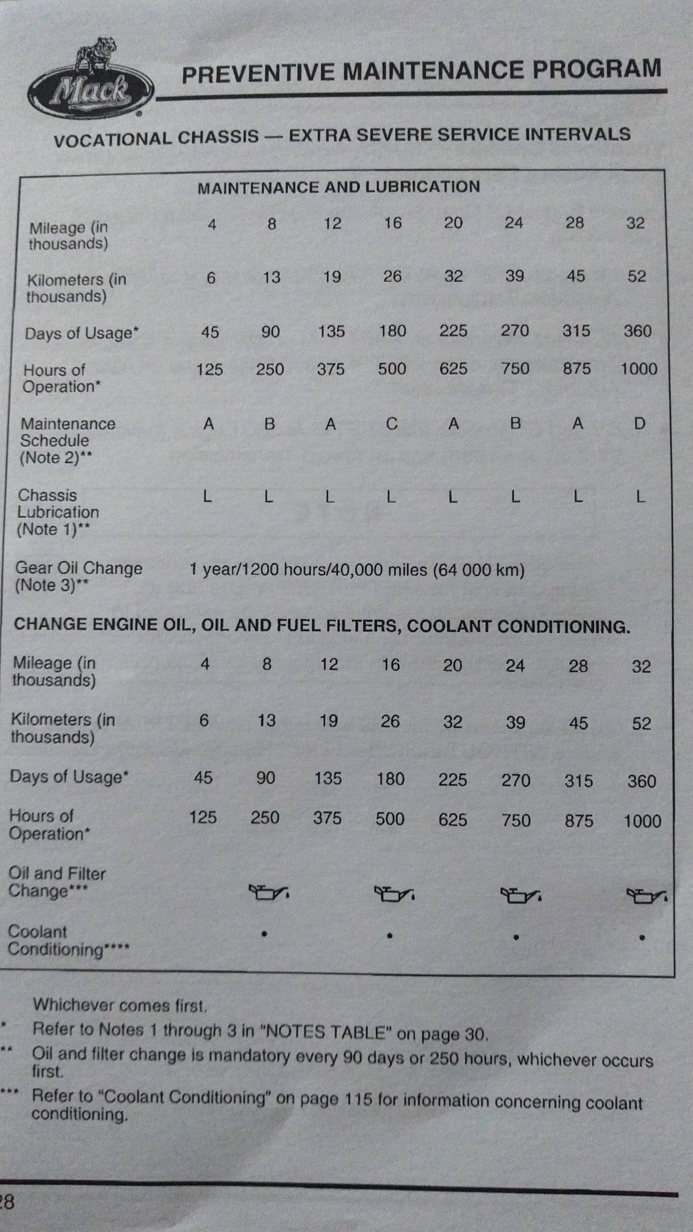

I believe, for your 'service' 150 hours is the interval.  with grease every 75 hours.  300 hrs for oil and 150 for grease may even be closer to what you need for your ' service application'  I will go to my book's and see if I can send a picture... jojo
Edited by Joey Mack
https://www.bigmacktrucks.com/topic/69356-service-intervals/#findComment-491628
Ok.  I have this info.. It pertains to E-tech ASET's however. I feel like this is a good chart to use..  Take note of the duty service at the top of the pages.  I hope this help's ,  Jojo
https://www.bigmacktrucks.com/topic/69356-service-intervals/#findComment-491632

Specially in dust! if you have an under the hood air cleaner you need to monitor this every service as well the turbo moves alot of air during a day these clog up quickly! If you got dual outside cleaners its not as bad! 300 hrs is my go to on a dump!

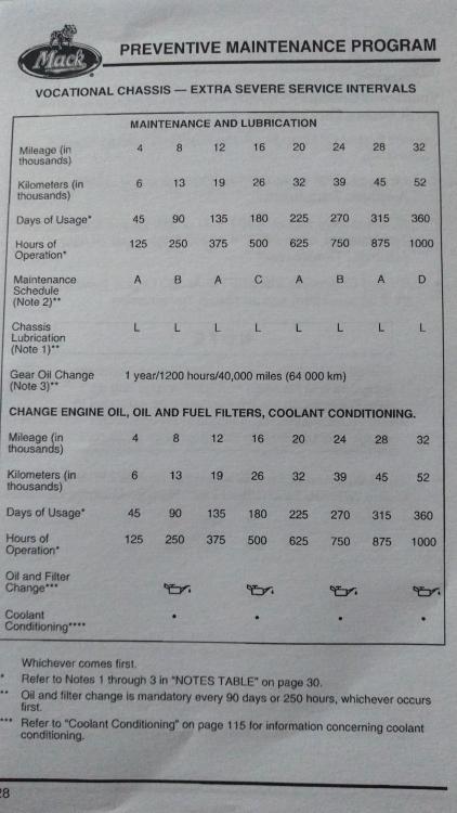

I looked through that maintenance manual , it had no info on it other than what I posted. So I went to an even older maintenance manual.
I was able to find this .
Its interesting to me because I have only seen a couple V8 Macks in my life so I had no idea they had that clip on air filter. My International S series has the same one . I actually didn't know it was supposed to be changed at every oil change .
  • Thanks 1
Keith
