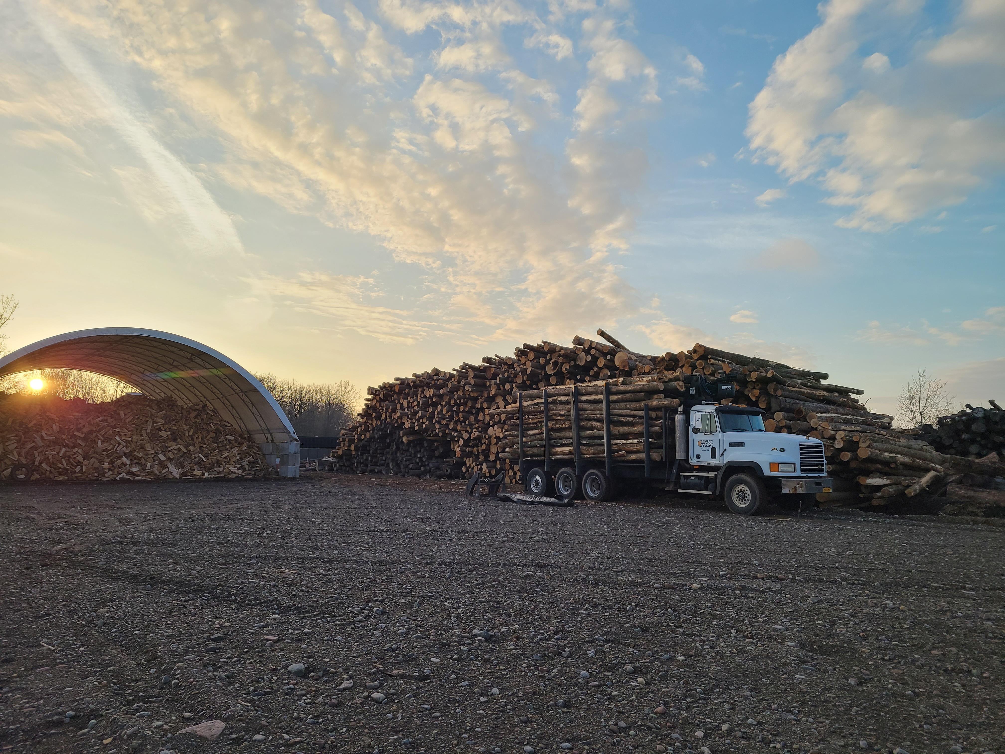

I have been fighting an issue with my 1995 CL 713, E7 427 currently Vmac1.
A few years ago had the FIC module go bad and the truck would shut off intermittently with no warning and throw codes 6-2 and 6-3 (it was like that from the day I bought it). I putba new FIC module in it and immediately solved the issue, now it's doing the same thing and all signs lead to my FIC module has the same issue, it ran fine for 3 years, about 1000hrs(part time truck). The mack dealer is looking into converting from Vmac1 to Vmac2, has anyone here done it? Is it "easy"? I don't want to keep throwing FIC modules at this thing.... Thank you for any input.
