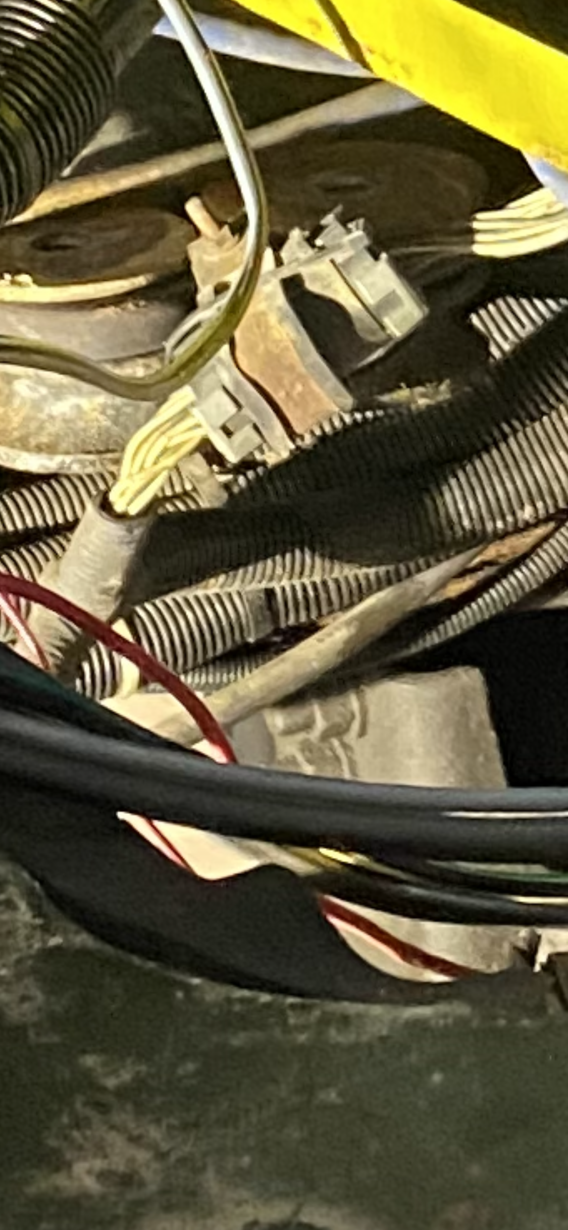

Check to see if there is a rectangular connector on the driver side on top of the transmission, if it does run the truck and wiggle that connector and see if you notice a change in the engine. If it does then pull that connector apart, clean it with contact cleaner and put a zip tie around it nice and tight.

V Mac3 I don’t seem to find this connector any other descriptors ?

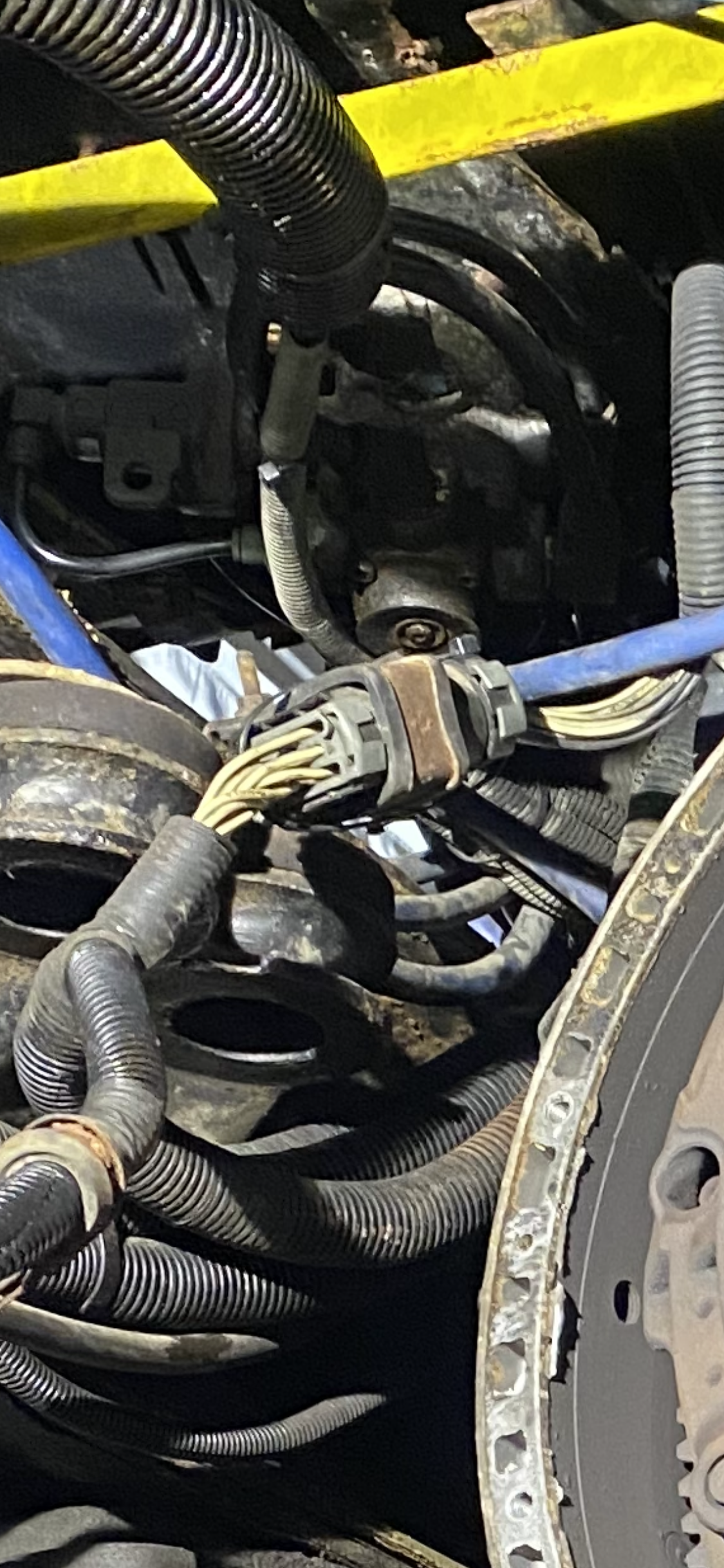

so here is two different pics of that plug at different angles. It’s got a metal bracket around it and is mounted on top of the trans by one of the bellhousing bolts. Did you happen to have any work/transmission work done to this truck before this problem started?
