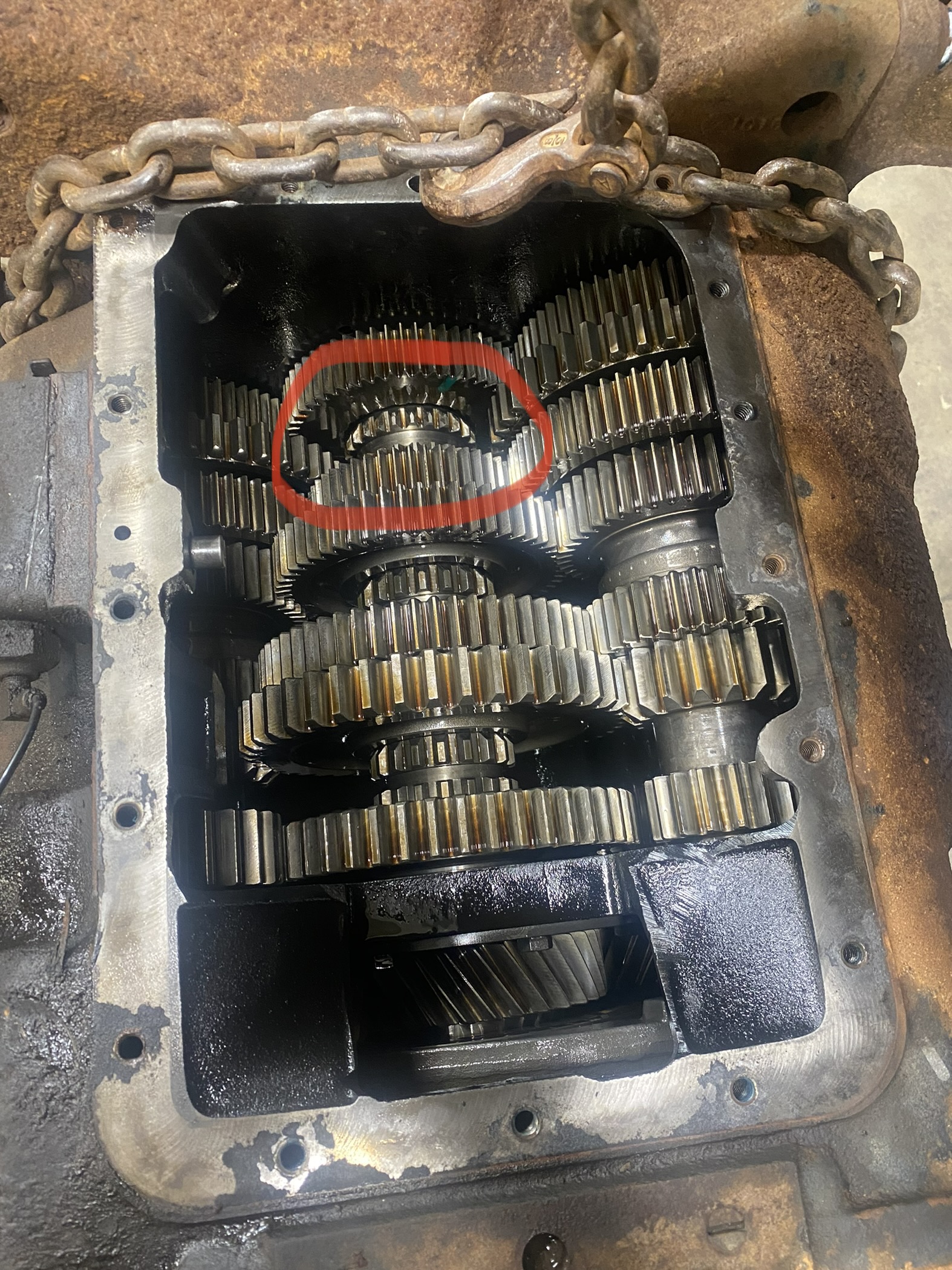

Onyx,  you can pull the input shaft out, then slide the sliding clutch out.  look at the clutching teeth in the 5th/8th speed gear, if they are not chipped up real bad or rounded off, you slide a new sliding clutch back in, check the teeth on the input gear as well, it too is replaceable.. no it is not a perfect repair, but it is a doable one..  no special tools, just patience, and snap ring plyers, no need to pull the bell housing, just be patient sneaking the bearing cover out of it tight spot :) make sure you look for an oring that seals the oil slinger, there should be a spiral slinger machined into the input shaft..  jojo

That was last summer. Just put a new trans in it after talking to the service manager. I was wanting to fix it but I guess he made it sound like a job. That gear would have needed replaced too because it was all grounded down. After stealing the input shaft out of the core for an alignment tool to have I saw how easy it started to come apart. Maybe next time haha.

3 hours ago, Mark T said:
Input shaft and front cover are common things to replace, and are pretty easy. Eaton has that clutch kit comes in a thing like a brief case with all that in there.   A reman 8LL  gotta be around $6500.00 now I'd guess.
Good to know for next time. They are 4k from Mack. Which ours was built by camerota truck parts.
