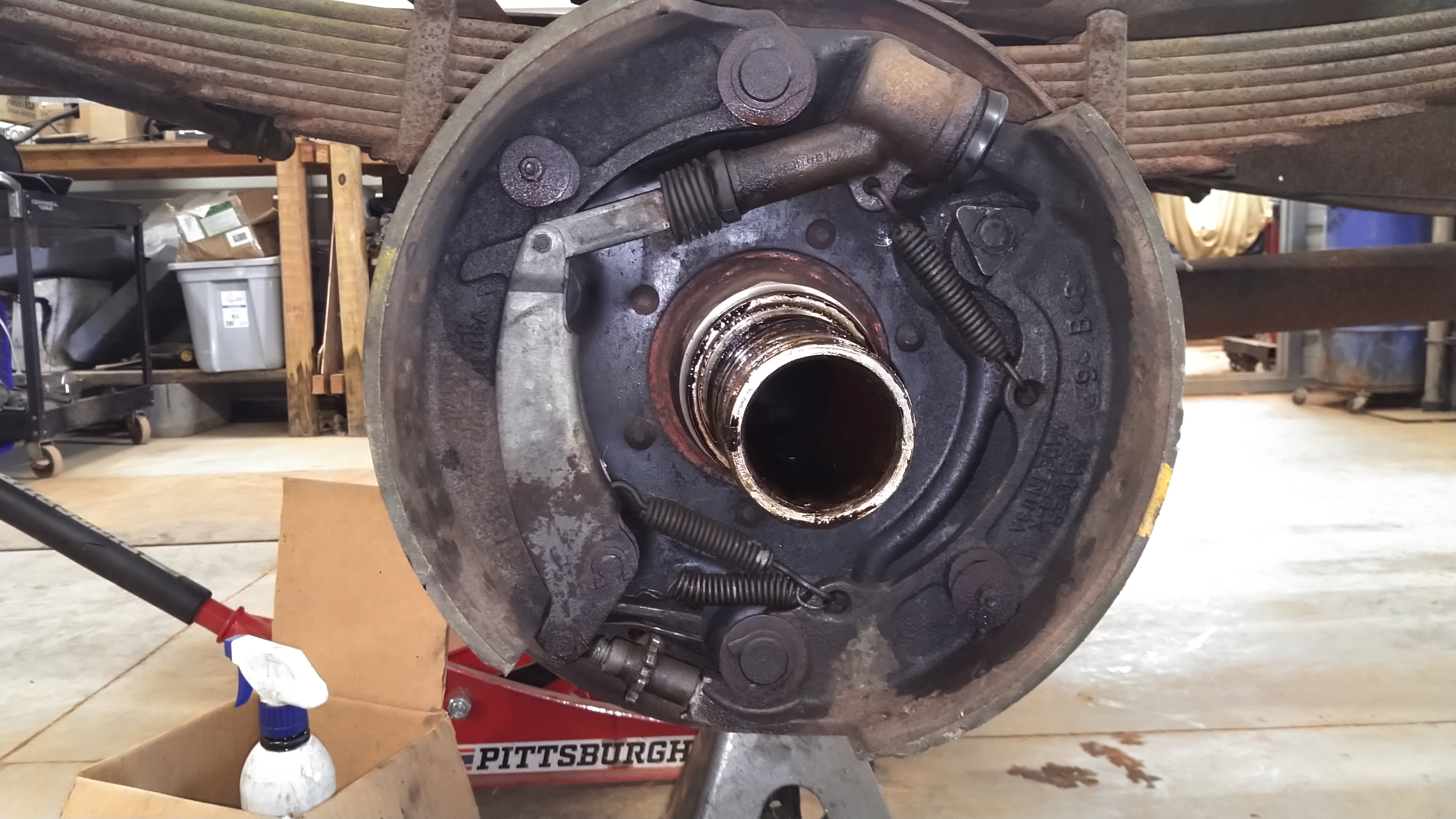

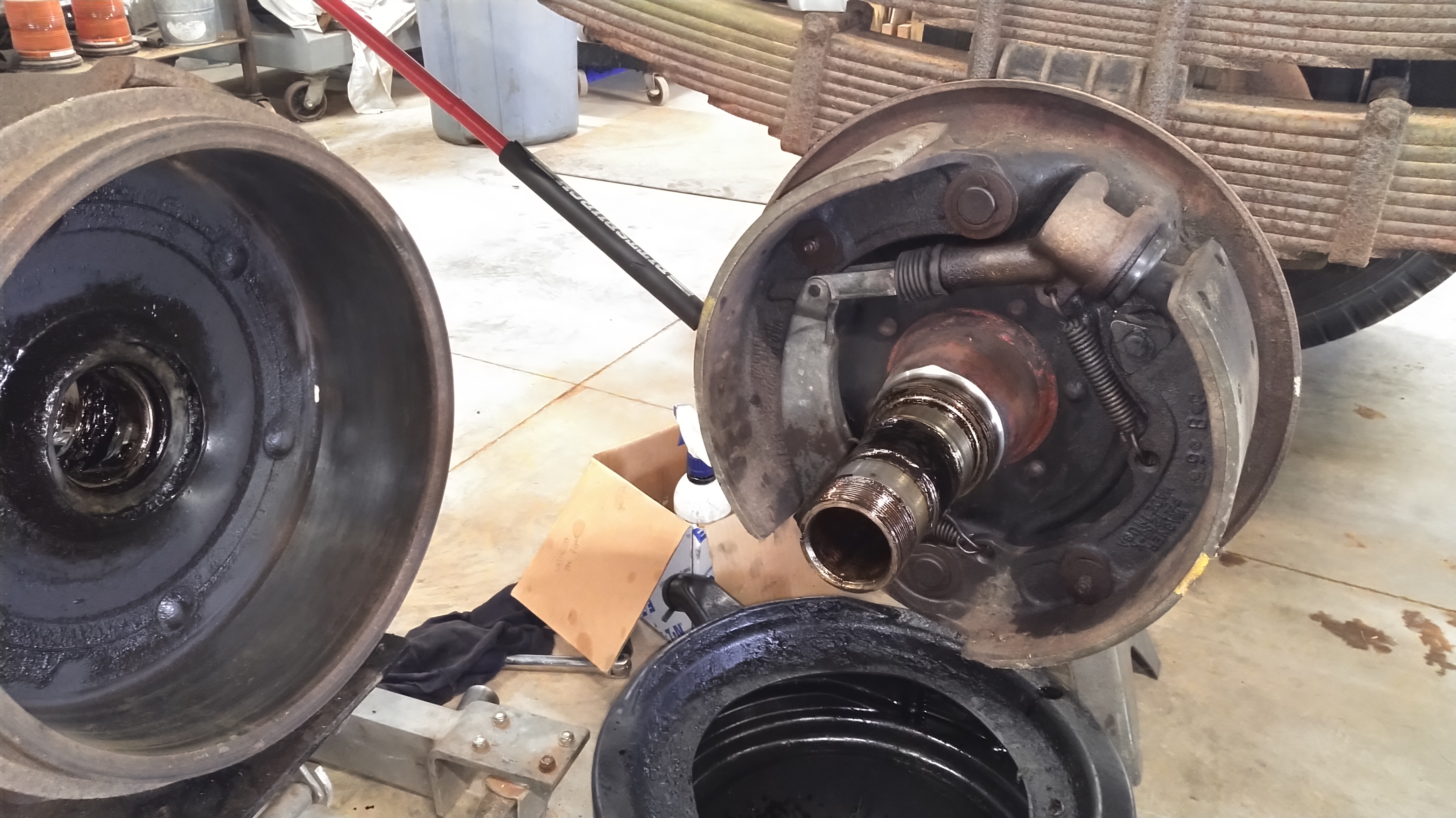

Here's a little more shop talk...  I finally got off the couch, and in my shop and back to work on My '48..   I took the rear wheel off to do a brake job..   All new brake parts were installed by the previous owner, unfortunately, the truck sat un used for so long that the new wheel cyl. froze up, and the shoes froze to the adjusters..  I got the shoes freed up, but there is no saving the wheel cyl.  Heck even the bearings were new...  So now its time to find the wheel cyl's.  Wish me luck..   Jojo

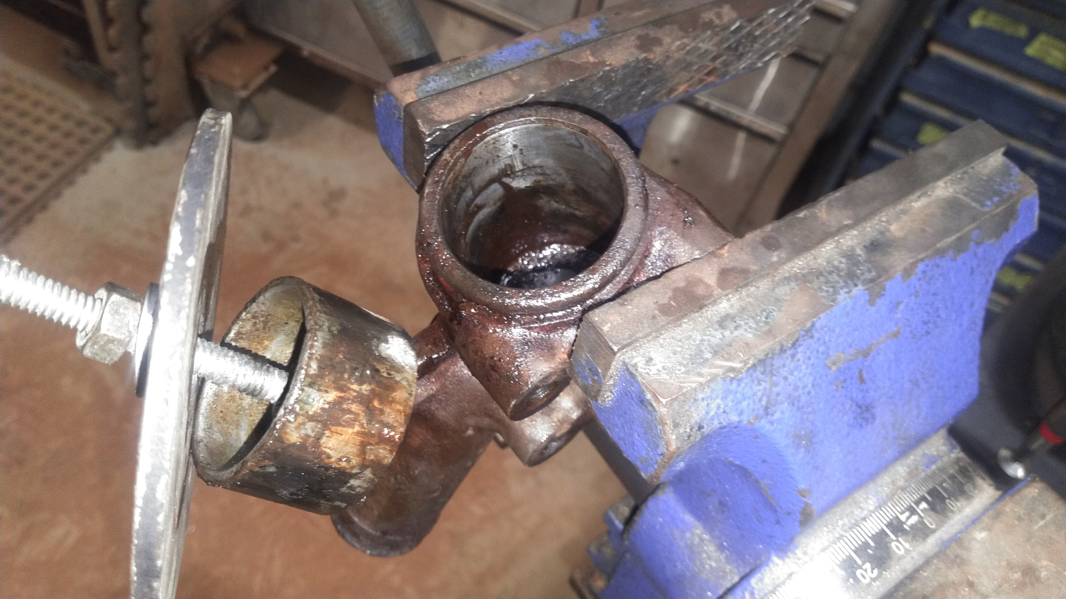

So I tried to take the wheel cyl. apart,  I had to tap threads into one of the pistons and pull it using a homemade puller..   The washer is a Mack rear engine mount washer..  I have a small stack of those suckers..   now to find a rebuild kit..   im on a very tight budget, so I need to go easy...  if I can get the brakes to work, I will be happy. I actually intend on driving it around town often, so hopefully, they wont rust up and freeze again..

Yes to all.. It came off the backing plate just fine..   I just have to remove the small piston that pushes the rear shoe..  I already honed the cyls and they are actualy clean. . once I get the other piston out I will know better..  I havent found kits yet, so I will just use the sizes for each rubber cup.   I think I can make this happen, of course, I dont have the left side out yet, but....   It's all good..   Thank's, Bob..   jojo

They don’t look too terribly bad in the photos good luck but I’m sure you’ll be OK just keep honing until they’re relatively clean. Ha ha I don’t know why I’m telling you this stuff you are the professional most of us are backyard come on????????????
