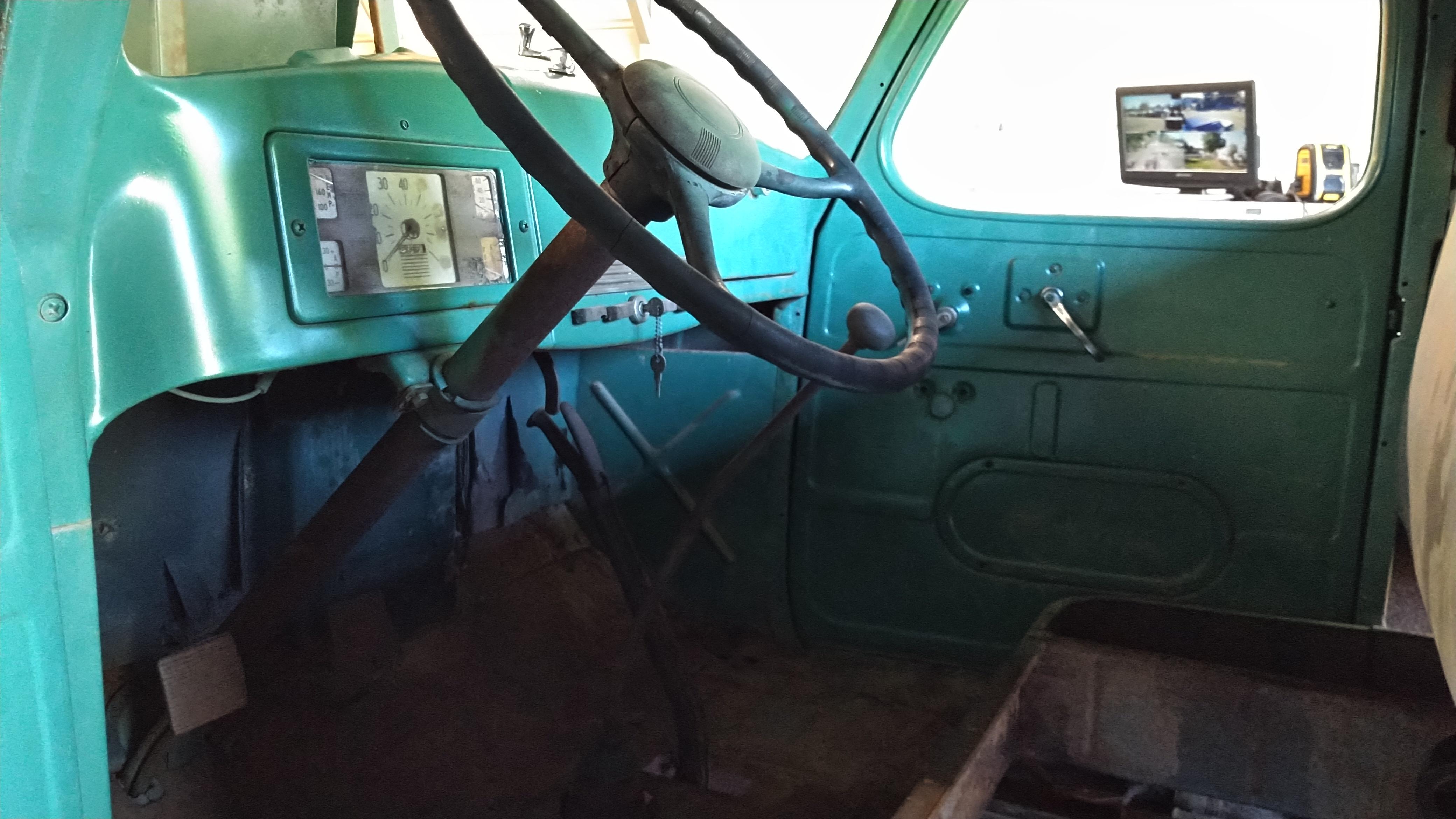

Mech,. My plan is to disconnect the wires and cap them, and leave them in place. You may remember, I was going the leave the old wires in place just to show how it was built in 1948..  I think I'm going to make a swing away gauge panel under the dash, that I can swing up behind the dash at shows, so you won't see my modern crap.. :) jojo
I like class - work like that IS CLASS.🙂

dash is "same book" different chapter. I was thinking of a round speedo set up with other gauges around it . couldn't say what vehicle had that style ;; possibly my '49 EE/EF, . for sake of conversation; wouldn't the amp gauge show backward charge  when pos grd set to neg grd? would still work just read discharge when actually charging.
Amp gage will show backward if it's single post, and grounded through the casing.  But, it it has 2 insulated posts, you can reverse the wiring.

My amp gauge does work. But I figure I will just un hook the wires and cap them..  then make a small gauge panel that I can hide under the dash, at truck shows..   I know I can make a new harness with a modern fuse panel, and get a clamp on turn signal wand, since there isn't one.  It would be nice to find a good horn button assembly for the steering wheel, but if I have to put a button in , I will...

By the way, I thought about how stupid my comments on the amp meter were while I was away from the computer.  I believe ALL amp meters will be 2-wire, because the current goes through them on its way to or from the battery!  I had volt meter on the brain for some reason.  Sorry!  Should be able to reverse the amp meter by swapping the wires.

DC motors are polarity-sensitive in general.  To reverse the system, you need to reverse the cables going to the starter.  The solenoid should be okay.  Lights work on resistance, so they don't care which way the juice flows.  I think fuel level sensors would be the same.  Amp meter needs to be reversed, because it is in series in the circuit.  Volt meter is usually an issue, because many of them were single wire.  I had to swap mine out for a 2-wire, insulated version.  It is in parallel to the basic system.  A 1-wire alternator is easy to add.
I really don't think there is all that much difference in the erosion of the joints in a negative ground system,  That was supposed to be the advantage of the positive ground system.  But...
I'm a firm believer in negative ground systems, because it's easier to add accessories (radios, etc.) to them.
Thinking about the fuel gage this morning.  Depending on how the gage is wired relative to the sending unit, it might work backward too.  If the gage is wired parallel to the variable resistor (sender), it might read okay.  But, if the gage is in series with the sender, it basically works like a amp meter, and would read backward.  Sorry, I do not know enough about that system to know for sure.
