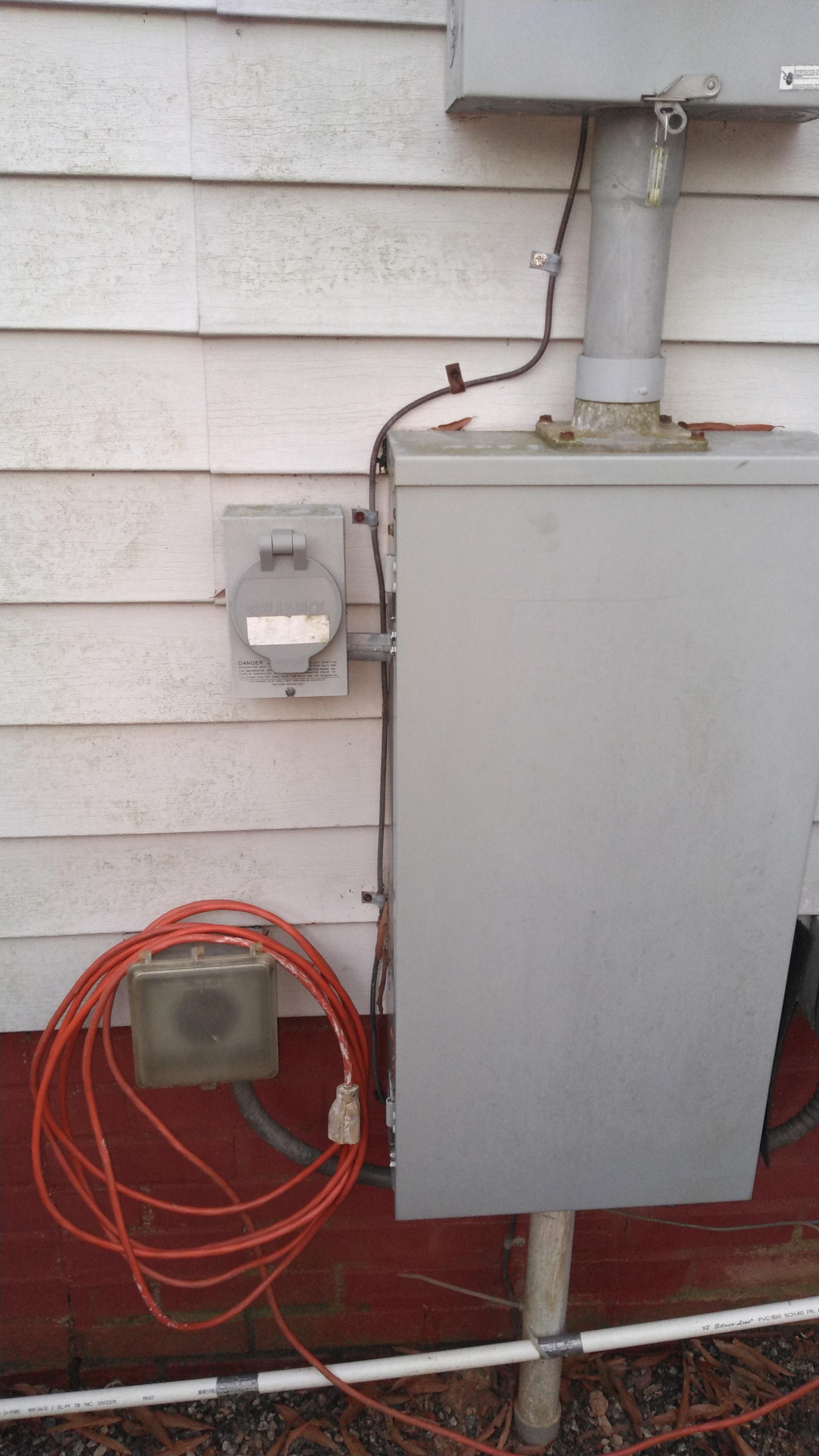

Well after reading this thread a couple of times, I am wondering what could be wrong with my set-up, that my electrician installed?  Of course I am aware of how to flip the switches to isolate my house from the street lines..  I have used this set-up (for 12+ years) more than a dozen times, and over night at least half of those times and never noticed an issue..
 In the picture you see an orange drop cord. That is for using something in my driveway, like a battery charger for my many vehicles, the 220v  socket with the clear door is for one of my welders.  Anyway,  do I need to add something else?  Thanks in advance for any advice..  jojo
Joey Im not gunna tell any joker what they should or shouldn't do
So the common way of doing things in Australia is a change over switch, no one does what you are doing any more,  to complicated for most people to fully understand
The electrical trade is a licensed trade in Australia and it is a jailable offense for unlicensed people to do their own electrical work, rarely does it ever get that far, but plenty of people get fined each year
So a couple of things to think about when Im yammering away here is our voltage is higher in Australia than the US so it is less forgiving when things go pare shaped
Now to generator change over switches, so the way things are done
The power goes out, you plug in and start the genny, open the switch board and flick one switch only, the switch is three position "MAINS" "OFF" GENERATOR"
The switch is on mains, you simply push the handle down going straight past off to generator
You now have power and lights running on generator in your house, there is no need to turn anything off, you cant feed back into the grid, the main switch stays on as does all the other breakers
The supply is restored to your house from the grid, you simply go out to switch board and push the handle on the change over switch back the other way thru the "OFF" to mains
The house is now fully on mains, the genny is still running, idle it back to let cool down and if it's petrol turn the fuel off and let it run out (Joe, you'll know all that part better than me but this how I describe it to people that I have just put a change over switch in and am showing them how to use it)
Once the genny stops, unplug and roll the lead up, no need to switch anything else
The limiting factor in running a house on a generator is the plug on the lead, 15 amp is the biggest type of plug we use in Australia for domestic type of situations,  so that would be a 30 amp lead in the States as your voltage is half of Australia's and NewZealands
Our power circuits are on 20 amp breakers and lighting is on 16 amp breakers
We instal a breaker on generator inlet circuit of 20 amps, this to stop people over loading and melting the plug, even though it is rated at 15 amps running a 20 amp breaker allows for a short over load to stop nuisance tripping when electric motors start
If people want more power for thier house we can install extra plugs and a three phase change over switch and they can run 15 amps per lead then which is more than most people will ever use
This most importantly keeps it safe and it also keeps it simple and makes it idiot proof as well
Even if I know how to switch the right switches and do it in the right sequence, what happens if something happens to me, when cyclone Yassi came thru in 2011 I ended up in hospital with a busted back and wrist so Princess and the boy were left to run the show
So by having it simple to operate they can easily restore power and or carry on as normal if things go tits up else were
Once again Im not saying Im right or the Australian way is right or better, this is just how we do it out here
So a cyclone is the same as a hurricane except it spins the other way, like the water going down a plug hole, it spins the opposite way in the southern hemisphere,  Yassi was big like Katrina all those years ago
Paul
https://www.bigmacktrucks.com/topic/69424-shop-talk/page/52/#findComment-520291
All good Paul,, I was just curious..  I am certainly not pissy..  I always listen to smart people like yourself,  and I also respect folks from other countries..  Lots of great knowledge to be had., the world around..  You make a good point about folks today not knowing how to operate the set-up I have..   Just for the heck of it, I am going to look into a transfer switch..  I hope all is well,,  jojo
https://www.bigmacktrucks.com/topic/69424-shop-talk/page/52/#findComment-520295
