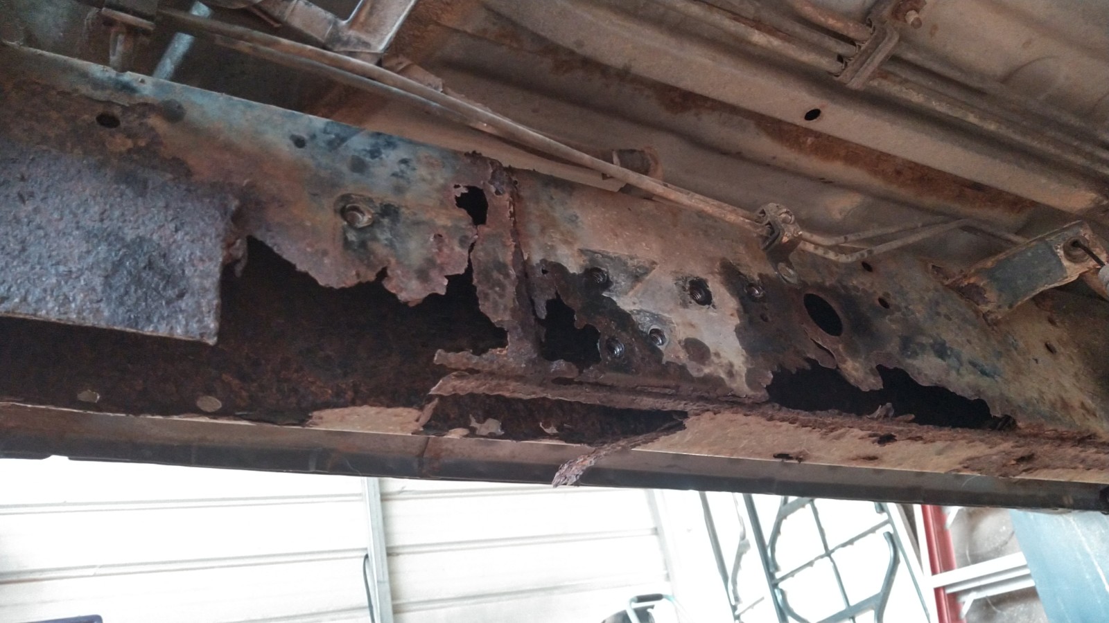

I have a new project...  I have been putting it off for a while now, but it has to get done.. My awesome '97 Tacoma has cancer for the 3rd. time..  I'm trying to keep it together until I can find a donor frame to do a swap..  It has only 190,000 miles, 5spd. 4WD..  Its been a great truck..

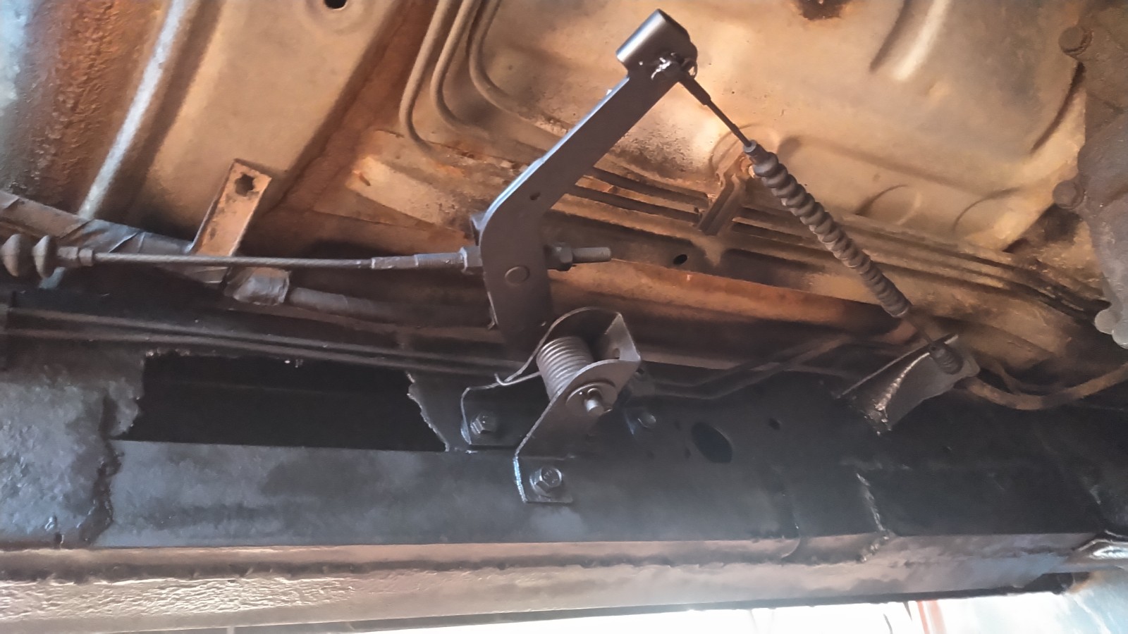

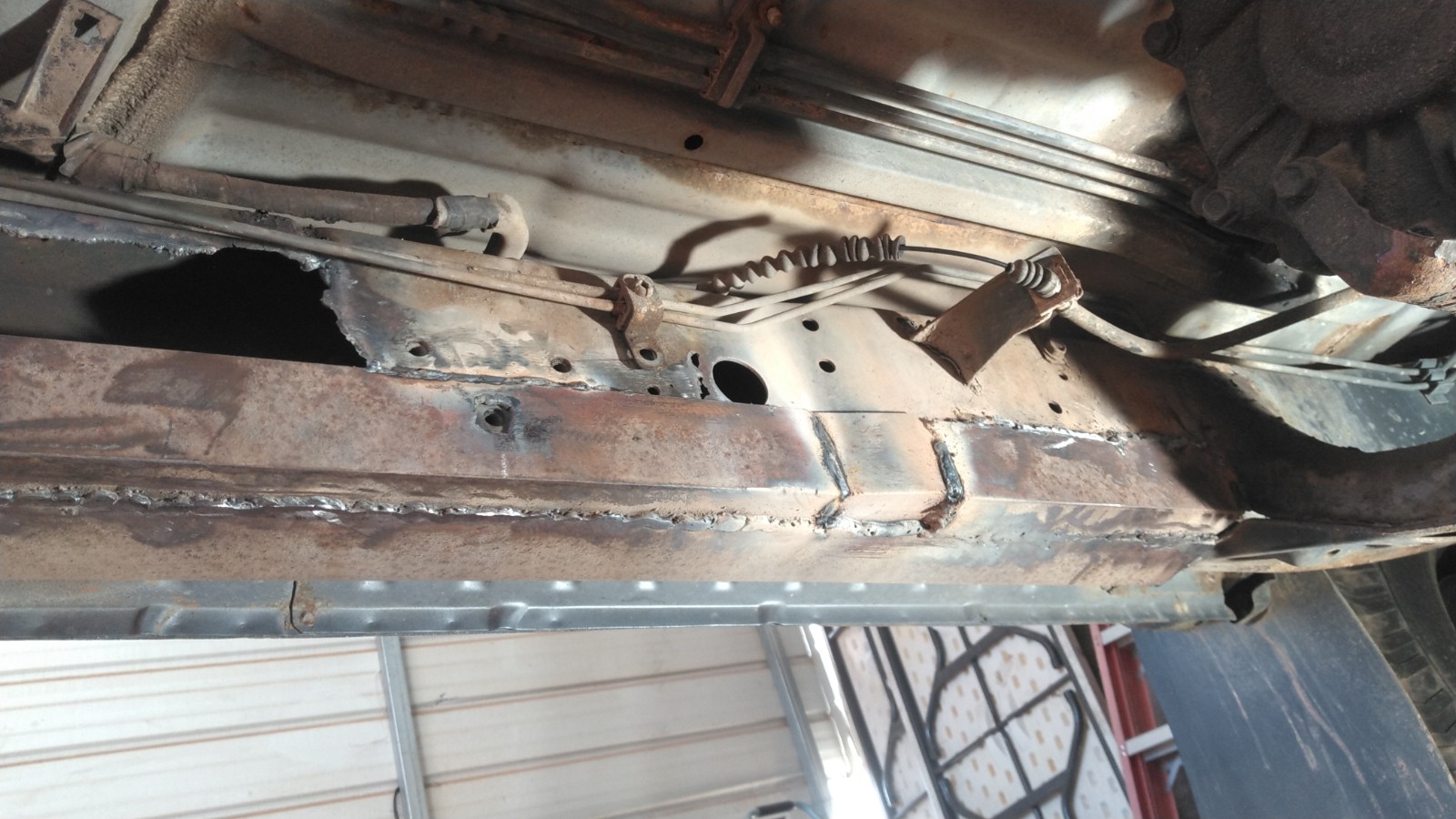

Yes MACKS, it is bad.. many years of winter driving in Maine, really sped up the cancer..  I have fixed other spots 2 times, this is #3..  I put pictures back up so you can see what I have going on..  It was really hard to get a good weld on it, given the tight area and my welder is small, and gasless...  Its not pretty, but she doesnt make cracking noises when driving anymore..

Yes Mecho,  It is a 115 A/C lincoln,, SP 135.. it is 22 years old..  It can accept a gas bottle, I just dont have one.. $175.00 to get a filled bottle.. Its an OK welder, but for some reason the wire feed sucks..  It will feed good and do a good job at times, and then, as you can see in the picture, some of welds look like a row of single beads.. That is what happens when the wire doesnt feed good..  I was laying on my side trying to weld this, but I couldnt see my bead as I welded..  I ended up taking my helmet off to get closer, and closing my eyes when i struck an arc.  My face was sunburned the next day :) ..  So,back to the question..  If you are working with 3/16" and thinner, I think you will like it.  However, the flux core wire splatters a lot.  I have done quite a bit of body panel repairs with it and they came out pretty good for a self taught glue gun operator :)

Bob,  I was thinking about the labor I put into fixing my Yota..  I gave it hell last saturday, and then an hour or 2 after work 3 times, and then yesterday was about 3 hours or so..  I guess I really only have about 15-20 hours in it..  It was also the worst cancer that I have fixed on it..  It's all good...  With the price of used trucks today,  I am just fine with what I did..  It's a releif knowing that is safe to drive..  Thanks again Bud,,   Jojo
