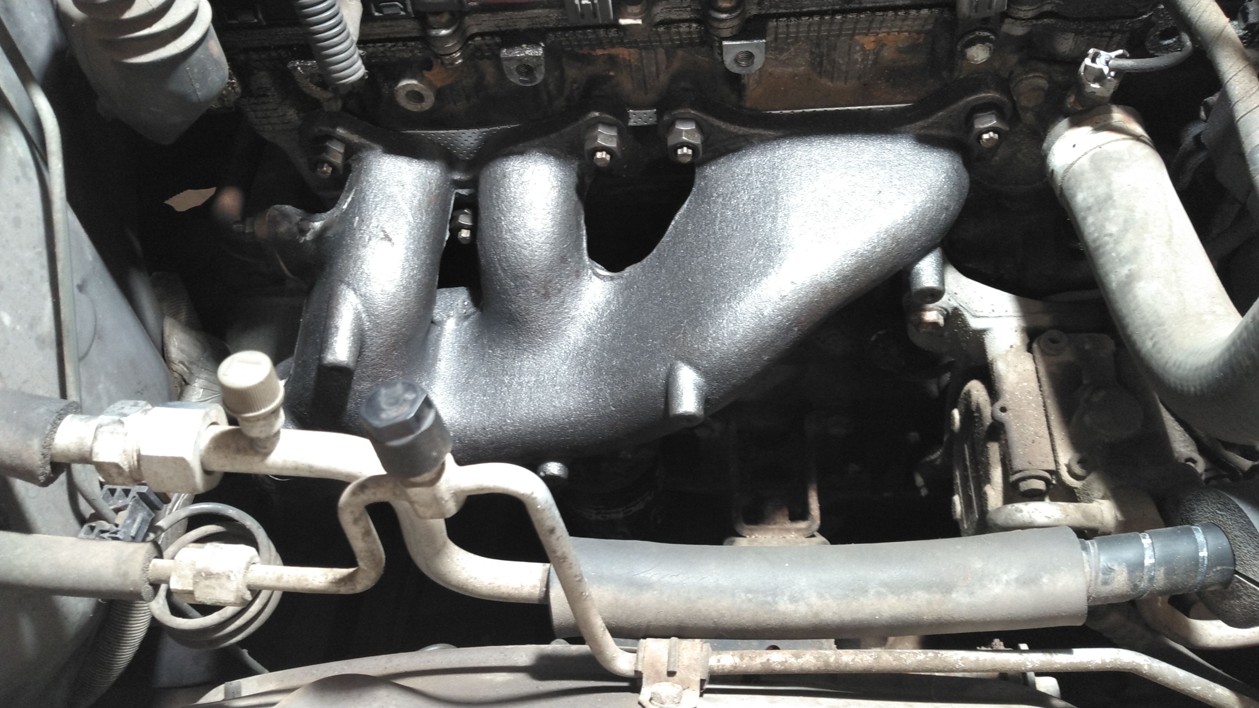

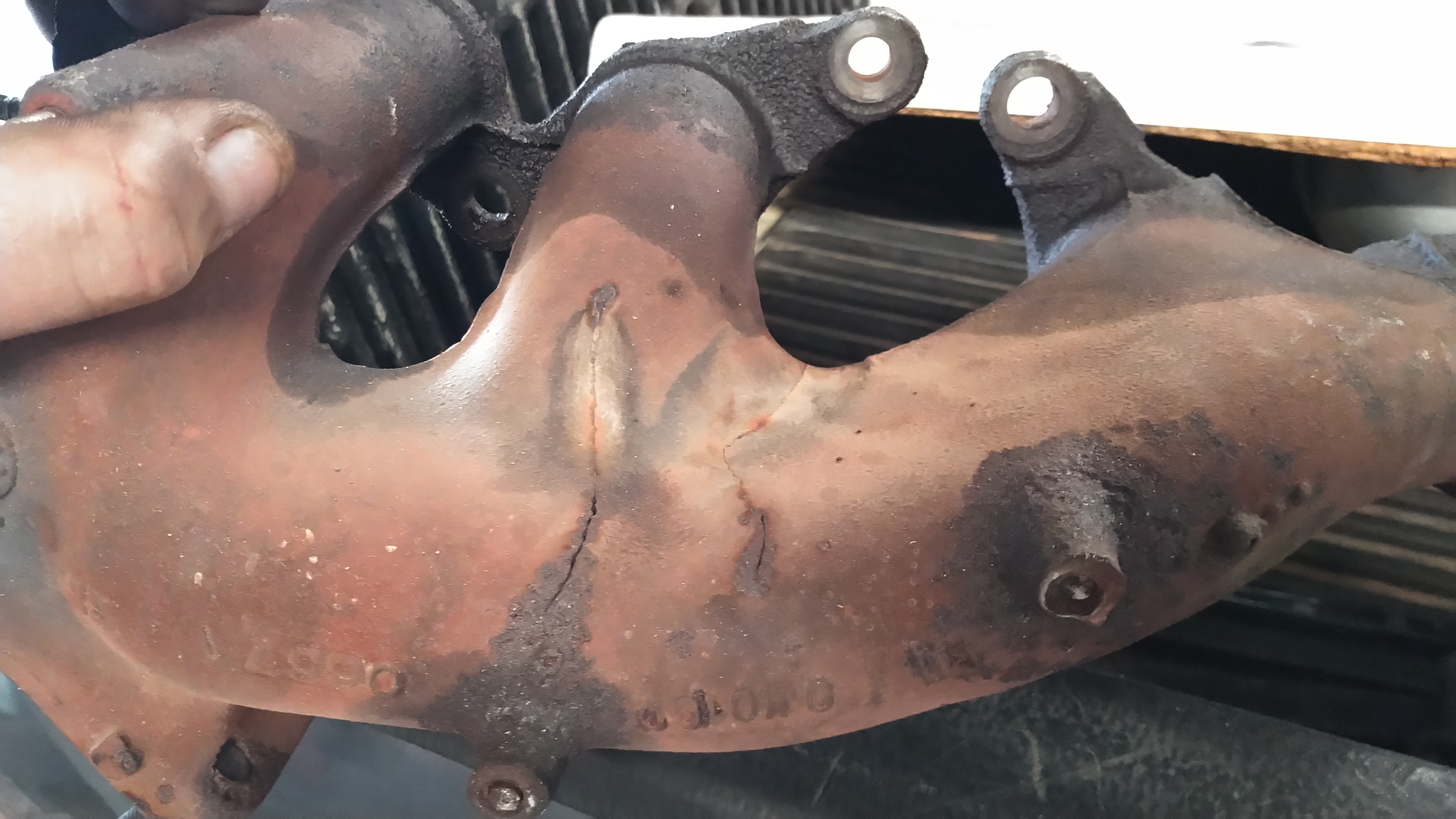

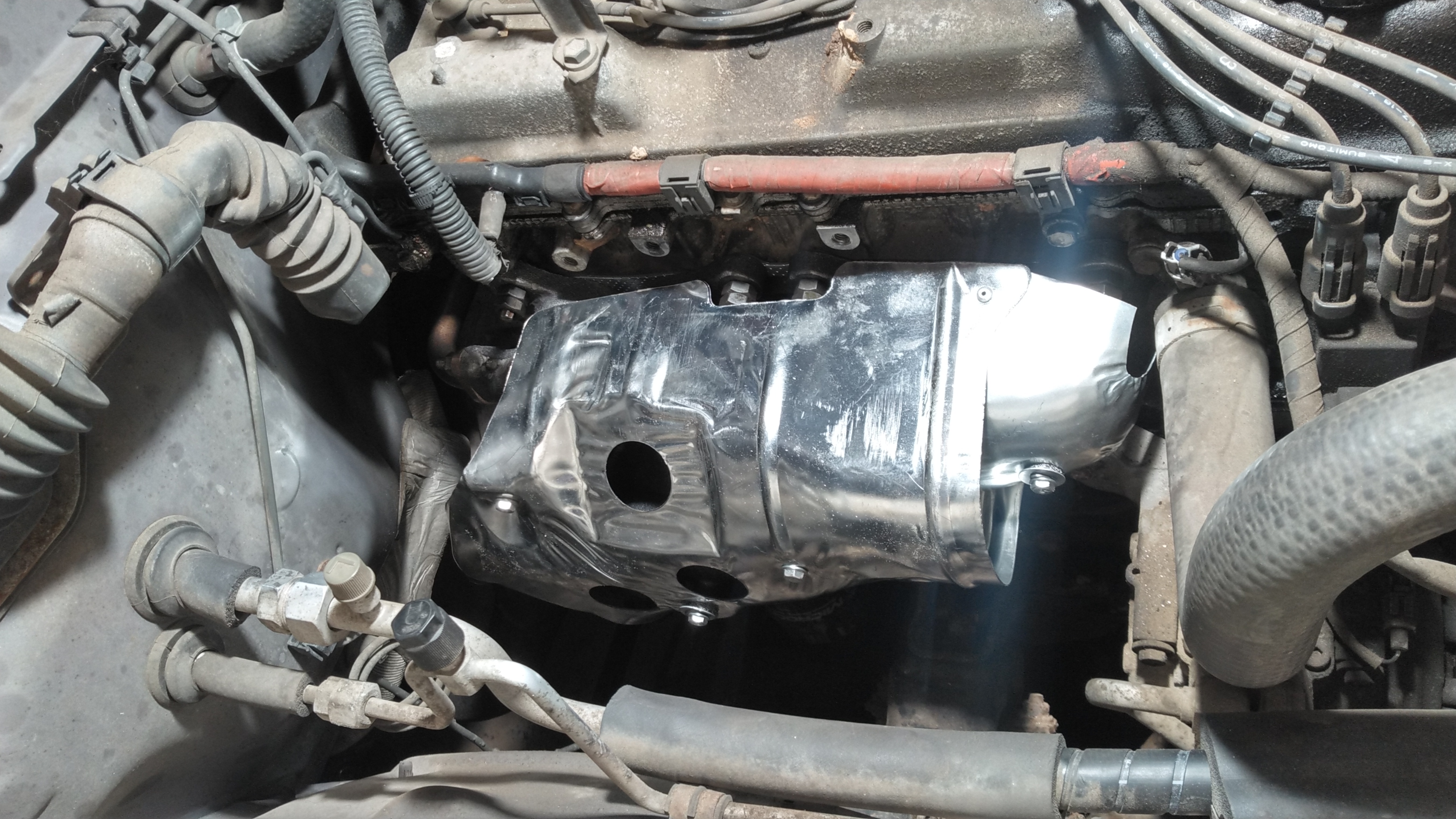

Here's a little Shop Talk..  My awesome Toyota truck has been in need of repair this year..  I fixed the rusted frame, and drove it daily, then was going to get it inspected, and....  You guessed it...   The MIL light came on.. P0420..  Cat. code.  So after a few easy attempts. No luck.. So I pulled the exhaust manifold, back to the muffler to re seal the small leaks I found..   Well anyway..  The Manifold was shattered, but, still together.  I found a Manifold kit with a gasket and sealing rings and studs, on Parts Geek.com...   (China Parts) for $85.00 delivered..  Hopefully all this plus new O2 gaskets will keep the light off..   Gotta take care of my Little Mack Truck...  Jojo

This must be fix you pick up day lol I posted earlier my gmc had tons of problems from a broken exhaust bolt noisy injectors and poor fuel mileage but never once did a light come on that’s what drove me crazy every one said cam and lifters or fuel pump nope just a exhaust leak and ya 150 from eBay for both manifolds and gaskets my truck is a 17 and they were rotted away
