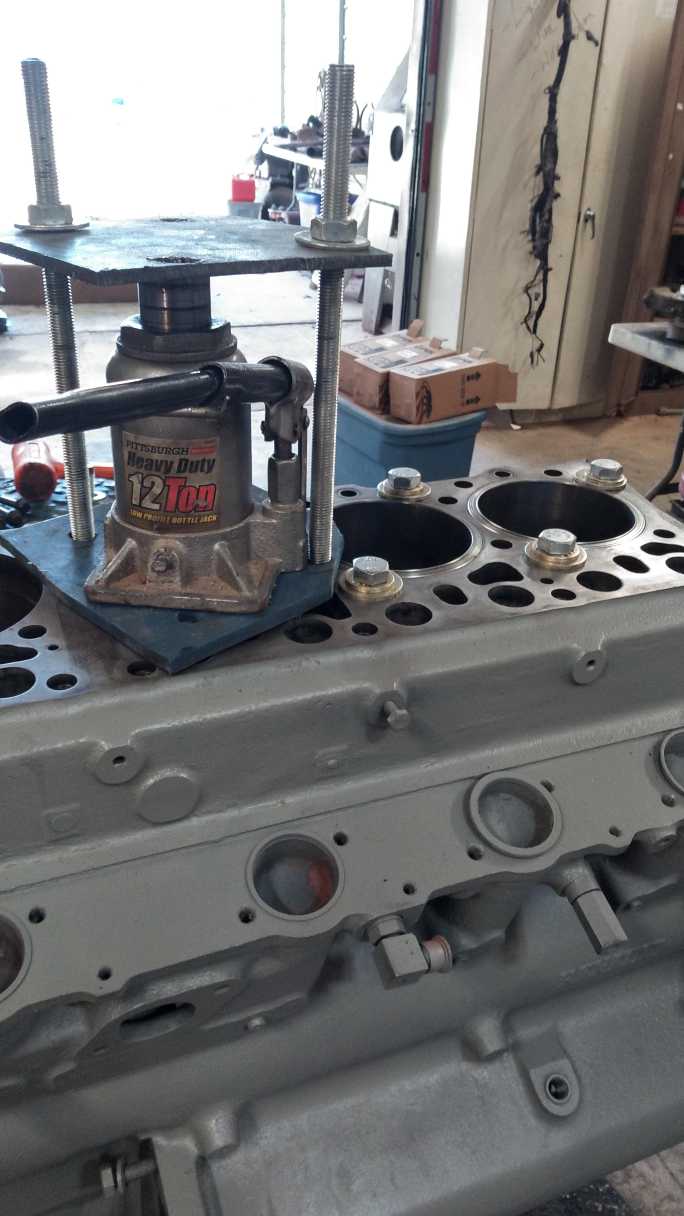

  On 12/31/2023 at 8:48 PM, Joey Mack said:
Alright Mechaholic......    This ones for you..  Here are some of my home made tools.  I have used them many times..   See some of us arent fancy pants..   :) By the way,  ALL of my 7 torque wrenches are ''click type''  not digital, with a beeper..  :)
Any guess's as to which tool is the best one??   :)  She's polishing the crank journals for me.
Expand
unique the spring pin shackle set up. I have/had similar  setup on liner hold downs used for wet sleeve DD . 3 flat washer brazed together  looked like rear view of maxi transmission counter shafts. one bolt the washers held two liners down. relooking at picture two -thought that was a liner tool not a liner with rod welded in middle. are those liners that short now or angle of picture. "new "liners don't go full length of cyl anymore ??? changing times.
https://www.bigmacktrucks.com/topic/69424-shop-talk/page/76/#findComment-544432
i cut a liner short so that i can pull it out with ease..  works like a charm..  I set 6 liners today .. all within .001'' per bank..
The shackle is my home made 'sled gauge'..  I check liner height with it..
