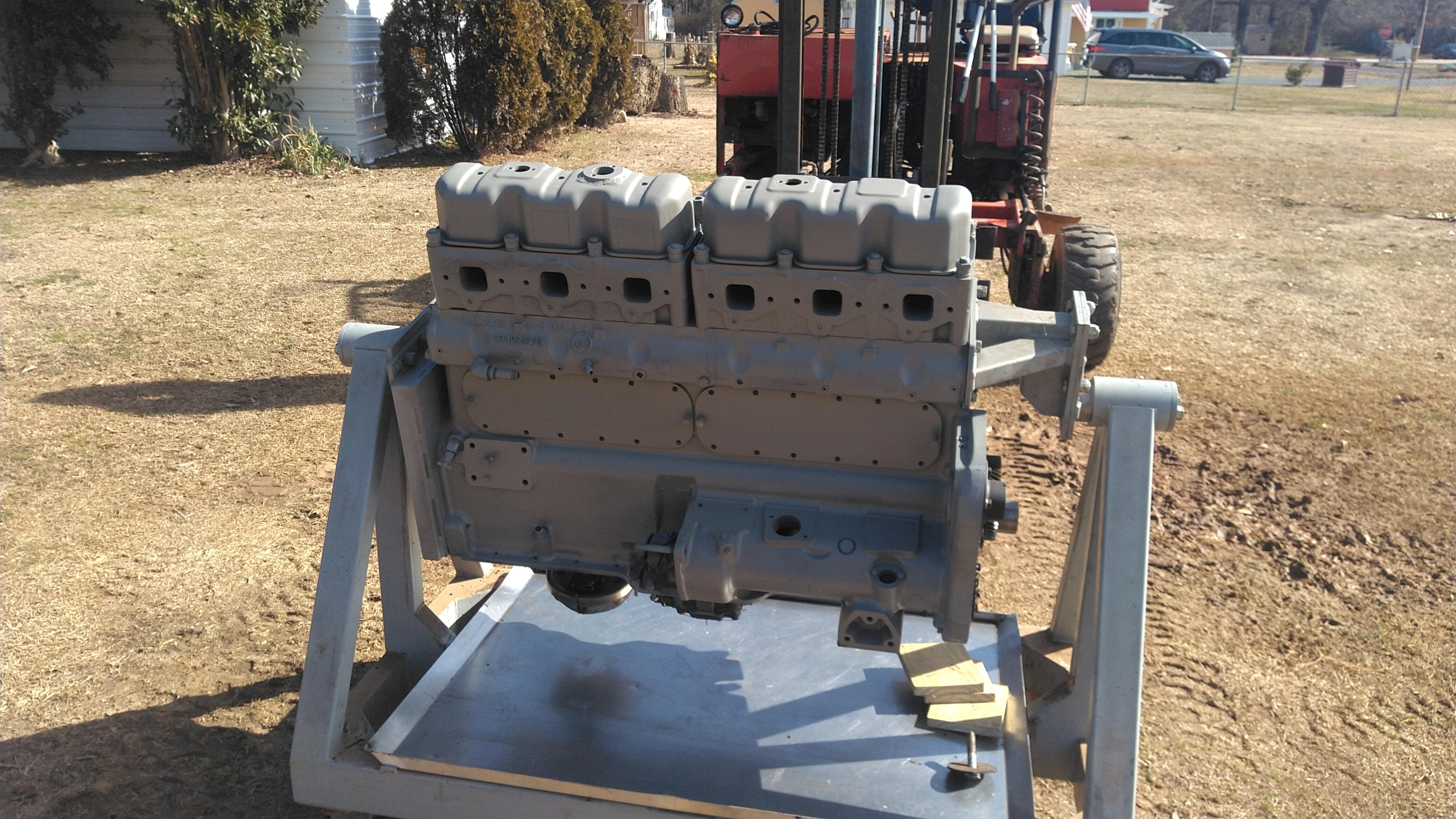

2 hours ago, Joey Mack said:
Well, I had a few hours to get back on the ENDT 673..  Did some blasting and priming.  I also tried to fix the brass coolant pipe. It was dented pretty good, and had a slight bend in it.  I got lucky,  a piece of fence pipe was enough to rough in the round shape, and then I used a wrist pin from a John Deere 3179DF engine to finish it..  The wrist pin was a perfect fit..  I couldnt get it perfect, but I also didnt want to knock a hole or crack in the pipe, so I stooped here..

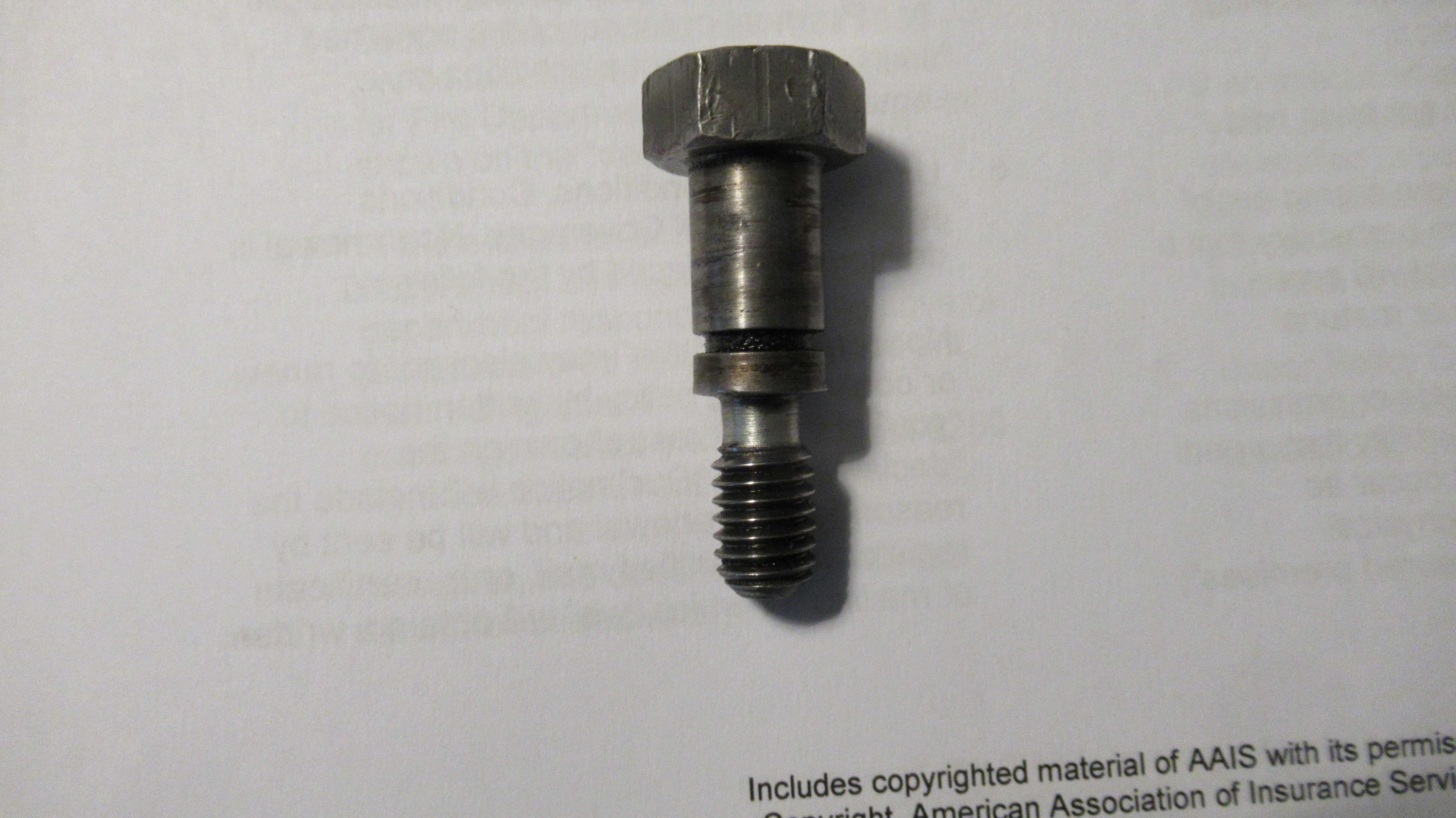

Lookin' good. I didn't see the valve cover bolts in the pictures but have a question about them. I did valve cover gaskets a few months ago and noticed the bolts have a groove in the shank and am not sure what it is for. Is there a baffle that goes over the rockers? Or I thought an O ring but the bolt bottoms out before you get to that part.IMG_1169.thumb.JPG.bc0e31f9dc58c877b0b938aae1b60a5e.JPG

that groove has been on hold down bolts far as I can remember  (NOT  a good comparison  I know); fiber carbon washer under side of hold down bolt between cover and bolt head with a slight amount of sealant . sealant for lube movement . have seen and installed bolts with new washers only to have washer tear apart being installed dry.
https://www.bigmacktrucks.com/topic/69424-shop-talk/page/77/#findComment-546076
was there ever a snap ring in that groove to keep the bolts from falling out of the valve cover when loosened?  I don't know much about the small details of END's.  This is my first full rebuild.
https://www.bigmacktrucks.com/topic/69424-shop-talk/page/77/#findComment-546078
if ever a snap ring was installed on the hold down bolts by factory new ; it was eliminated years ago. is the first END build on a stand or in frame ????? taxing the brain cells once again ;;;; can't remember first full rebuild ; hate old age ;; remember a few outstanding full builds, can't say first.

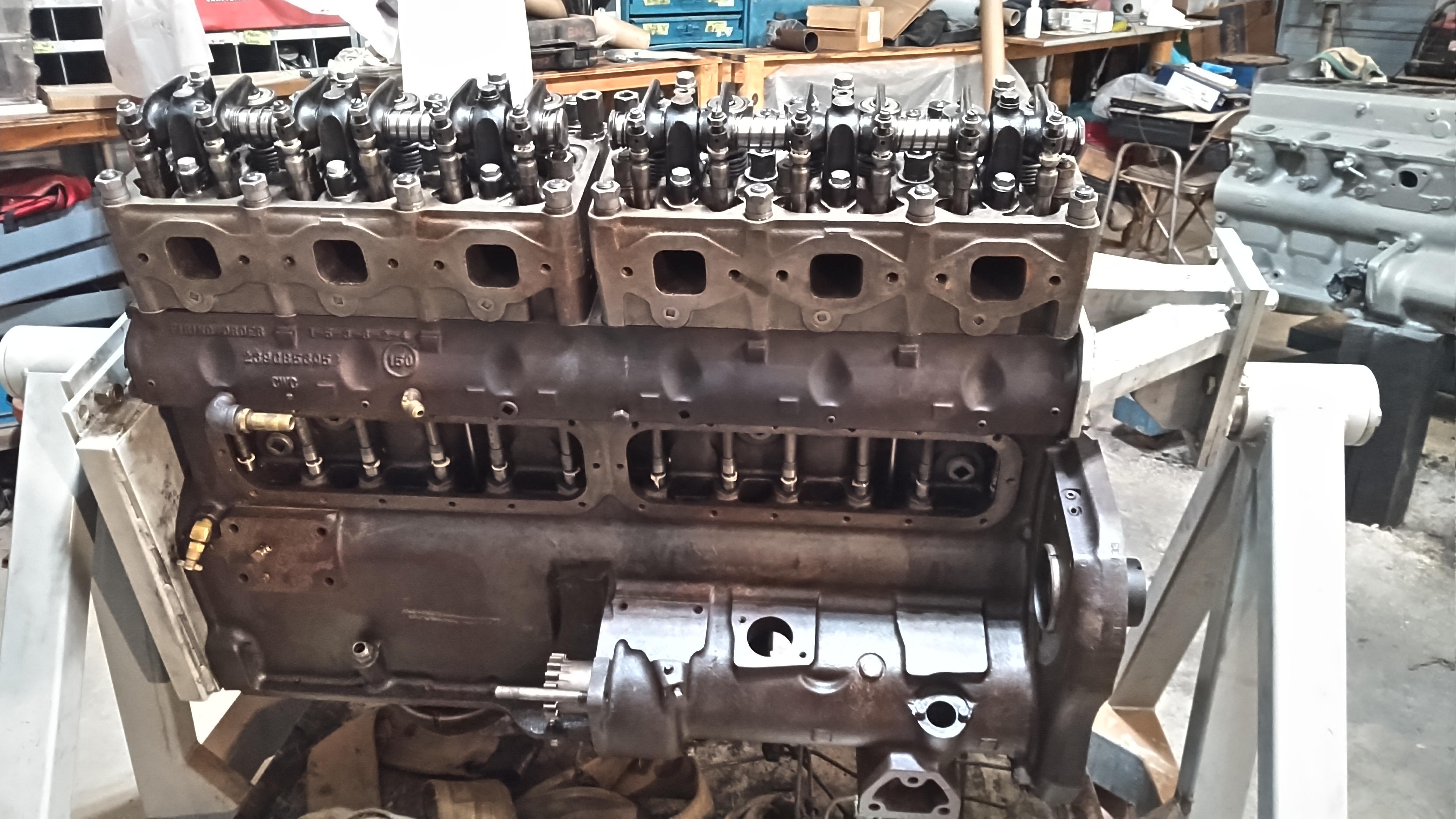

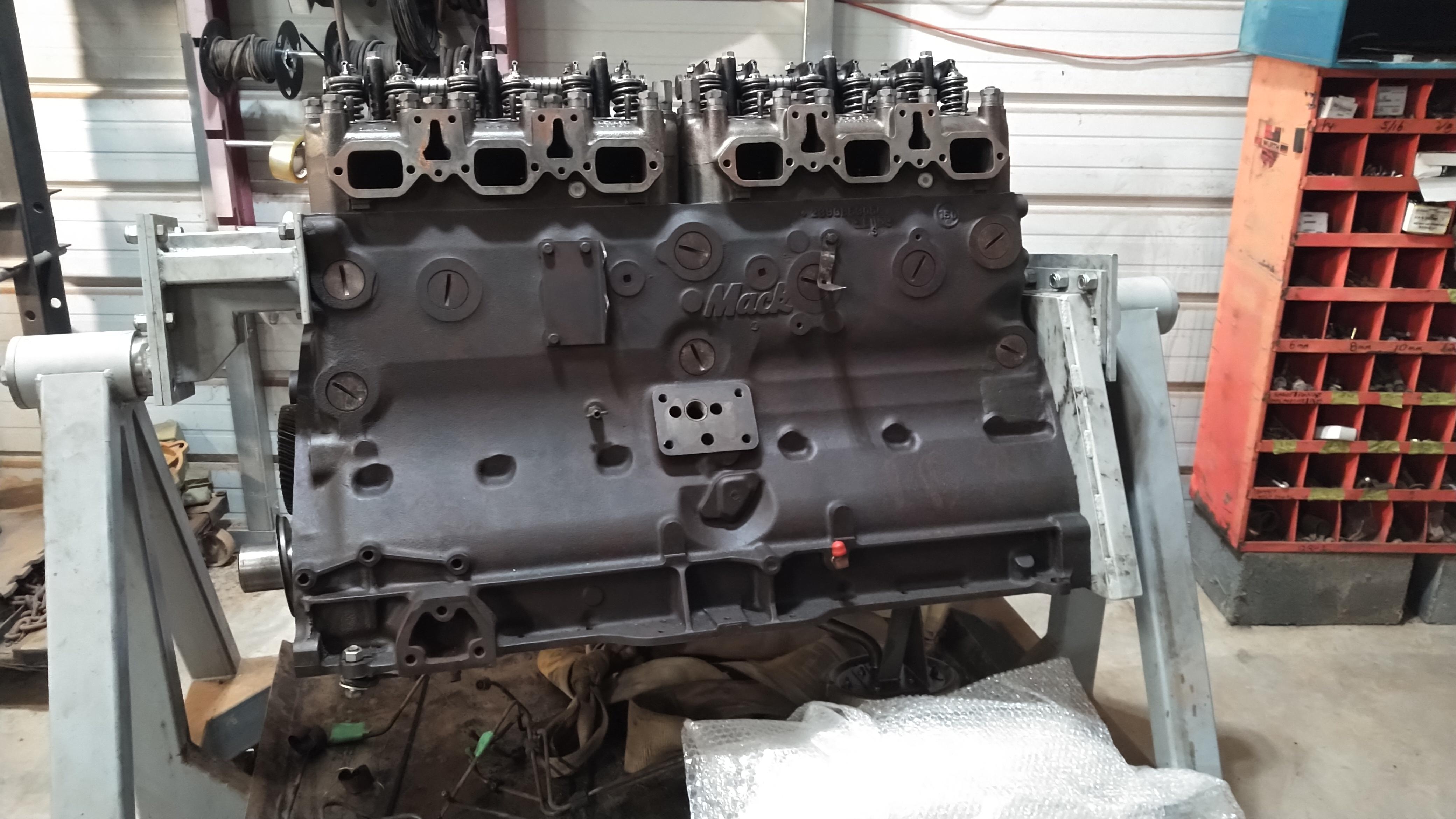

4 minutes ago, Joey Mack said:
I have to rotate it with an engine crane and support it with jack stands, otherwise it will spin around and kill me if it hits me. :)
can you get permission to drill  a hole on  end supports  then rotate turn table and  drill  through support hole into turn table pipe  random spots. when engine installed can rotate /line up drilled hole / install pins ??
https://www.bigmacktrucks.com/topic/69424-shop-talk/page/77/#findComment-546085
or knock some sense into you.........🤪

I can do what I want with it..  The owner doesnt want it back..  He said it's a P.O.S.   I still want to buy one like the one in the background.  much better and safer to use..  and,,, TJC,,  My wife tells me that God didnt give me the sense he gave a Billy Goat..  So I guess I will just stay stupid..   :)

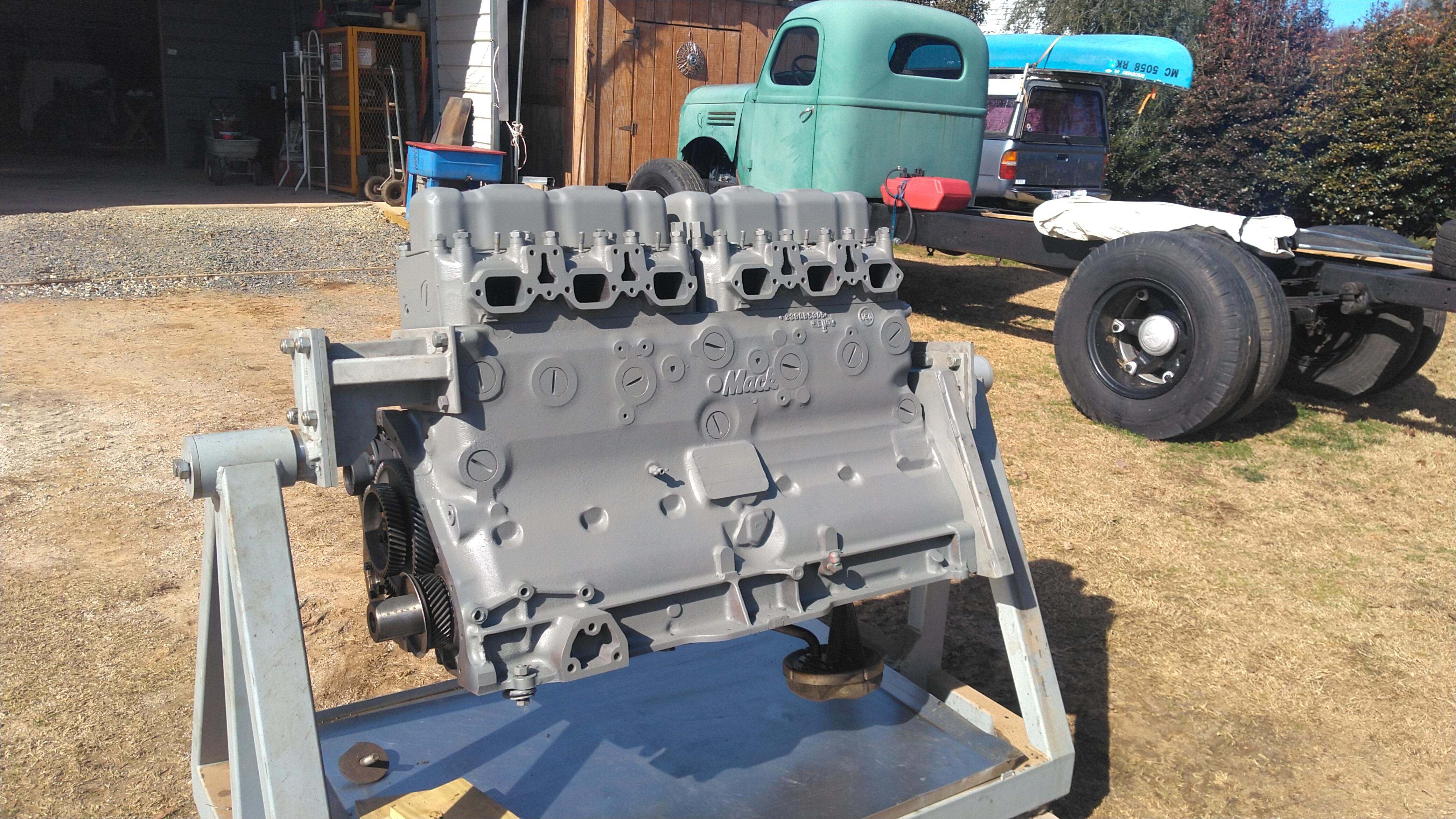

I got a bit more done today..  I'm pickin' at this engine while waiting for parts for the other one I'm doin.
and, NO.. I did not leave it outside.  I just brought it out for good pic's..  :)
Nice job buddy! Pop that b housing  pan a front cover on and your done! Or are you building a complete?
https://www.bigmacktrucks.com/topic/69424-shop-talk/page/77/#findComment-546123
yep,  I need to take it off that stand and put it on the wooden engine pallet so I can get the flywheel housing on. I also have to put the injection pump coupler together..  The book i'm using is just 'ok'..  the assembly sequence is not very clear.  I pick at this one between chores and the E-Tech that I have on a stand.  as you know..  I am expecting the new lifters for it soon.  Then I can do the cam bushings and get the cam set installed, run the valves, and get the 3 covers on that one..  I use heavy plastic sheets and magnets to hold the plastic up to protect the open bottom end in the shop.
Thanks for the comments.  I hope you get a good outcome with your tractor.  Jojo
Nice thing with the e6 you can use cloths pins to hold them up! While the side plates are off!
