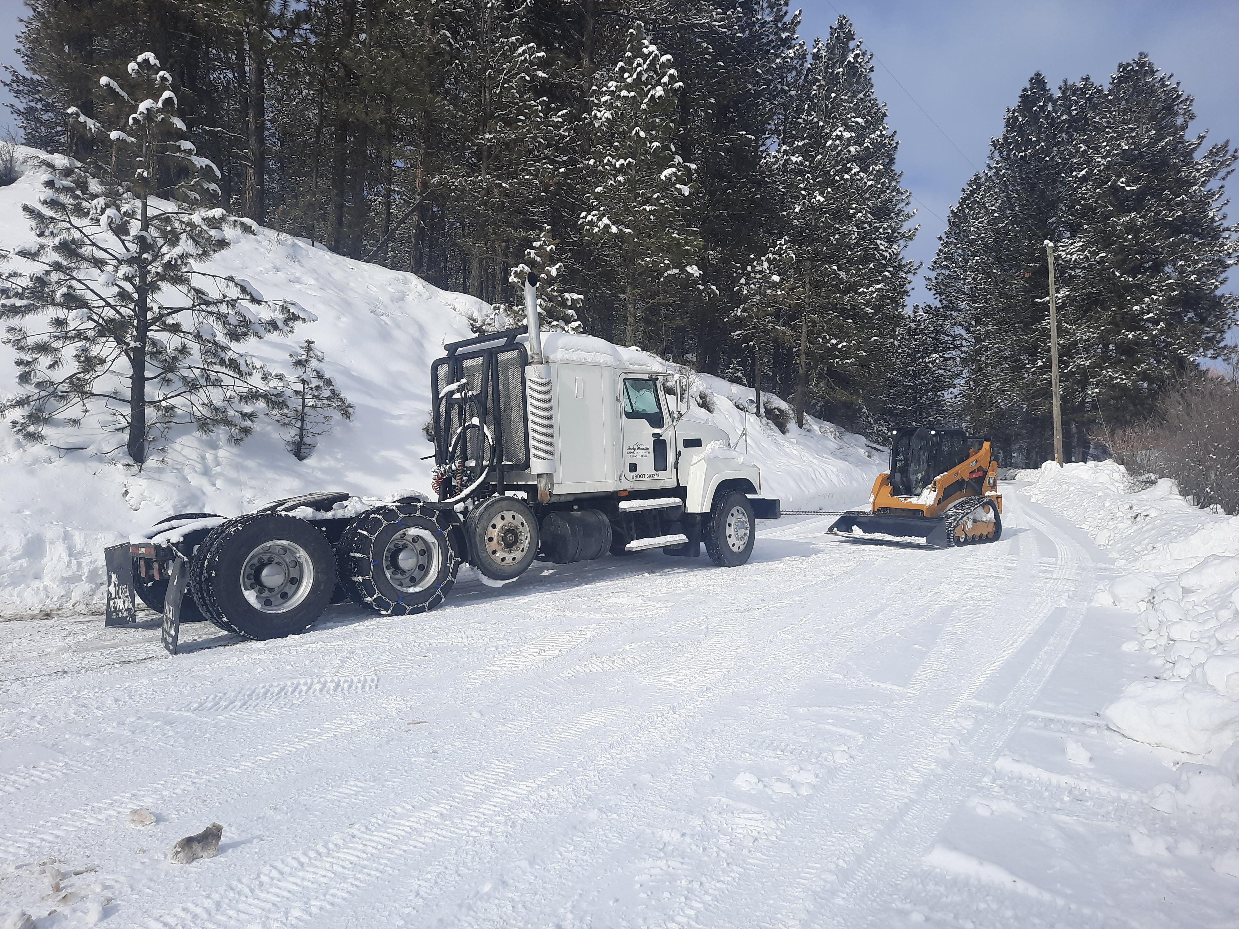

I bought this truck a few months back, prior to winter setting in. I live in the central Idaho mountains and it gets pretty cold here. I parked it prior to winter and was firing it up every week or two. I went to fire it up one cold morning (-10F), it fired and ran sluggishly for a bit and died and would not re start. Solid crank, no fire. I had dosed it, it was not gelled. I did however seem to think I noticed ice in the bottom of the tank. Thought maybe I sucked up some water/ice.
It is now 57F out for the last week or two. I have changed both fuel filters, siphoned the tank completely filled 80% with fresh diesel. And cannot get it to fire.
I have tried over and over to make sure all air is out of the system. I've cracked lines all the way to the fuel pencils (I guess they are called, youtube said so). I've pressurized the tank with air. I'm fairly certain prime is not the issue. It will fire on ether. No smoke out the stack. Fairly certain it's just not getting fuel. I called the dealer. Gave them my VIN (009015) looks like I have a mechanical low pressure pump, the one where my secondary filter and prime button are and then have individual high pressure pumps at each injector..?? Is this the EUP thing? I don't quite understand that portion of my fuel system yet. I'm learning. But I don't believe they all quit at once. Are these mechanical pumps prone to failure? However I had pressure at the head when I cracked the fuel pencils.
Could it possibly be electronic and something is not signaling these EUP's to fire? Do they work like that? Could it just be a fuse? I've not been able to find a bad fuse. I do not have an owner's manual nor can I read the inside of the cover for the fuse block in the engine bay. I've also checked all the fuses behind the cover on the passenger side dash.
I have also noticed that my fuel gauge is not registering fuel. The tank is nearly 80% but gauge says E.
Help please!

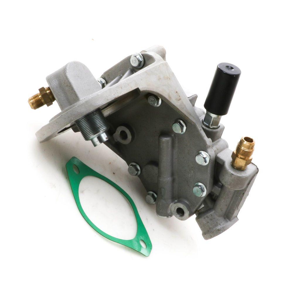

Those fuel transfer pumps are prone to failing. The drive gear slips on the shaft its pressed onto. Double check to see if there is any debris in the bottom of the fuel tanks. Also, if you can run an external fuel line right to the transfer pump to bypass the complete fuel system. Prime the fuel lines and see if it starts. If it doesn't then that pump is no good. Once you get the truck running, you may want to replace those fuel lines. I I believe there is a safety campaign that describes the procedure.

I had one that spun a little on the shaft. Truck would lose power, in the shop the pressure would check fine, put a load on and it dumped the pressure.
This guys sounds like the pump.

next time you loose fuel prime,  put the ether away, and loosen the small fuel line at the lift pump at the right front corner of the engine.  pressurized the left tank with caution, when fuel bubbles out of the loose fitting, stop, tighten the fitting..  then loosen 3 fuel lines at the head, no need to remove the fuel line nut, just 2 full turns loose. and pump the primer, and  gently pull the loose line out to get it to bleed. then tighten it.  torque to about 40 lbft or so, (by feel if you need too) then back it off then re tighten to about 25lbft.  do this to each line one at a time.. then crank it..   it will start, stumble, then clear out..  jojo
