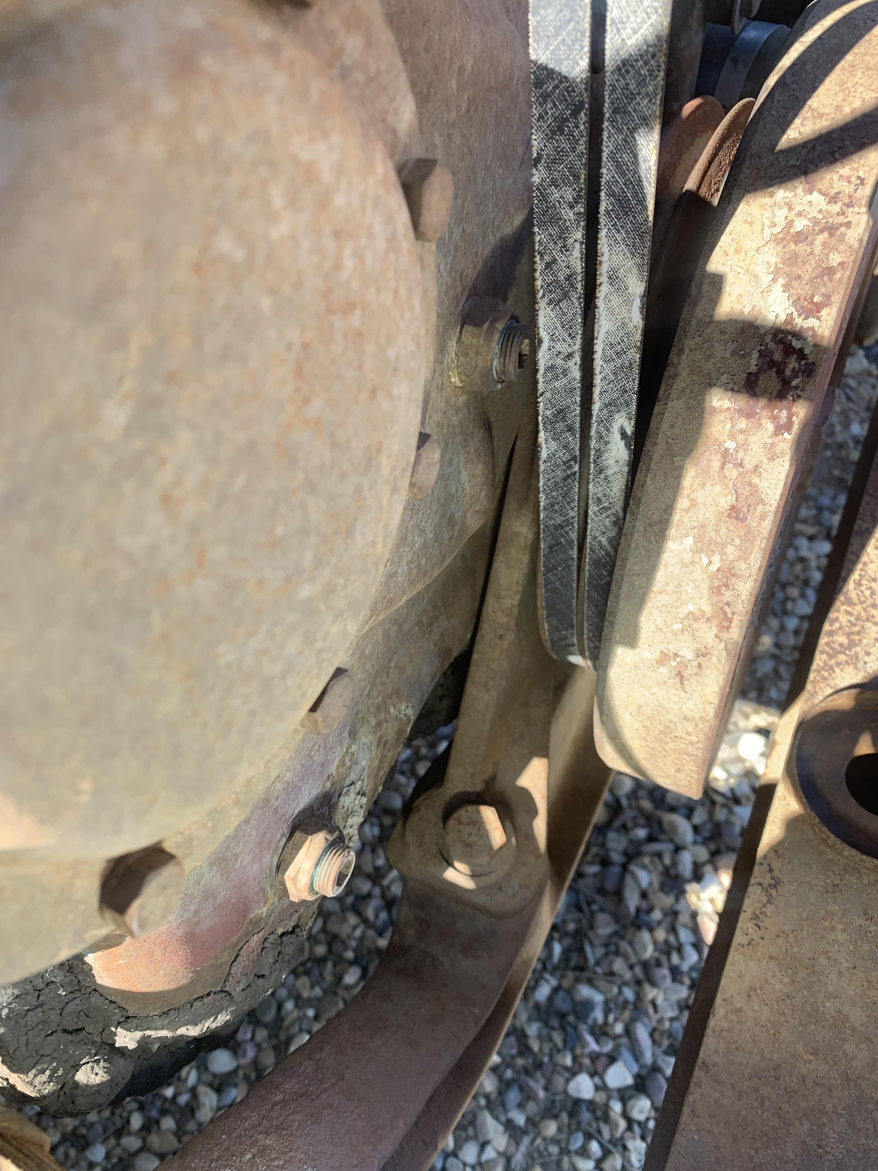

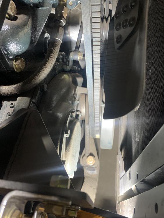

Pretty sure I figured out where the problem lies. Not 100% sure HOW it happened or what needs to be done to fix it but at least I see where I have to work. I checked the front mount and compared it to a stock motor that is still in another chassis and found that the one that I installed (the E6) there is a gap of about 1"-2" from the mount to the front cover whereas the old stock one the mount is right up TO the front cover suggesting that the engine needs to go further back on the front mount. This will also require the balancer to go further on the crank or to will run into the rad support when the engine is moved ahead. I will have to pull the rad and lift the front of the motor, remove the balancer and push the mount further onto the cover then pull the engine ahead to bolt up the mount. Of course this means making new trans mounts again but that is pretty much par for the course.
https://www.bigmacktrucks.com/topic/69498-just-more-work/#findComment-495208

After the photos now I’m confused lol… bob
I believe that is why you need the water pump housing, water pump and crank hub off the 673 engine, they are all shorter, you said you made the rear mounts, might have them to far one way , moving the engine back into the firewall?    terry:MackLogo:
