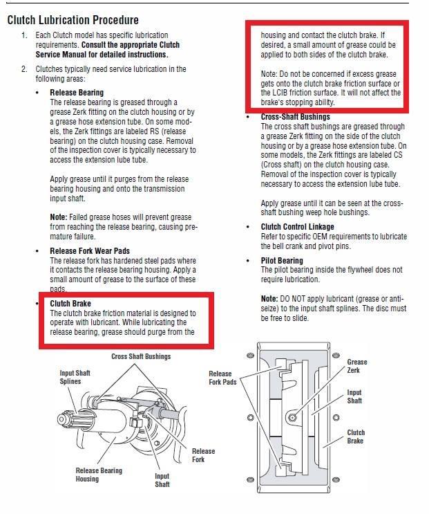

On 4/21/2022 at 4:58 AM, Onyx610 said:
Grease that clutch brake and make sure to setup the clutch correctly!
Should friction surface of a clutch brake be greased??
Very interesting, thanks for clarification guys.
We know some applications where friction materials work in oil such as motorbike clutches or clutches in hydromechanical automatic transmissions. This way it seems quite possible to do the same for a small part in a big truck :)
