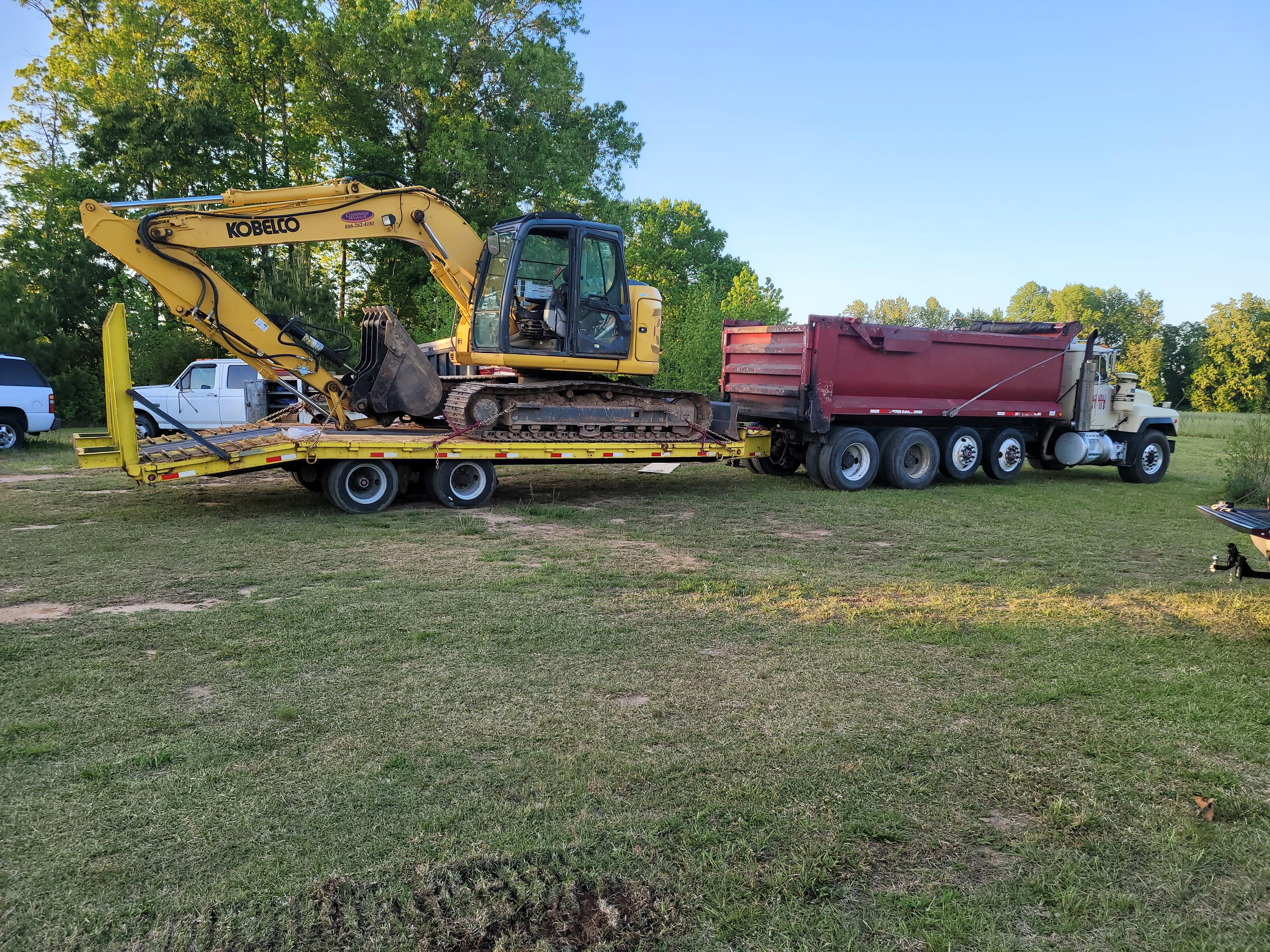

I have the Mack truck in subject line. It only has a tractor brake inside cab. I purchased a 30,000 lb dozer and I was wondering if I could add trailer air brakes and tow this dozer. Would need a tag trailer rated for 40,000 lbs. Before I even waste time thinking about it was going ask some of you more knowledgeable guys if this was even a possibility.
I just did about the Samething as you
I purchased a excavator
but I got my gladhand kit from anything trucks
haven't Installed it yet but seem to be everything I need
bunch of good videos on YouTube
I just need to figure out the trailer wiring now before the gladhands

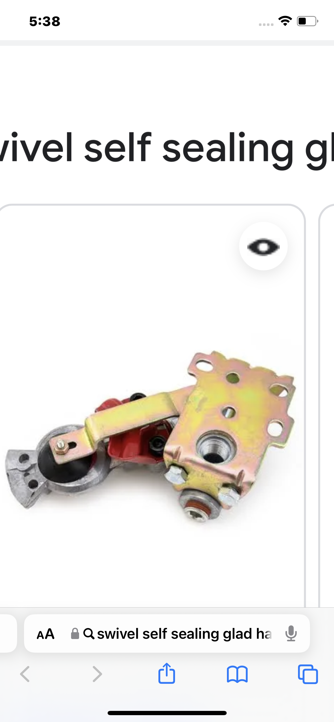

So we are welding a 3/4” plate on back for pintle hitch. I have the gladhands that have a spring on them that seal themselves off when not hooked up. The gladhands have a female thread coming out of the back of them. What do people use to run through the 3/4” plate that will attach to gladhand and airlines but also go thru the 3/4”  Here is a photo of gladhands for illustration
