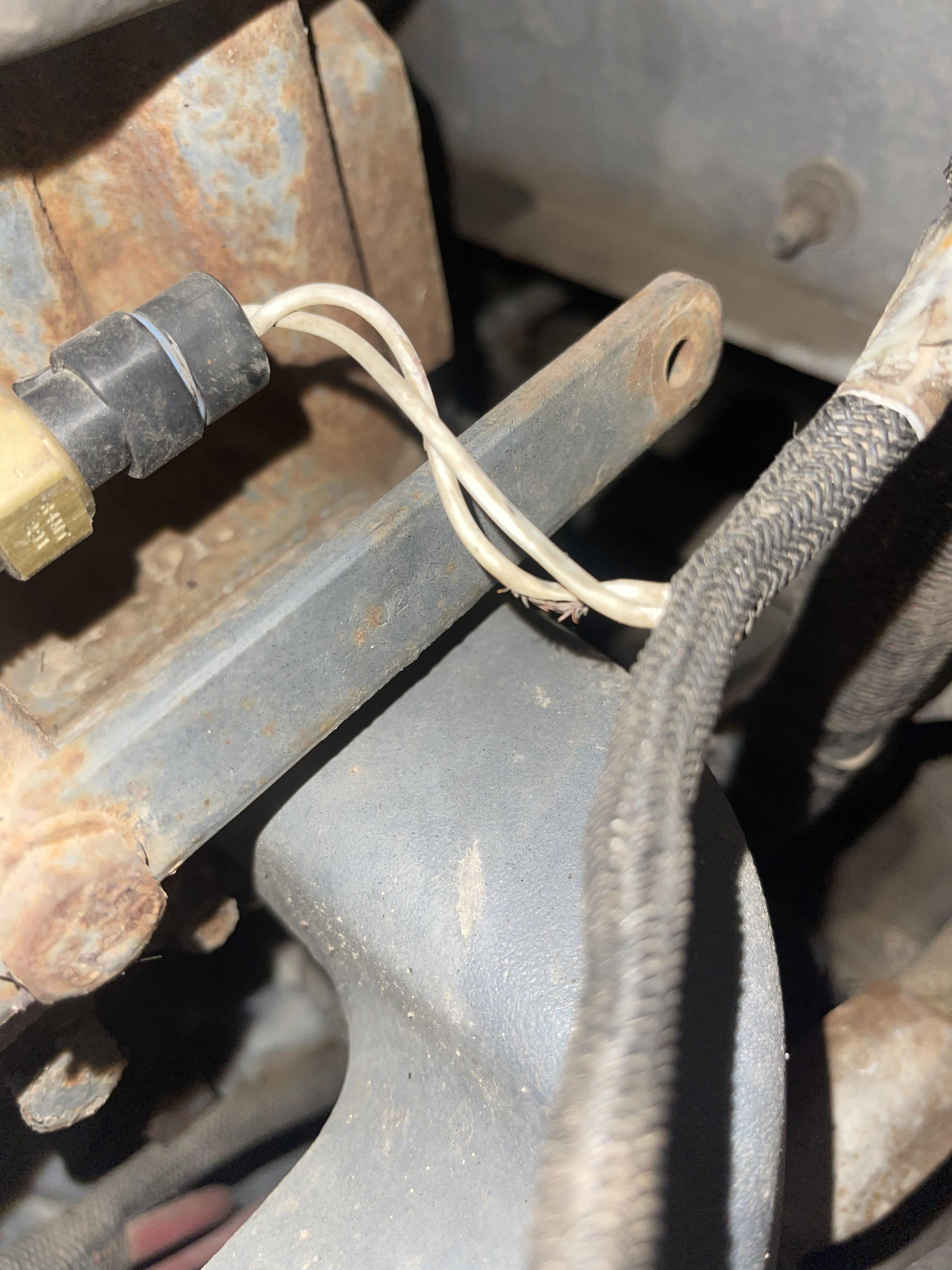

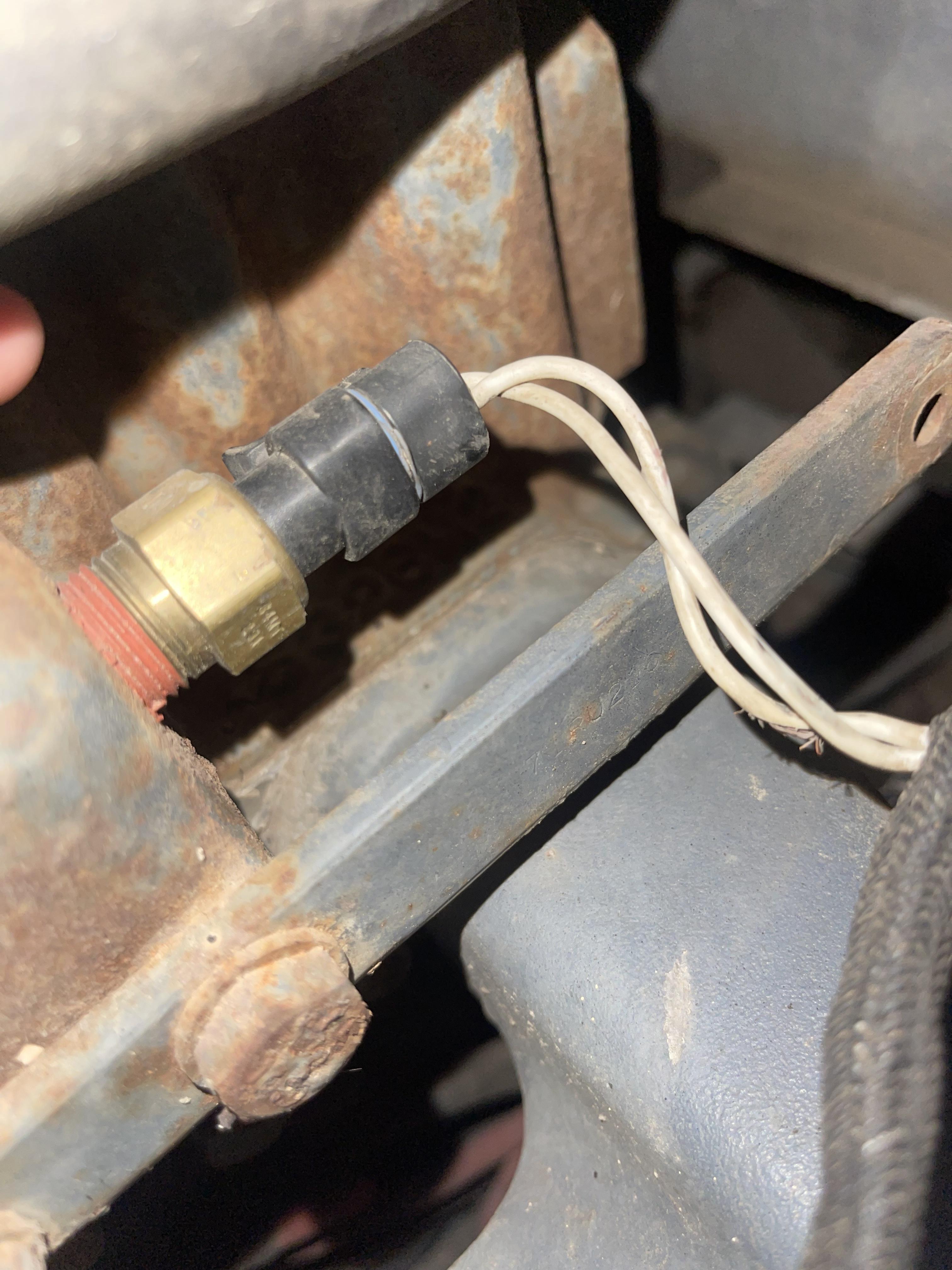

Think I found my issue take a look at the pictures the wire going to what I believe is the coolant temp sensor back of the water manifold correct? @Dirtymilkman
