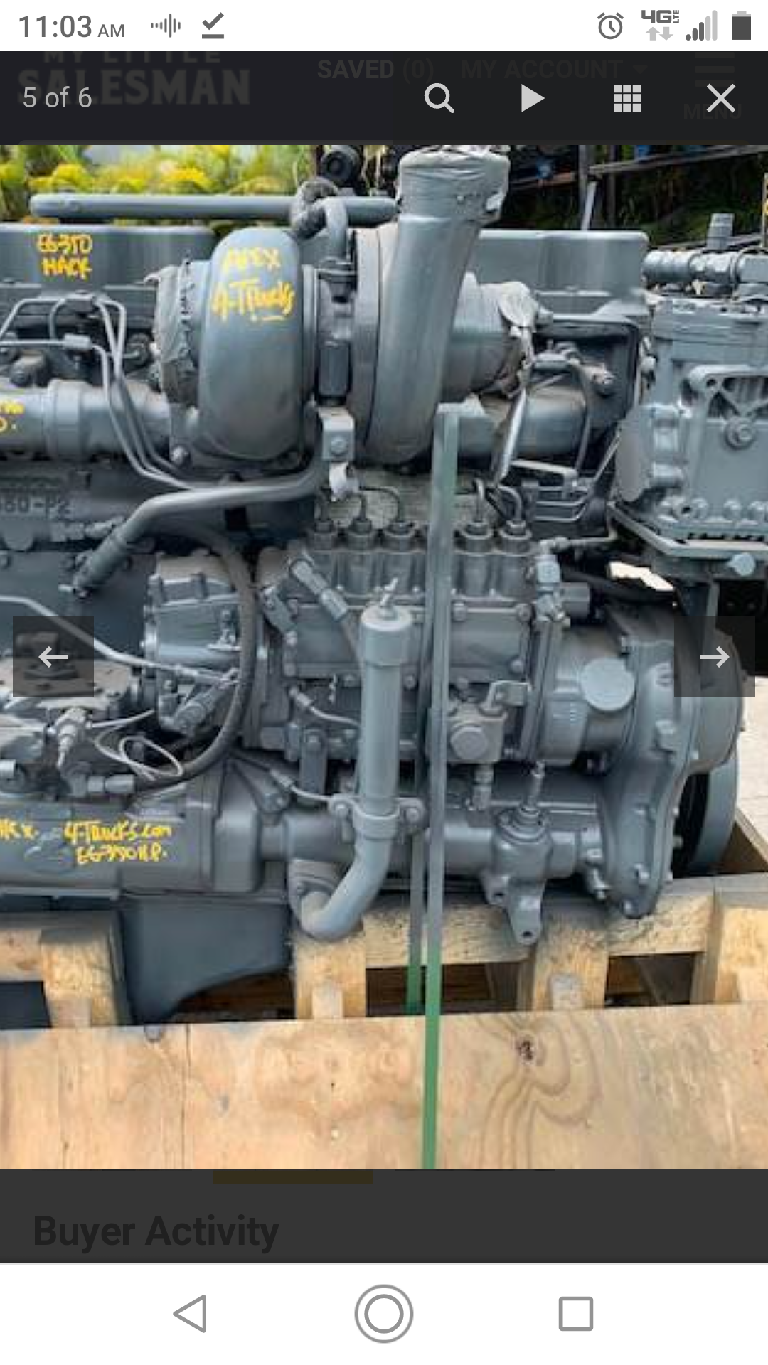

5 minutes ago, JoeH said:
From the Google web. Ad said 1989, looks like engine are says 1985? Not sure which pump it has, but someone more familiar can figure it out.  Says 20 degrees. E6, 350
Joe the timing changes by year and model I think ? Its mostly emissions related I think ! I noticed over the years  as time went on the timing went up on degree a year for the same HP engine up to 22 Just seemed like it anyway!?
https://www.bigmacktrucks.com/topic/69899-pump-timing/#findComment-499284
Thank's "F"..  I didnt do enough pump work, before I was spoon fed the E-Tech.. I always refer to my books, if I have the right book.   (Joe H,,, thats an Ambach pump..)   jojo
