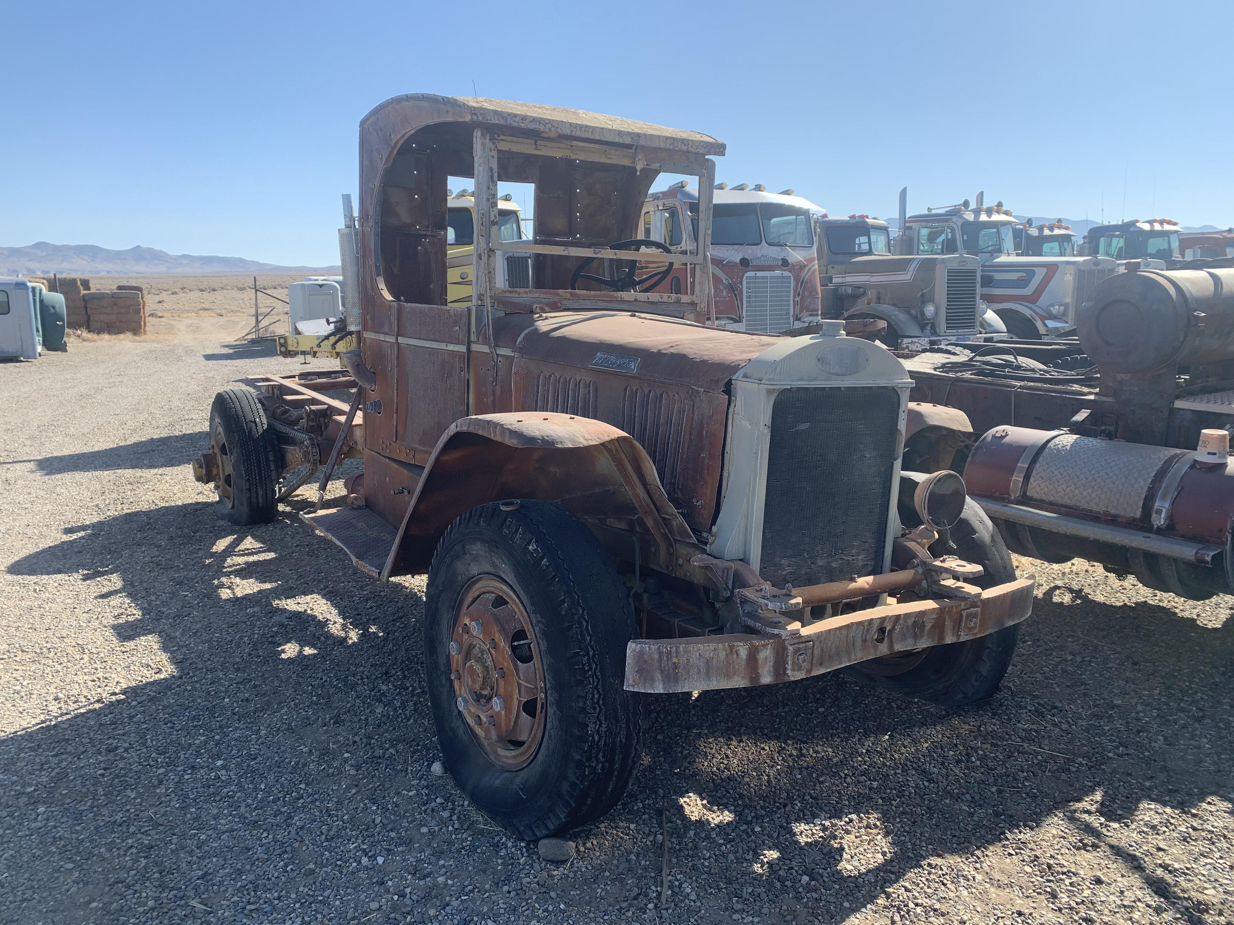

Really cool early find!! Are you doing a full restoration or just a preservation?
At this point just a preservation. It is really complete so if we can get it running it should be drivable for parades, shows, etc. It is really beat up. A full restoration would be a lot of work!

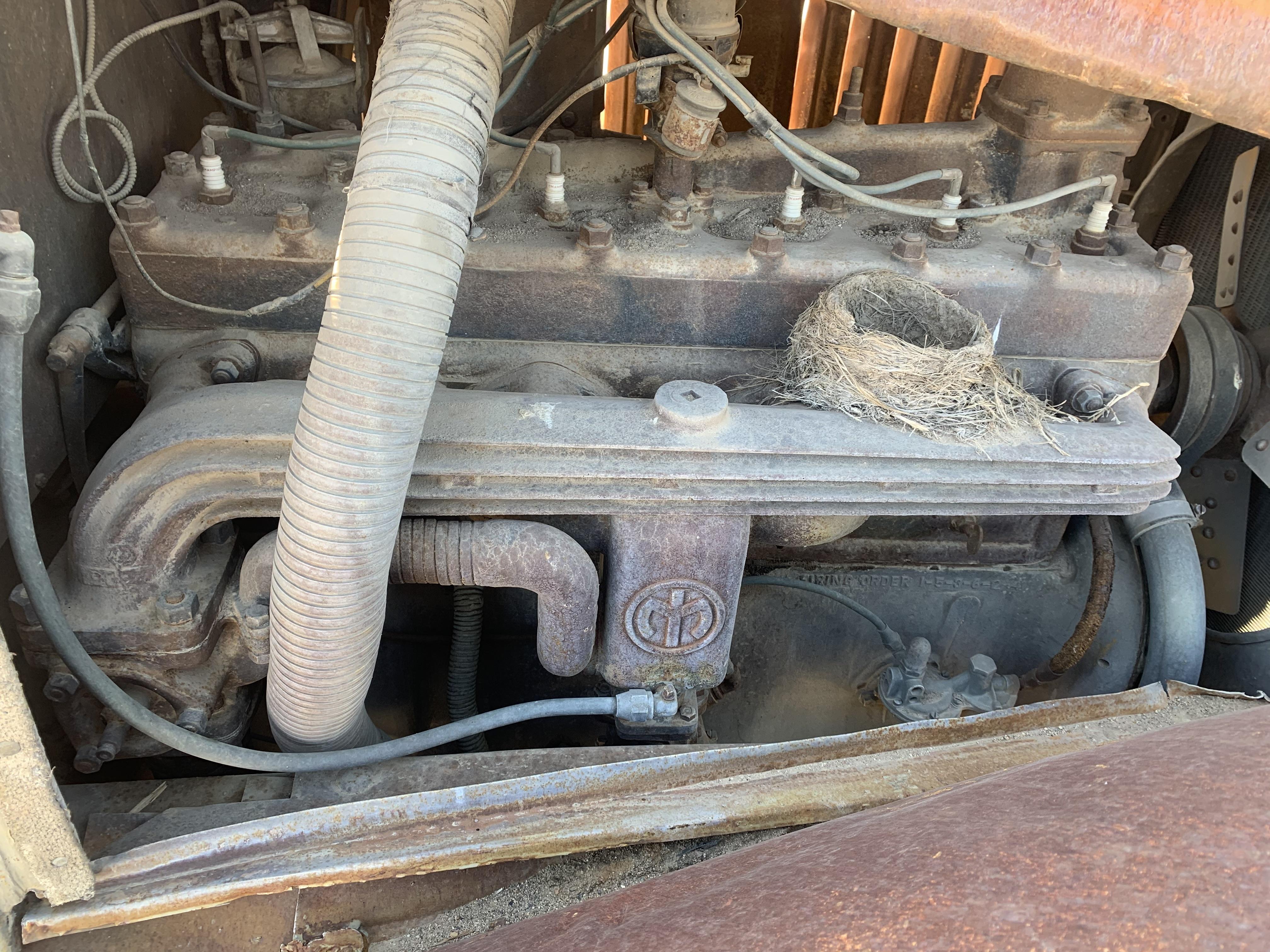

Excellent have a ball with it…engine stuck doesn’t necessarily mean you can’t free it with lots of mystery oil snd tapping on the pistons I’ve done it before good luck  Bob
We're working on that! Pan needs to come off as there are some rust holes in the bottom due to condensation(I hope). Oil looks good it it and not overfull. Fingers crossed.

Great find! A rare beast definitely. Congrats on the purchase!
Speaking the engine I would pay attention to what firetruck guys have in their old Macks.

Nice Find Bro! Can't answer your question either ! But ! I always wondered why the up draft carb was invented and used so much! seemed back in the day up draft was the thing to do!
Ive wondered if that was not to keep fuel from overflowing and running into the engine?  Something along those lines?

I had occation to measure a bc engine looking for a cylinder head for a CF engine in a BM truck The head bolt pattern front to back measured the same but the BC engine was 1 inch nerrower measured across the block  than the CF engine. The CF is a 414 CU" engine so my quess would be the BC would be aprox 350 CU".You are very fortunate to have a pristeen EX manifold.
Up draft carbs were most likely used so as to have gravity fuel flow to the carb. All gas powered tractors had their tank above the engine and of cource the Model A ford with the tank in the dash.
