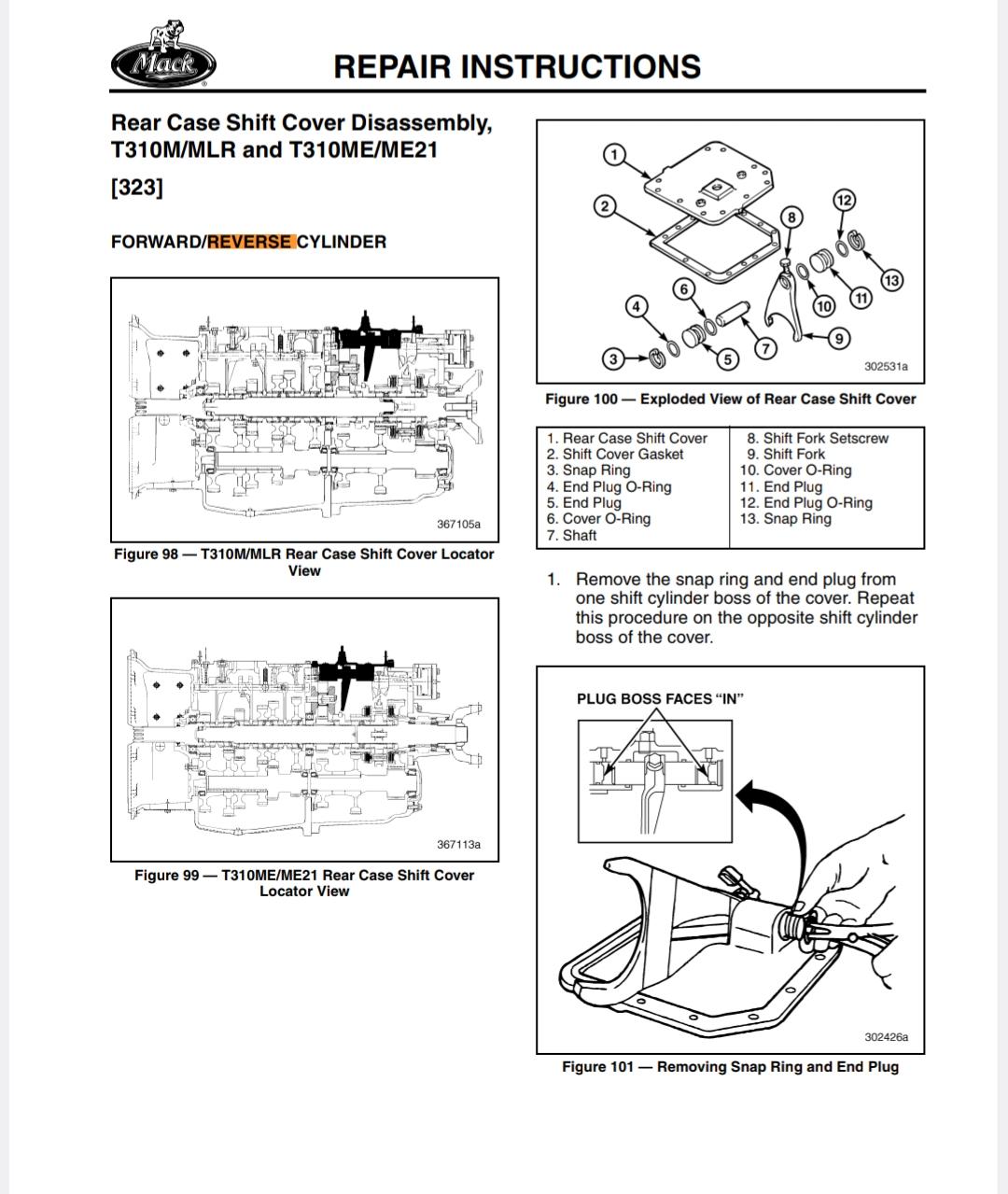

In my opinion you have an o-ring that is cracked and allowing air into the case, now in the 18 speed the rear piston is for high low, and can be replaced externally.  The reverse piston I think is on top of the transmission.
yes to a bad o-ring.  on the top of the back box, there is a shift cover,  remove it and re-build the cylinders.  when its on the bench you can put shop air to it to see how it leaking, (if you want to see it) then re-ring it..  I suggest replacing the shift fork set bolt... jojo
I just went to my book as well... only thing is I cant post pics anymore..  I am glad you posted this pic for him...   :) jojo

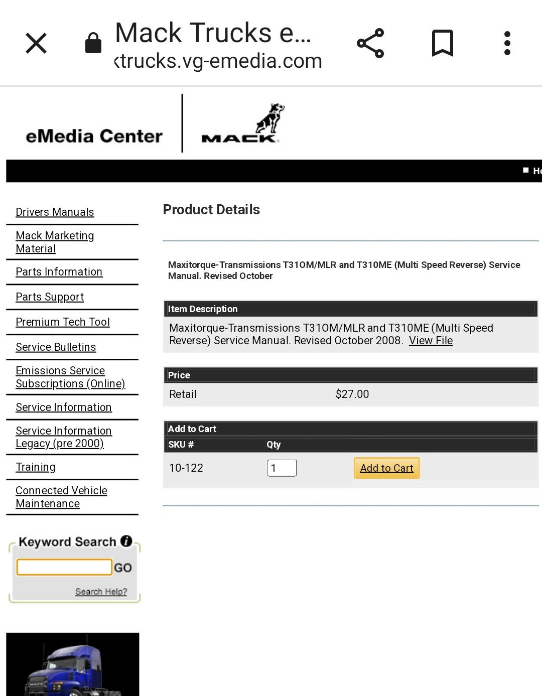

If you go to mack emedia you can download load the whole pdf file on this transmission.for free ..just type 10-122 , which is the part number for the publication and then click on view file.it will download the PDF.
