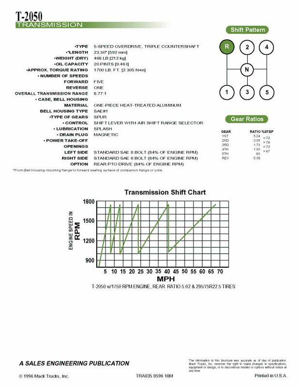

Same concept but different ratios (and rear end ratios). Both were intended to be paired with a Maxidyne engine. The TRL107 is direct (1:1) in 5th whereas the T2050 has the very fast overdrive (0.6:1) in 5th. All T20X0 transmissions with 5,6,7, or 8 speeds had the 0.6:1 overdrive, were direct in 4th, and were paired with very slow rears usually (5.73 to 6:39 or higher numerically). Trucks with a TRL107 usually had 4.00 - 5.00 rear end ratios. A T2050 will have 5.24:1 in first gear, 1:1 in fourth, and 0.6:1 in 5th. Don't know what 2nd and 3rd would be.

The 2nd and 3rd gears have the same ratios as in T2070. And also in T2060 and T2080. By the word I recently discovered that T2070 with short compound housing existed.
