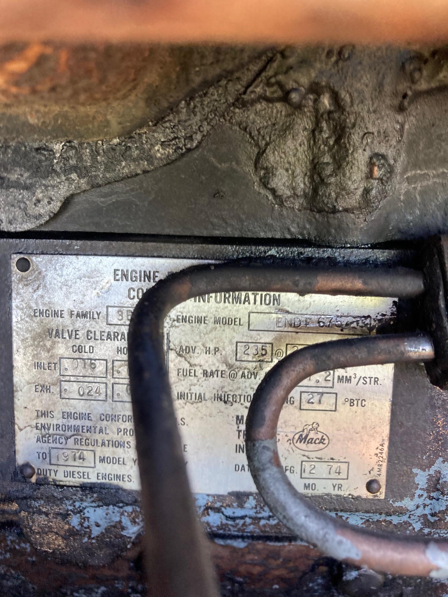

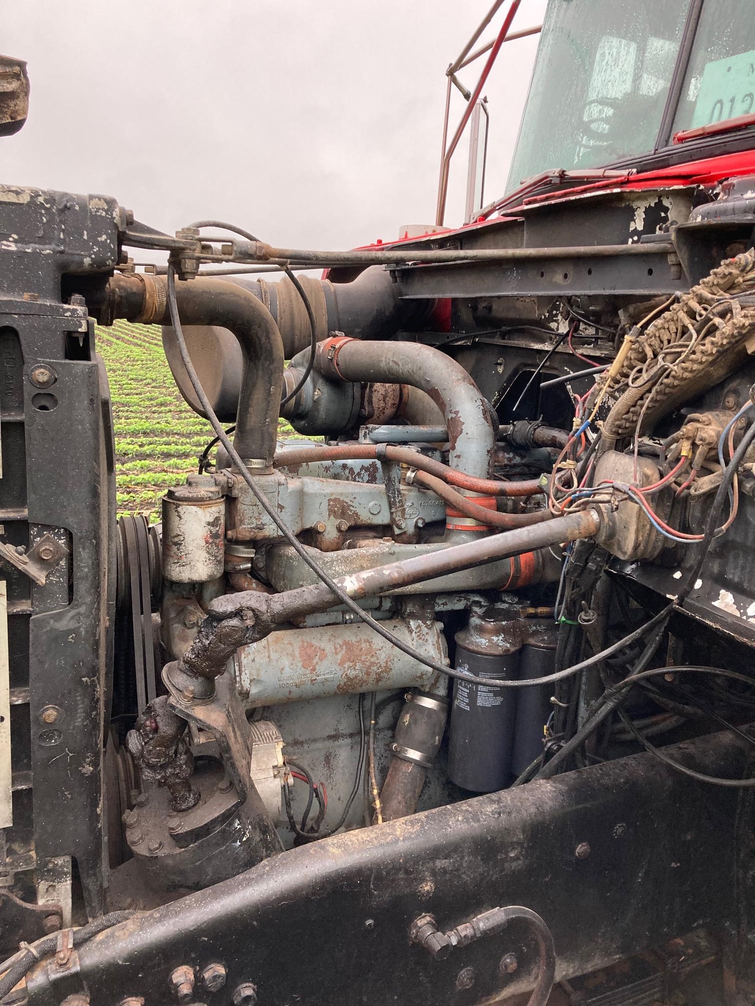

A couple weeks ago I purchased a 1986 Mack DM 685S for 10K from Manders in Lakeville. The truck has a 13 speed tranny, and an ENDT 675 motor (235hp). I was told by Manders it had 285hp which would be the ENDT 676. After getting the truck home and power washing the motor block off I discovered it was the 235HP motor (not to happy about it) at the time I did not know to look for the aftercooler and twin pipes to the intake or that DM685 stood for the 235hp motor and DM686 stood for the 285HP motor, I DO NOW THOUGH! I was just going off what the salesman's was telling me! This DM will be replacing our current 1994 RD690s which has 300 HP. The original plan for the DM with "285hp" thought I was getting was to add a bigger fuel pump and make it have 350HP so more then the current RD and then restore the old DM. The DM at least needs 285HP as it will be pulling a 200 series hoe from jobsite to jobsite until we get a lowboy setup. So my questions are now...
1. Can the ENDT 675 handle 350Hp?
2. Where do I find a stock or aftermarket aftercooler?
3. Where do I find a twin tubed cold air intake?
4. Is this motor a 2 valve or 4 valve? which is considered better?
5. Should I sell this truck and try to find a DM686 with ENDT 676 motor?
6. is this the Ecodyne or Maxidyne motor? Which is considered better?
7. How would a ENDT 675 Pair with a 18 speed tranny? over kill is fine 😜
***Any other thoughts, ideas or concerns are welcomed and thank you for your time and knowledge!***

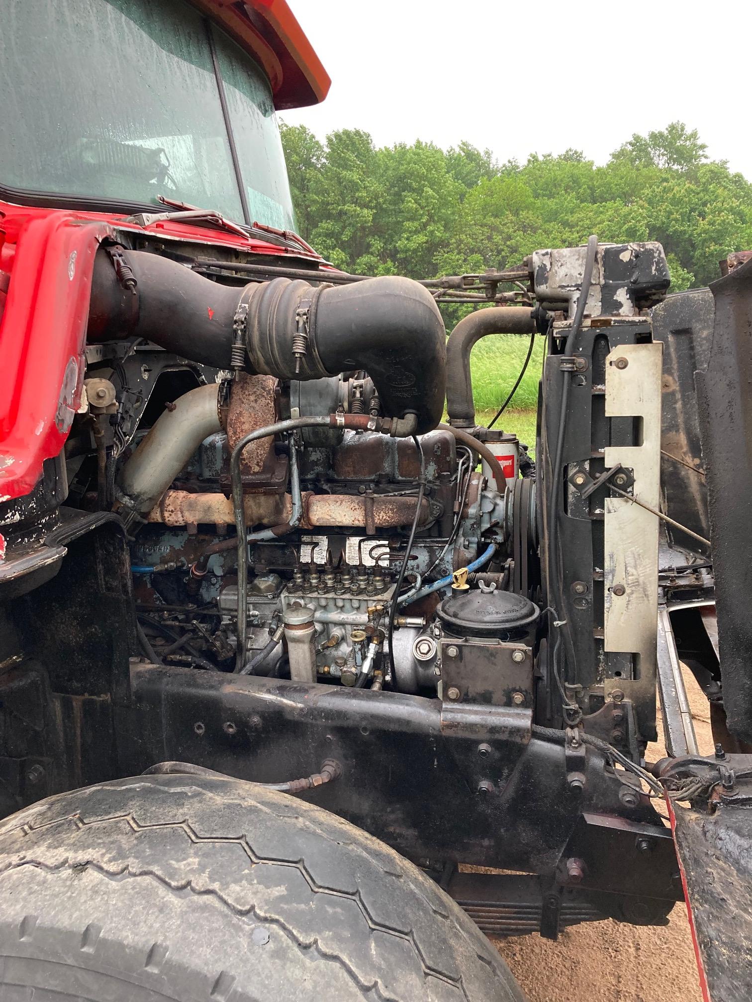

Thats a 2 valve Maxidyne motor.  Good reliable motor.  Collecting all the parts to upgrade will be be more then just repowering it if you can find a good 315hp version.  Not sure how safely you can go up with HP on that 2 valve engine?  There are guys on here that can give you that info.

My 0.02. Pretty much what Freightrain said. Not sure why you would need (or want) to have a Maxidyne make more than 300 horsepower. They just are not designed that way. The torque rise on these engines is incredible. Mack knew what they were doing when they made that engine and matched it to the extended range transmission and proper rears (which makes me think the 13 speed was added by someone later). Trucks with this power train and these specs just were not set up to run 300+ horsepower and an 18 speed transmission. Could it be done? Probably. But I think you would be further ahead to just find one already set up that way with an E6-350 4V or E7-350/400. If I was trying to achieve more than 350 horsepower I would definitely be looking for an E7.

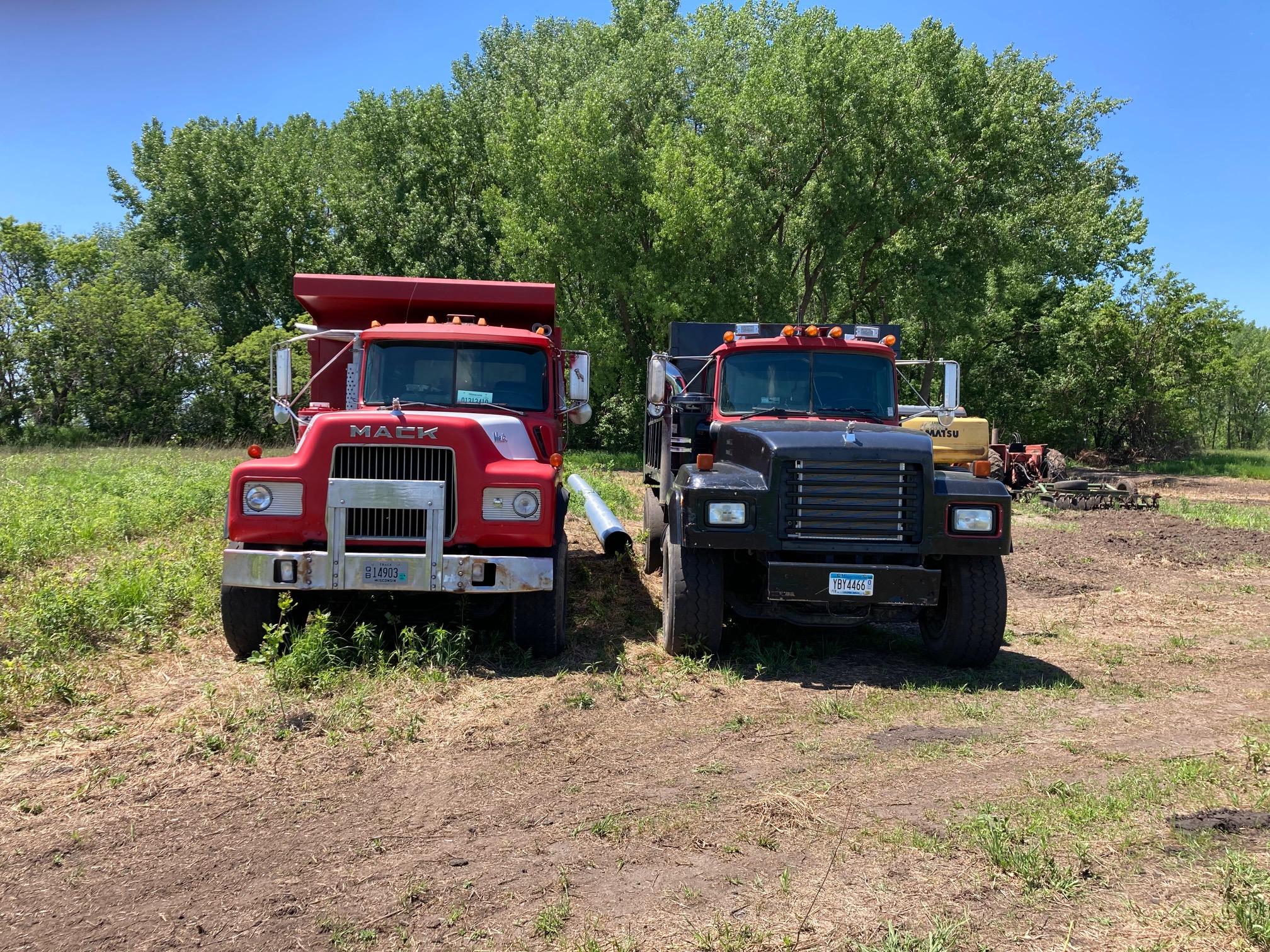

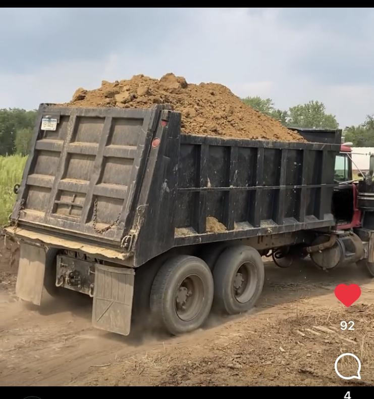

I could settle for 300 HP I think because that's what I currently have and it does the job the (94 RD690s, which has an E7 I believe, the black and red one in the pictures). I also like the model of DM I have which I think only runs up to 1988 maybe 89 then the body style changes a little bit (more sunk in headlights). So I would have to find a DM 686 or 688 under 1988. I am not sure if they even put 300hp in these older Dm's???...

From what I have read on other forums the ENDT 675 has the same motor block and stroke as the ENDT 676 and 673. I also read the only difference between the 675 and 676 is the aftercooler and then some fuel adjusting. I will try and round up some of the forums on this.
Is buying the aftercooler straight from Mack still an option?
I have also read a lot of ppl like the 2 valve compared to the 4 valve that it pulls harder, but that you need to keep an eye on the pyrometer on a 2 valve 🤷‍♂️

That engine is a 1974 it is not recommend to increase HP if it was mid 80's then yes with push in freeze plug's not screwed in ...

Maybe manders will give you a good deal on a 676 engine, they are 285 horse, have to have a different air filter and different intake and maybe exhaust piping.  Terry:MackLogo:

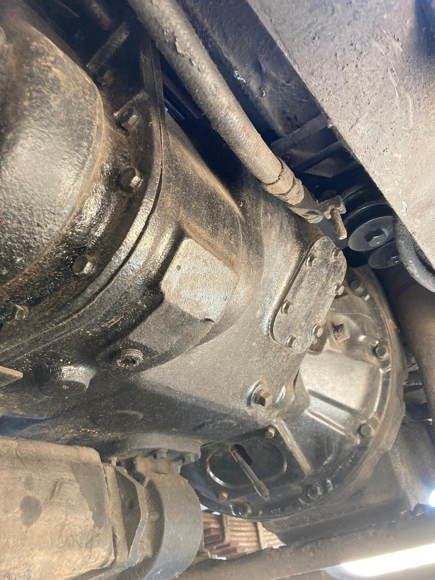

Check trans to see if it is 12513 or 14513 if 12 the little Mack will tear it up ?
I tried to locate these numbers on the trans, it seems the info plate is missing or is there another place?? Im assuming by how everything else is going with this truck its probably the 12!!

Trans is a fuller 13 (least what I was told) it looks like I could see eaton cast into the top of the trans. the info plate has been removed from the trans so not sure what type of 13 it is. Probably not the right one judging by all the other miss leading info I have been given on this truck.

How quick will the motor shred the trans? 200K miles 50K miles? It will be worked. Overloaded with dirt spilling over the side off road (sometimes in soft soil) is 100% in its future that's why I got a Mack and that's why I wanted a DM. That is what our RD has been doing for years now.
