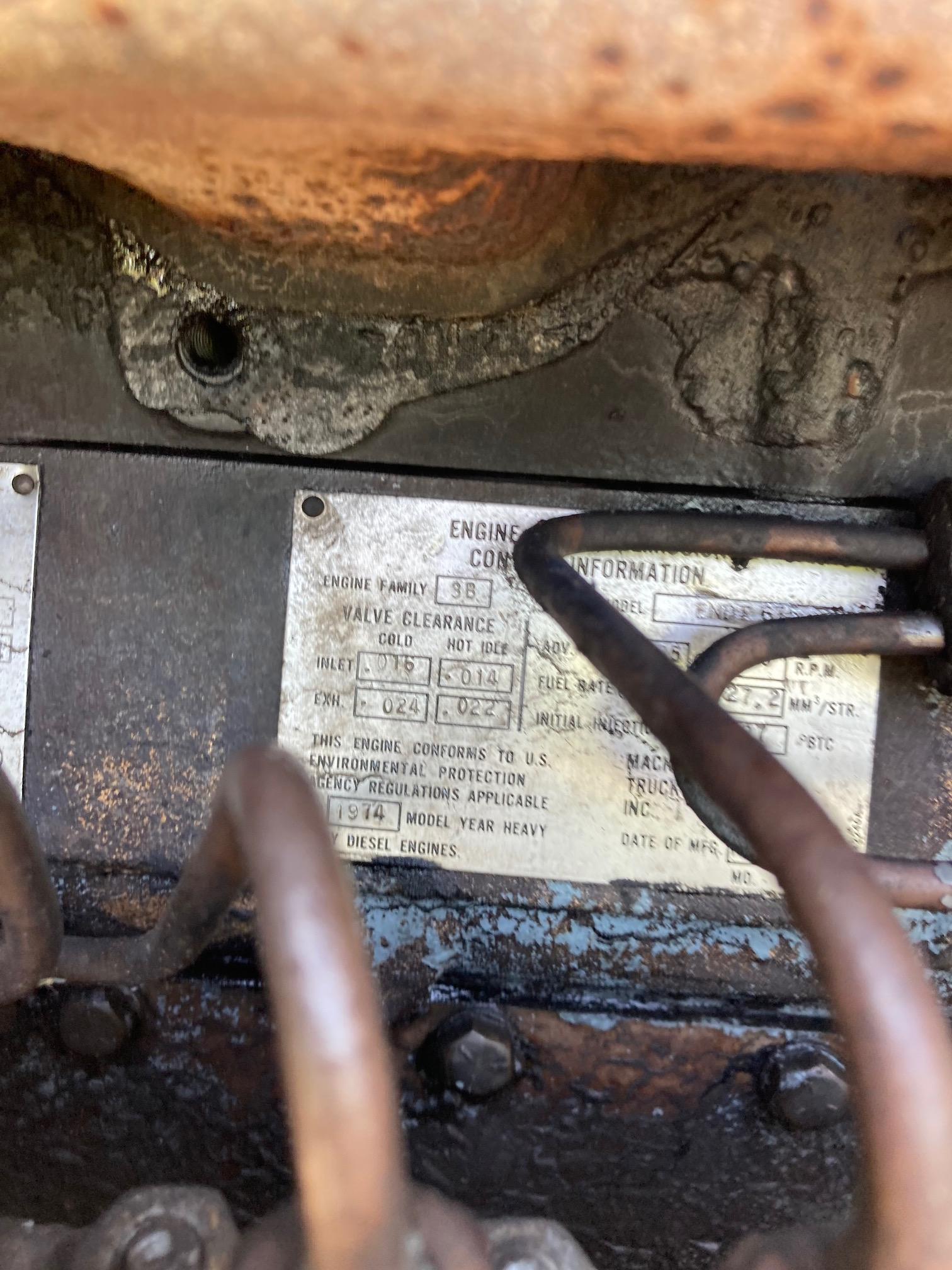

On 6/22/2022 at 2:48 AM, blackdog2 said:
That engine is a 1974 it is not recommend to increase HP if it was mid 80's then yes with push in freeze plug's not screwed in ...
How does my 86 DM have a 1974 motor in it ha? I was thinking the 1974 was the emission compliance like it says in the picture below. But then it does say date of mfg. does MFG mean manufactured ?
Yes on MFG = Manufactured. Original engine gave up the ghost at some point and someone had that one laying around. Their problem was solved.
