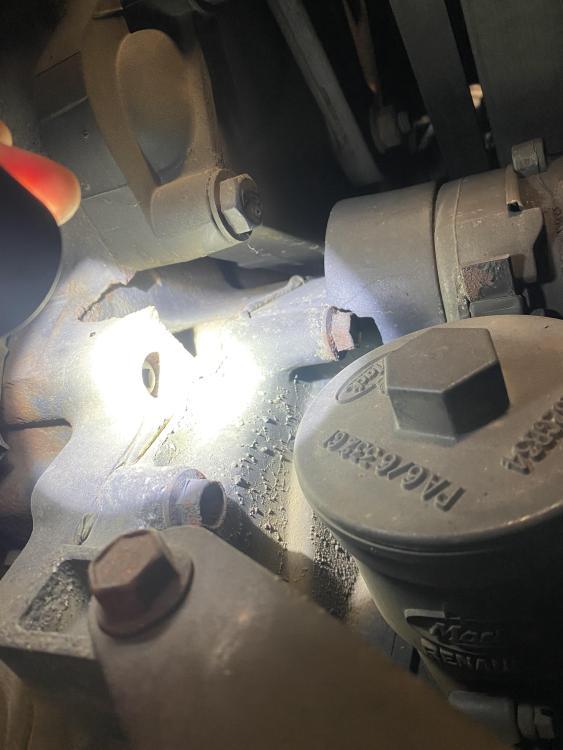

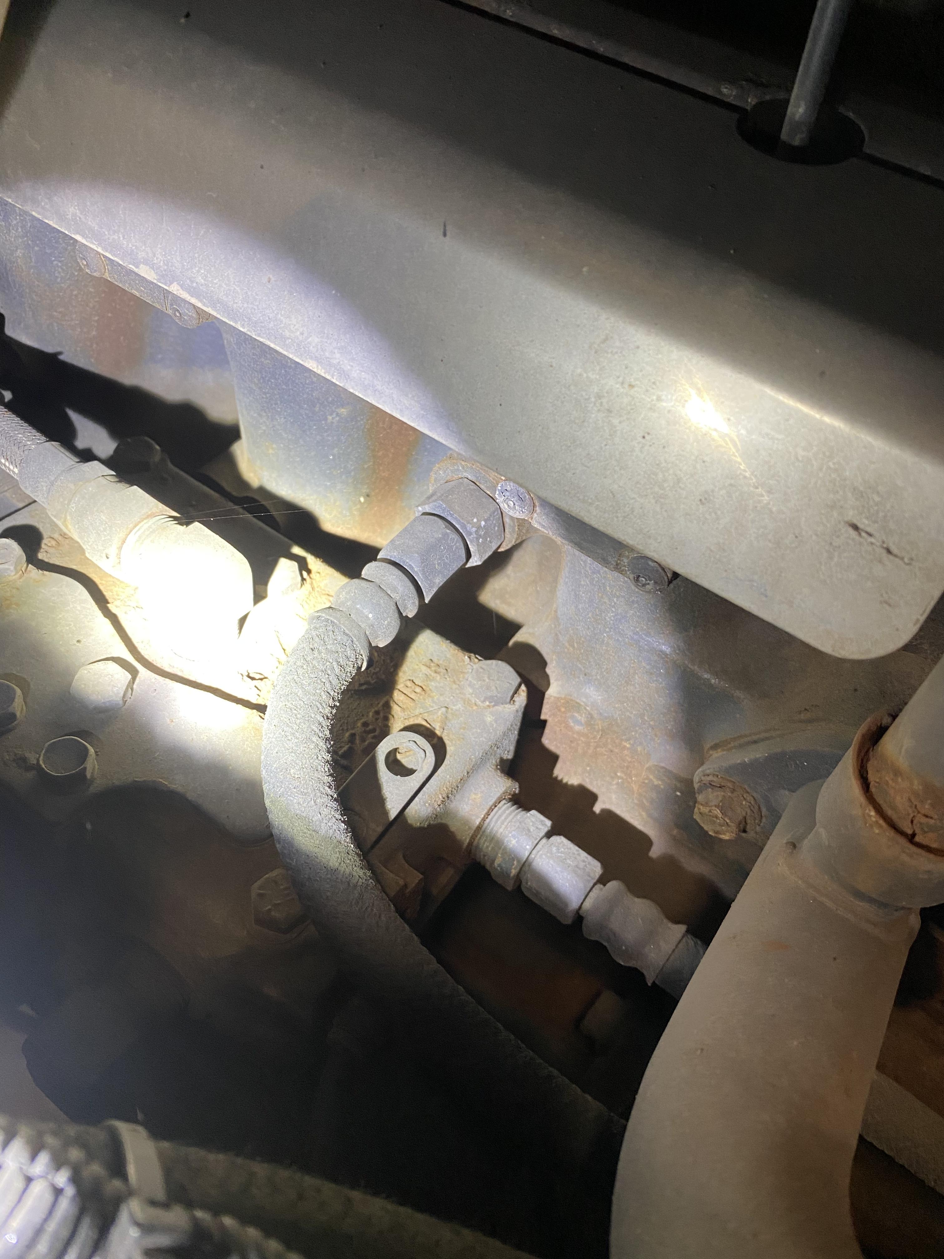

you dont need dye.  this is a process...   you need to cap the output of the primary filter hose , and the fuel inlet to the block, below cyl. #3, and the the outlet below cyl. #5.  this will isolate the 2 fuel galleries.  then remove the 1/4" plug with a quarter drive ratchet. the plug is the visible one behind the overboard breather canister..   the hidden one is real, it is behind the timing cover. when you find the plug I mention, right below it is a hump in the timing cover..   the return gallery plug is there..   we wont go there right now..    since you will be dropping the pan to look...  remove the overboard breather to give you room to work.  rig up a fitting that lets you put air pressure to the galleries.  it's 1/4 npt...  50-70 PSI should be enough..  dont go nuts on pressure...   do not pull the EUP's ..  apply air pressure and look up for bubbles and hissing..  it will be hard to see if the lower plug behind the timing cover is leaking, but you may be able to hear it through the breather hole.  if you have a bore scope you can try to look in there to see..  honestly..  I never see that plug leak, but ...   there is always the first one somewhere...   I expect more guys posting their knowledge on this...   jojo

 Im very concerned here that you may have a restriction in the return line! Once you establish where the fuel is coming from as joe has  explained there   And IF its coming from the fuel pump Again I You need to be checking the return line for a restriction replace the drain back valve and check the fuel pressure to be sure its not going to much  over 80 psi!   also make sure the return line is clear just my opinion! If the pump has failed there may be a reason !

Well it happened... I said that I never see the hidden plug leaking....  well the E-tech I'm building, was the one...  I put the 1/4" ratchet on it and the weight of my baby ratchet was enough to turn the plug..   So I found how fuel got into this engine...   jojo
