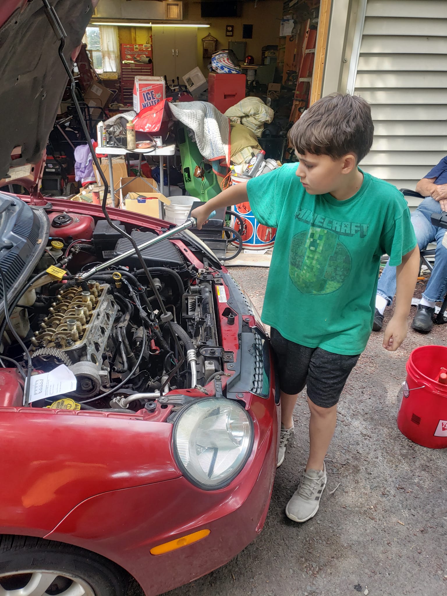

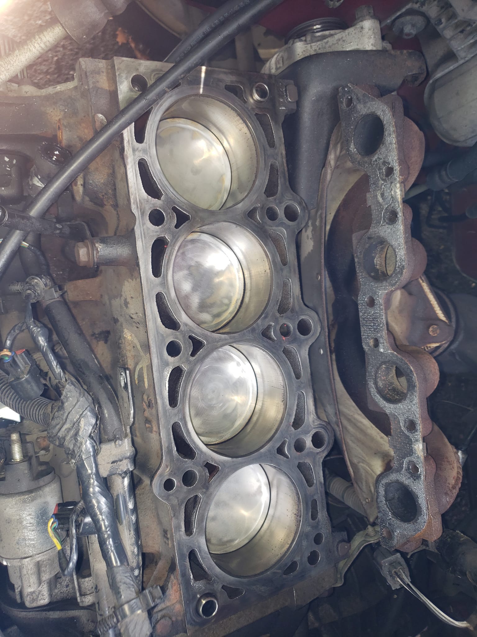

UPDATE:

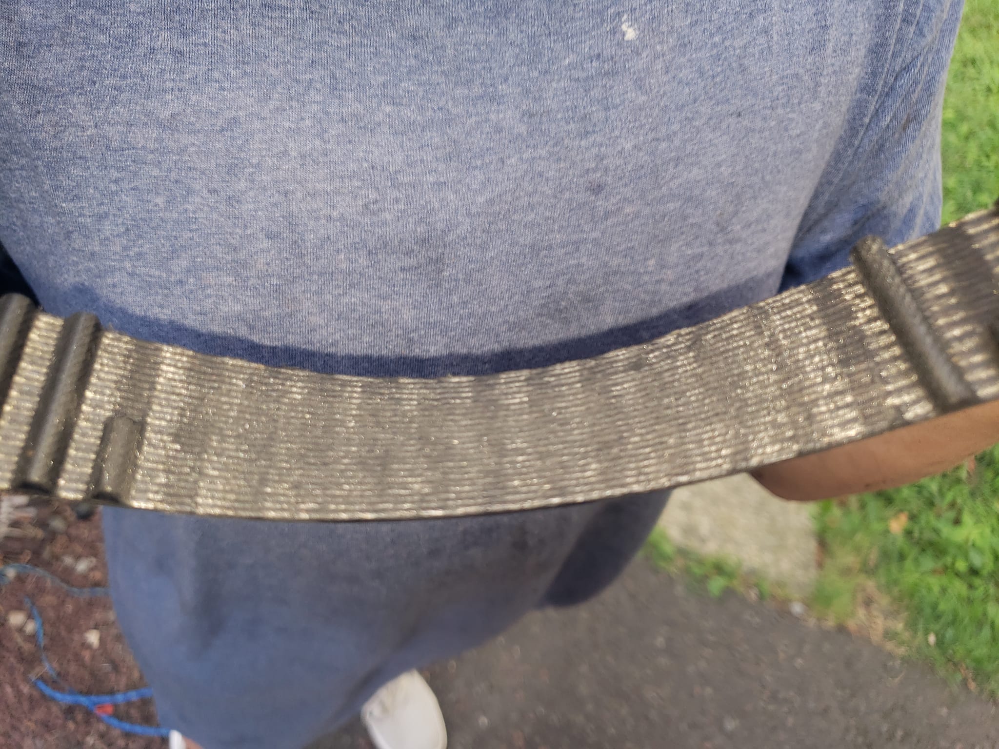

After watching several youtube videos I learnt myself how to pull the head- what a PITA!! In order to pull the timing belt cover, you have to pull the harmonic balancer and the (3) right hand side engine mounts. Hardest harmonic balancer I ever had to pull, it would not give up. I finally had to sacrifice a Harbor Freight three jaw puller to the God of air impact guns. Soaked that thing in kroil and smashed on it with a 5lb maul for a spell and then put an impact gun to the puller and it finally let loose. Then you have to put a jack under the engine, take the weight off the 3 mounts, pull those bolts and then lower the engine down to get at the first mount through the wheel well. Then jack the engine up, and pull it forward while someone else goes in with a ratchet and socket and gets the other 2 bolts- and out comes the timing belt cover. Oh, and yeah the timing belt has a 5" portion worn down, no teeth. And a bunch of other teeth that are chewed to hell and a bunch of teeth sitting in the bottom of the timing cover.

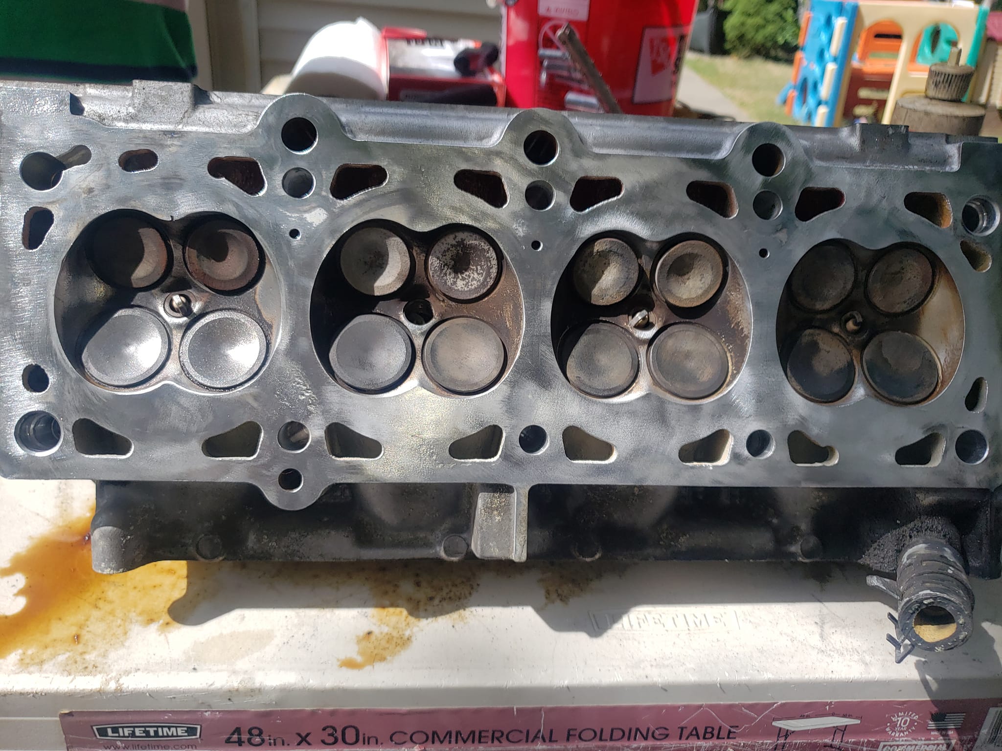

So we get the cover and the belt off. Pulled the cam gear, unbolted all the head bolts and off it came. No cylinder damage at all. No damage to any valves or stems visible to the naked eye. So I have a buddy price out new parts and labor for re-assembly....reman head. new head bolts, new timing belt and tensioner, new water pump, new serpentine, new hoses (may as well while I am in there) new coolant, new wires/plugs and oil/filter.......$2400 for everything.

UPDATE: That price that was quoted to me was parts and labor. The price for the parts is about $600

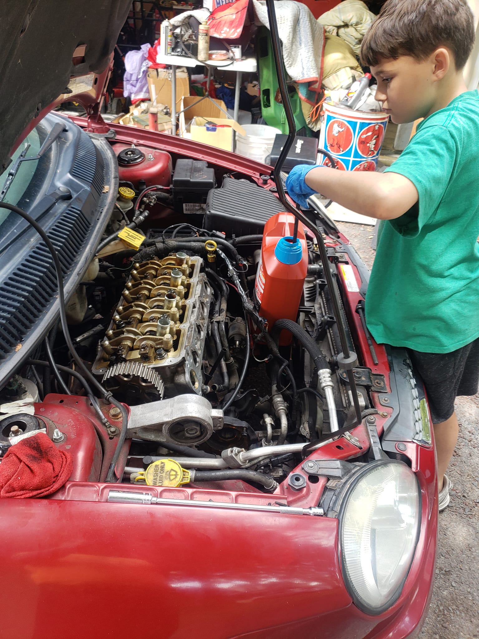

In the absence of any evidence of damage, I am going to reassemble. New head bolts, new water pump, new belts, new tensioner, new plugs, new coil & wires, new thermostat, etc etc etc FULL SEND.
