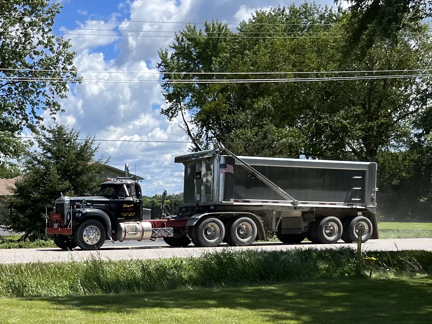

1964 B75 with a mechanical E7, Fuller sp on Mack air ride/rears.  All the modern things a guy would want.    Dad hauls into the yard with it.
E7 ?   What's it use as an intercooler ?  I'm a little envious of Dad by the way.
Uses the original radiator placement  for the inter-cooler.   Shutters are for looks and the actual radiator is behind the original one.    I’m working on one of my IH’s today.   I can try to remember to grab a pic
engine must be sitting partly in the cabin? We have an E6 in our B75 and it is very close to fire wall, so by my thinking the engine maybe inside by up to 12 inches, assuming a bit of clearance at the back of the engine. But a good result to fit the E7.
