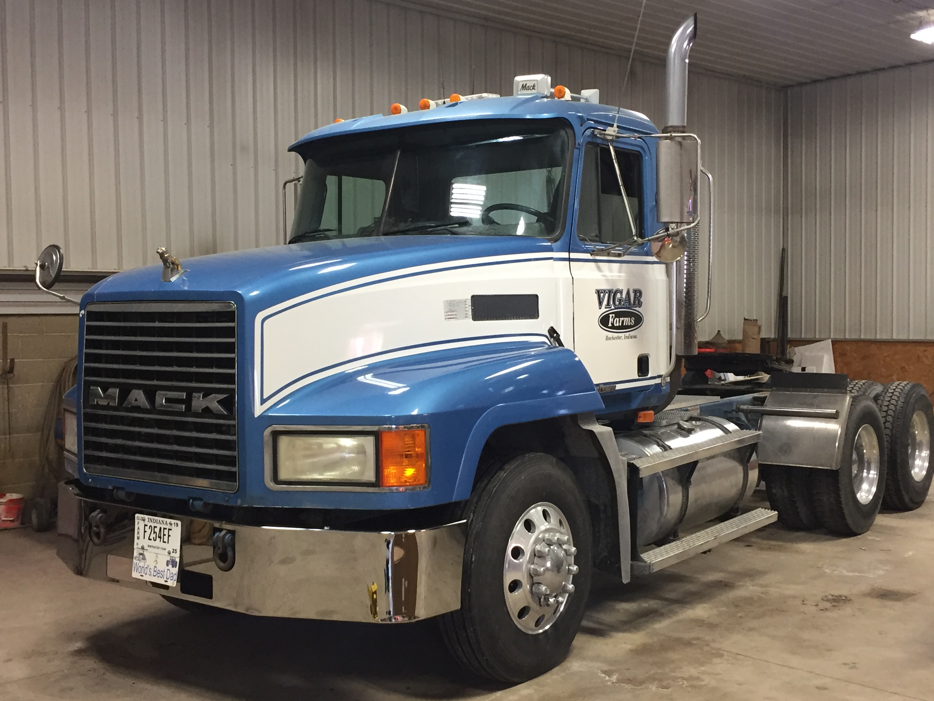

D3667C0B-D9D9-4254-97E0-7BED98C1F033.thumb.jpeg.38aaca4db34667594011877a7f941798.jpegHave ch 613 that has the 2090 transmission.   Thinking of switching to something else.   Truck has the 355-380 engine. What would be the best fit.
Sure doesn’t need a higher gear and could use a lower low for the farm.  I need to look and see what ratio it is.  65 is about 1450rpm.

8LL Eaton is a great tranny..   The 310M is also great..  Myself..  when I drove dump trucks.  I learned to love multi speed reverse..  My first was the 1070B and the X107 twin stick..  however, the 2013/2018,  will get the job done...  you'll  need to have the get the drive shaft re-done..  anyway, you are in a great place for REAL knowledge..  jojo
I'd go 18 speed. You have a gear fir every condition. And if you get the mack 18 speed Lr then you have 4 usable reverse gears. An Eaton may be way cheaper though and I saw winrock truck parts sell mack to Eaton conversion kits.
