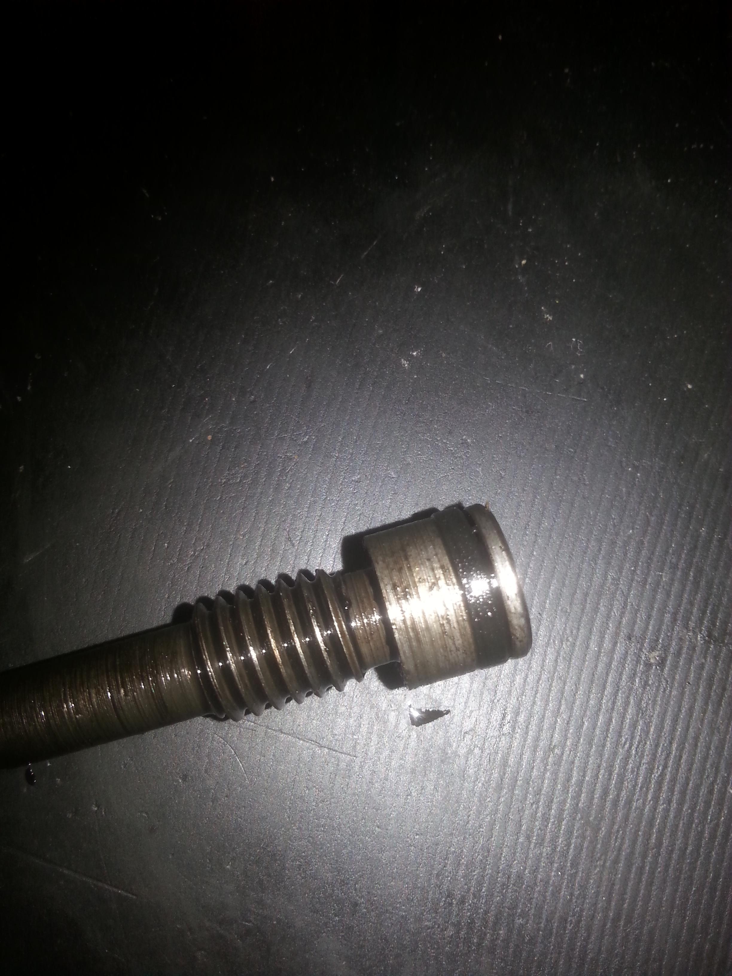

I have noticed that the tall bolts for the rocker housing are longer, to accommodate the jake assembly
Does anyone know if this O-ring on the adapter fitting for the oil feed to the jake assembly thru the rocker, is still available thru Jacobs?  Looks like a specific square style oring.  I'm reluctant to reuse it
According to the parts list on their site, its a .365IDx.07W
Edited by Full Floater
Don't recall if it was square?  You would think a regular round one would suffice.  Even if not available from Jacob, you should be able to come up with something online.
Measure the bore that it fits into and work backwards.
Larry
Yeah maybe it started off round I guess
