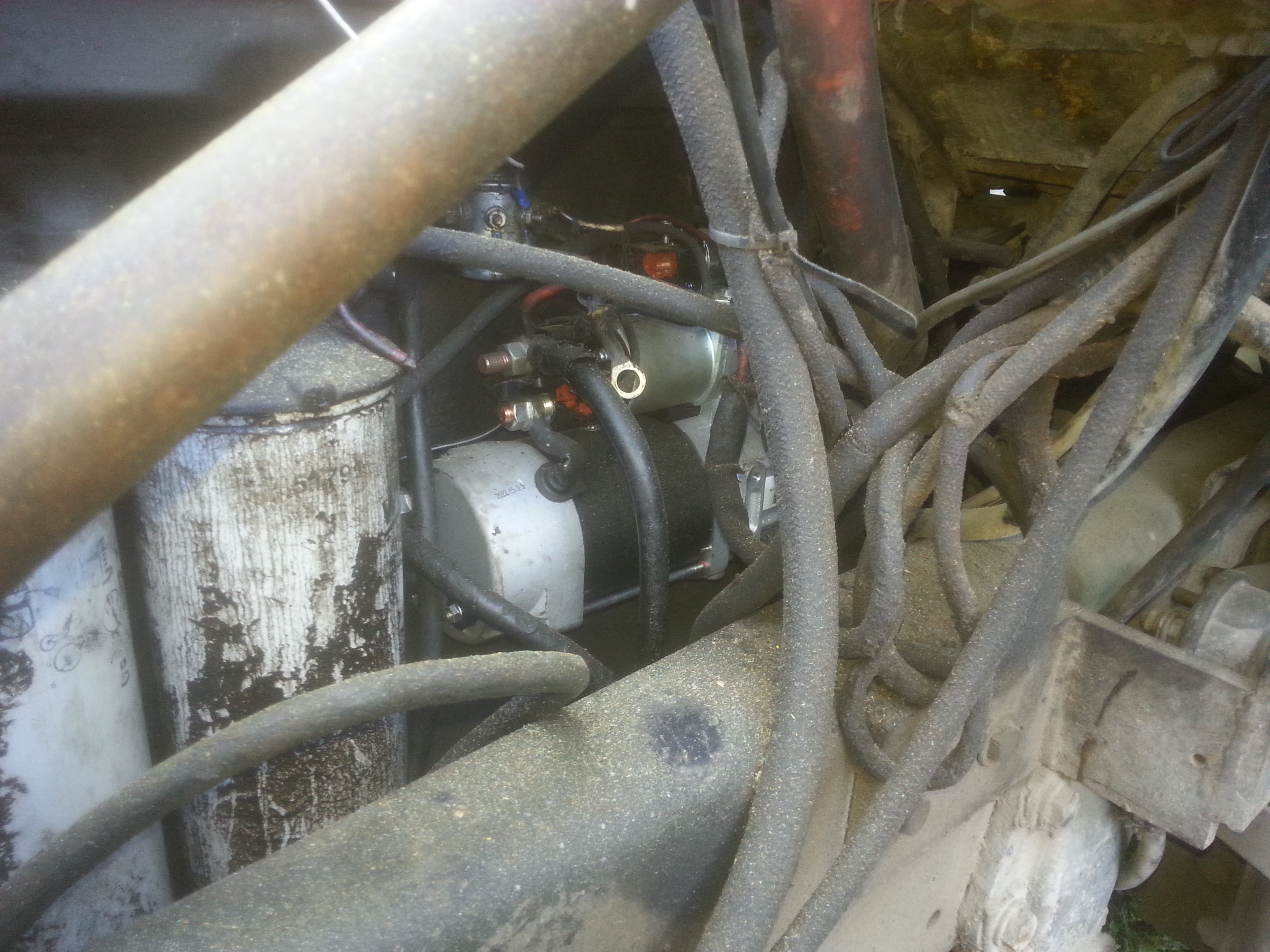

Got the 39MT in.   Will get a pic later today.   Much easier to handle then the 40 or 42MT.  Probably still have to remove one of the oil filters for install (which I already had out) but so what.   It spins the engine over plenty fast.  The truck has also lost it's prime, so had to do some long cranking and it did just fine.
This truck is positive ground so I did bypass the neg ground solenoid that was on the 39mt and wired the trigger wire to an existing solenoid already on the truck for the old starter.
